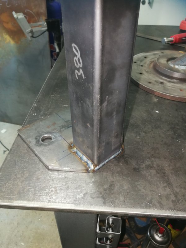

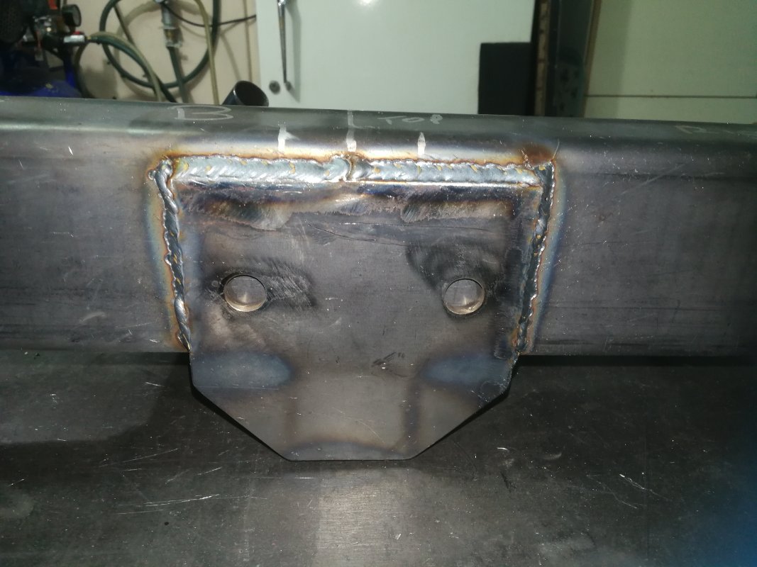

On welds like in the 2 photos above I'm moving the welding nozzle in small circles or "C" shapes to get the coverage. That is what you have to try practicing.

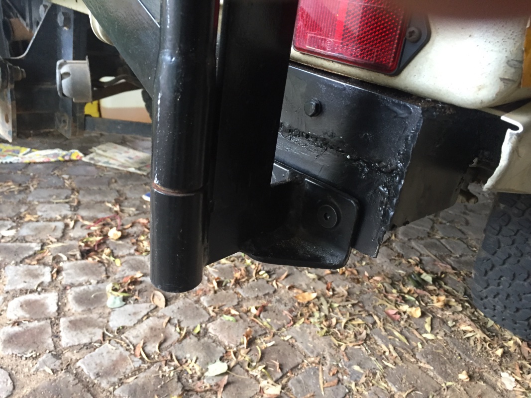

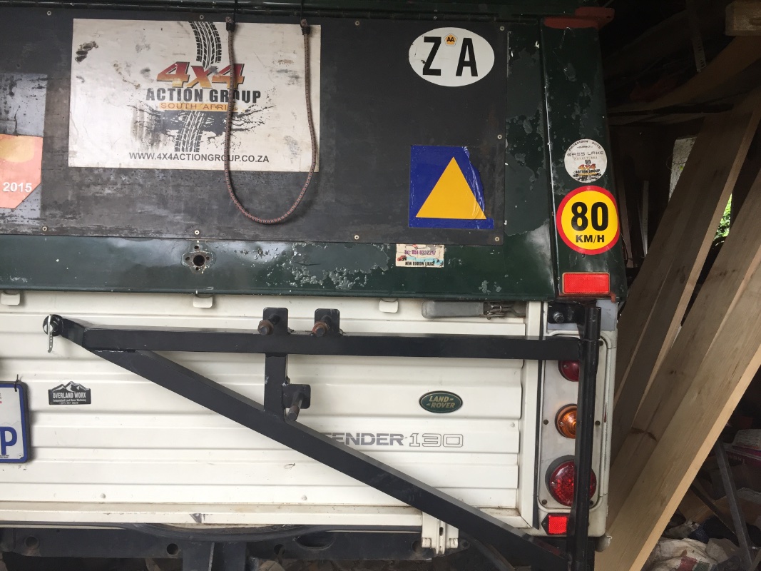

... slow improvement but a long way
from seam welding ... once weather gets clear will get Shaun and Paul give me a lesson!
... but Ive made a bottom bracket box to anchor lower end of my defender swing arm ,
... strong & functional but needed a thick coat of paint !
Swing Arm is firm and works A1 but Im
chancing my luck at the roadblocks as
its 'axle' runs in front of my indicators !

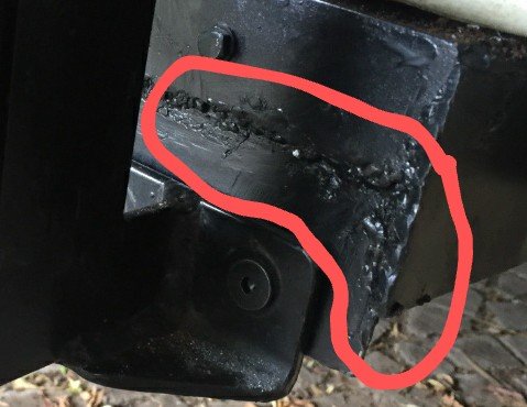

... cant fail Paul ... !!!Paul#25 wrote: ↑Mon Feb 08, 2021 5:58 pmB34B199D-6110-4AF9-88AD-8B2D5EB3BA1F.jpeg~2.jpg
Chas, I really hope you aren't going to drive anywhere with that attached to the back of your Landy. The weld, if it can be called a weld, that I circled in red isn't structurally sound. The little blobs that are holding it in place at the moment are going to fail very quickly. Some poor sole driving behind you when it fails is going to be extremely unhappy carrying your spare wheel on his bonnet and half through his windscreen.
Please think carefully about the structural integrity of any welding you undertake. When your modification fails will it cause injury or worse, or just give your mates a good laugh. If you are in front of me on the road with that welding on the mount, I'll pull over and have a coffee before continuing on while keeping a good lookout for spares I can pick up and sell back to you.
... its done out of 3mm plate and angle iron
and welded on every join ...
... front and back and sides ...
and every plate/ face has a 5mm HT bolt
through it ... ( can see 1 in photo )
The top and bottom of the swingarm
itself are pinned by 8mm HT bolts
and the point by the standard 8mm
linkage.
... would all hold , even without welding.
... but I agree ,
... its not a work of art

Chas, anything can fail.....BushWacker wrote: ↑Mon Feb 08, 2021 6:23 pm... cant fail Paul ... !!!Paul#25 wrote: ↑Mon Feb 08, 2021 5:58 pmB34B199D-6110-4AF9-88AD-8B2D5EB3BA1F.jpeg~2.jpg
Please think carefully about the structural integrity of any welding you undertake. When your modification fails will it cause injury or worse, or just give your mates a good laugh. If you are in front of me on the road with that welding on the mount, I'll pull over and have a coffee before continuing on while keeping a good lookout for spares I can pick up and sell back to you.![]()
... would hold , even without welding.
... but I agree ,
... its not a work of art![]()
3mm plate is actually very thin for that application and what I circled in red in my previous post can't be classified as a weld. If you take that joint and cut through the length of it, you will see that those blobs you call the weld actually have little to no penetration into the base material. 5mm bolts are for panels not structural attachment.
Go have a look at what the commercially available stuff is built from.
You obviously have everything under control so I'll just ignore this thread from now on. My and others advise isn't needed.
