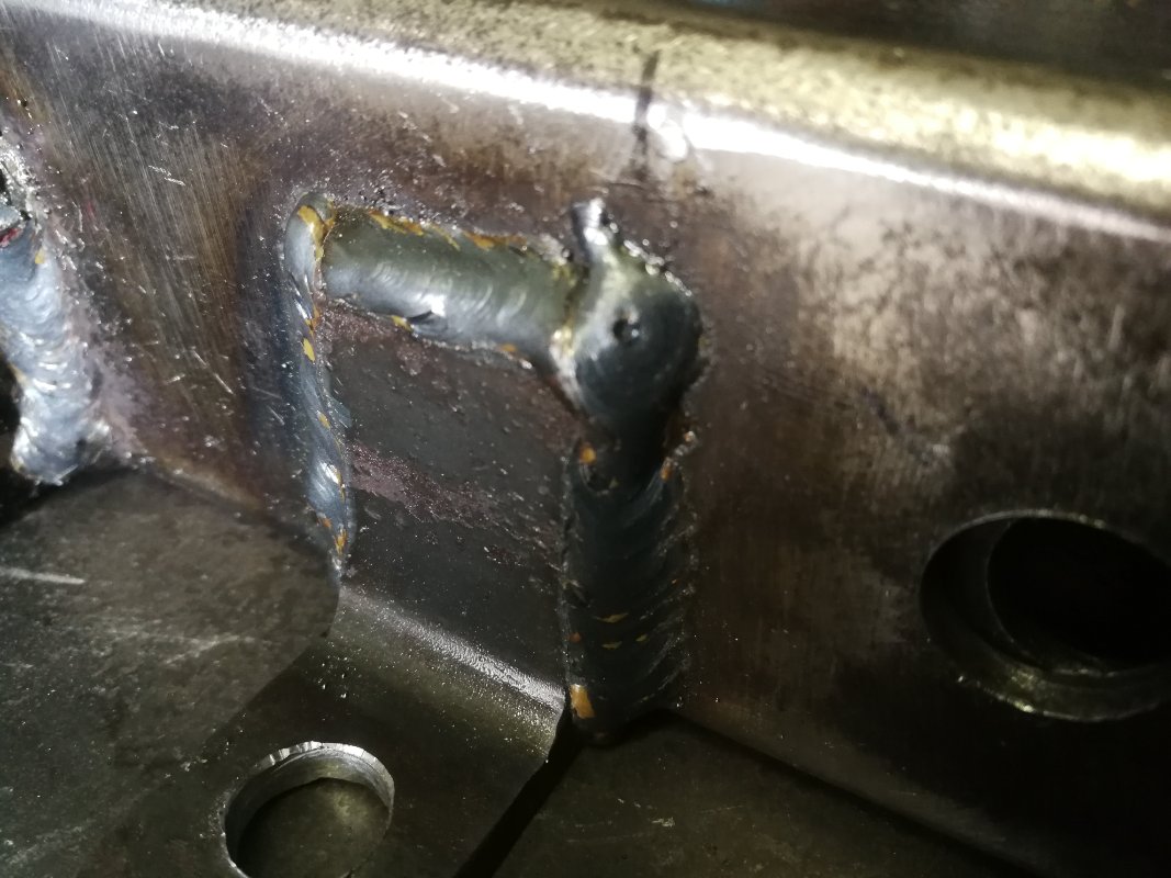

Here is one of the welds I've done this morning.
That weld looks good Paul.
... yes ... that looks like steady

Ricoffy, I'm actually cheating with the MIG welder. Those are on 5mm thick tube and angle so the Amp's are high for good penetration.

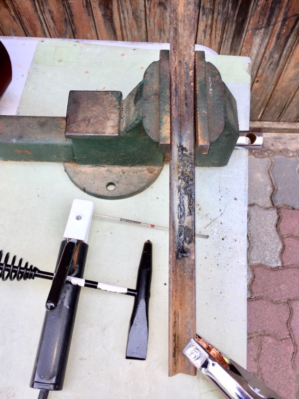

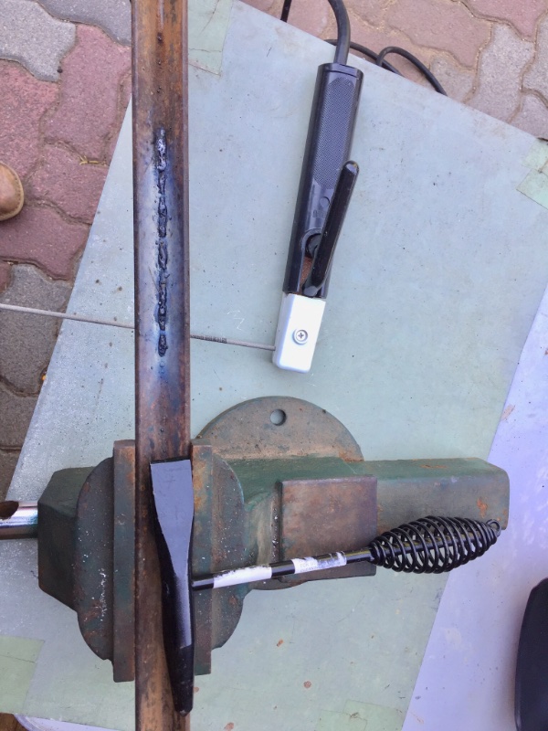

... my first chicken run ,
sort of Ferrous Diarrhea ...
... then tried to do a run on the flat
of the angle iron but cant see well enough
to start ... scratching away with intermittant sparks ...
... but 'Thats All Folks !' ...
Well done old timer
Chaz you need to grind that rust away on the angle iron.
Welding is great but not that magic
Posts: 1545
Chas as Henri said, clean the rust and scale off the metal before you try to weld. It will make a huge difference in your weld and makes it easier to strike the arc.
When you say you can't see to strike an arc, is that because the helmet is too dark or are your glasses a problem. Multi-focal glasses are often a problem because the part of the lens you need to be looking through for a close distance is at the bottom of the lens. When you look through that part, you are looking into the welding helmet. You must be able to see the molten puddle of the weld as you move the rod along.
Try steadying the end of the welding rod with your "free" hand while wearing your new thick welding gloves.
