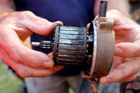

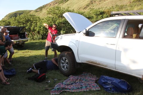

My second trip to 3 Provinces my Fortuner's starter packed up by the camp side. We tried to repair it but no luck. Being an auto, what can you do. Got hold of the SIL and the new day at 5pm he had the new starter there. Installed by 7 and the next day played again.

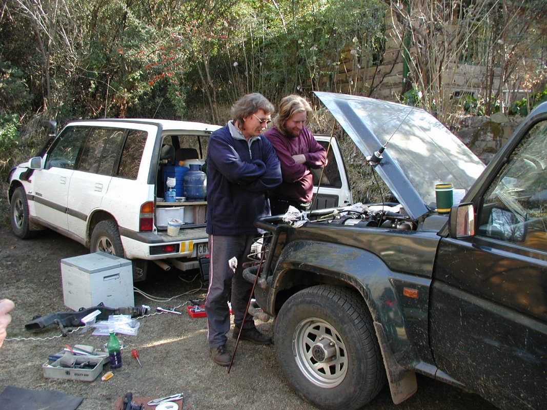

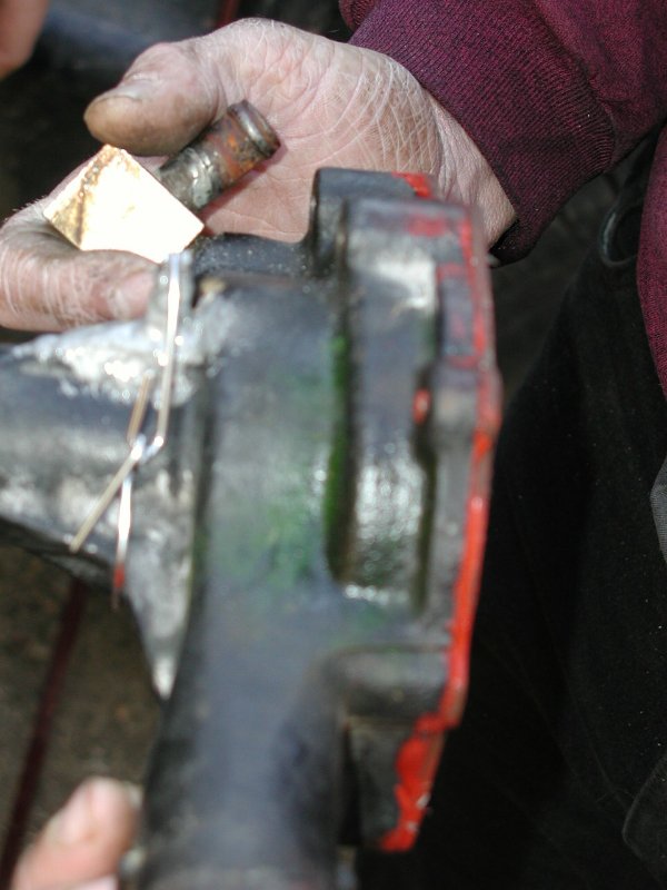

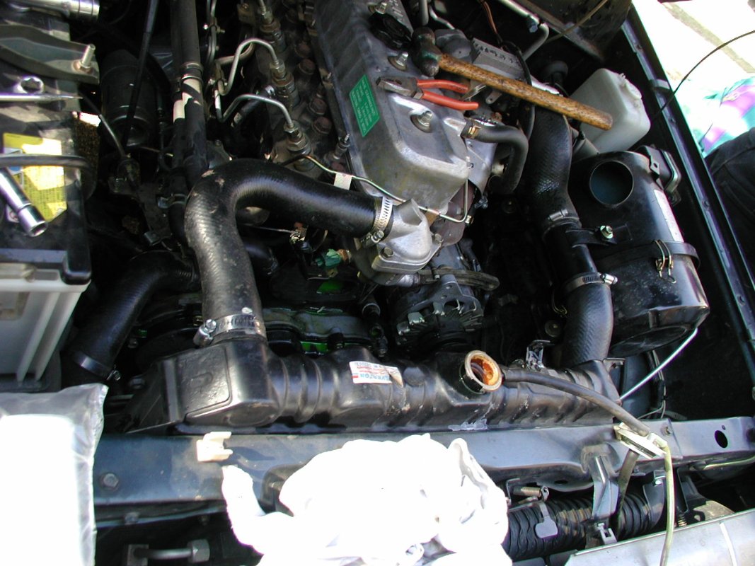

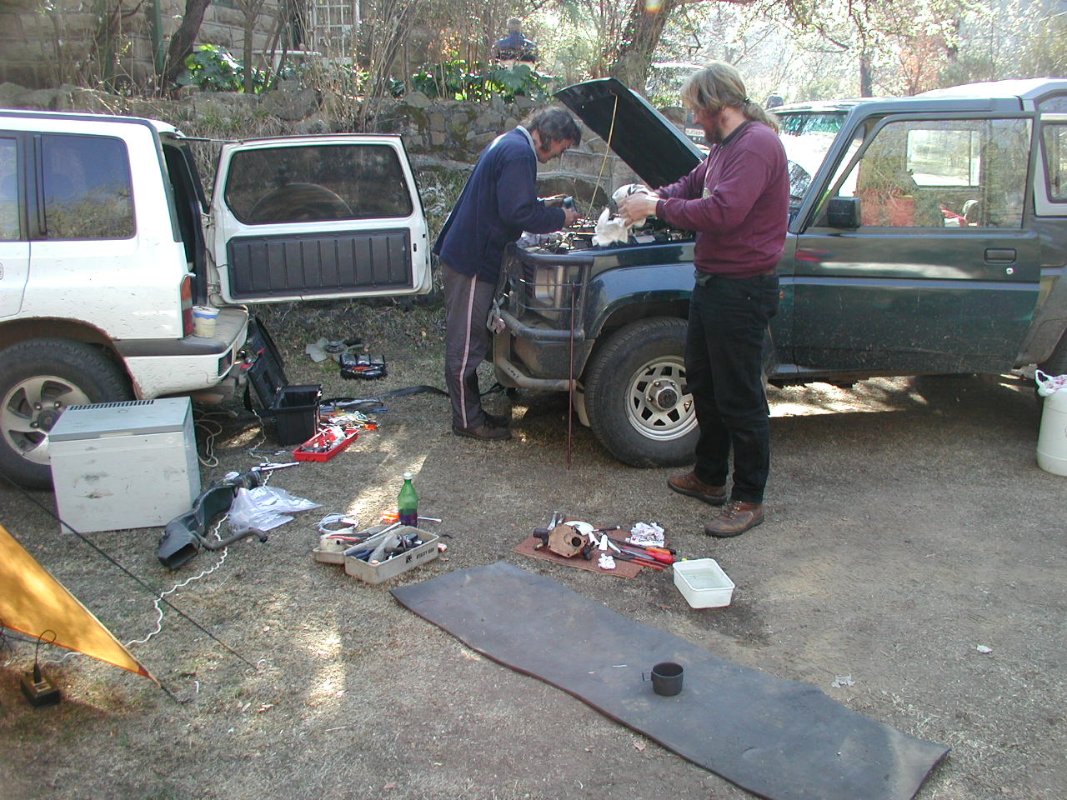

We went Ice climbing in Lesotho in 2002.
After a very snowy and frozen few days the Rocky decided to start pushing water out of the weep hole on the water pump.
As we were on the homeward leg we decided to make a temp repair in Fouriesburg and head for home.
The repair held up for about 4 months while a new water pump was imported as the dealers had not stock....
