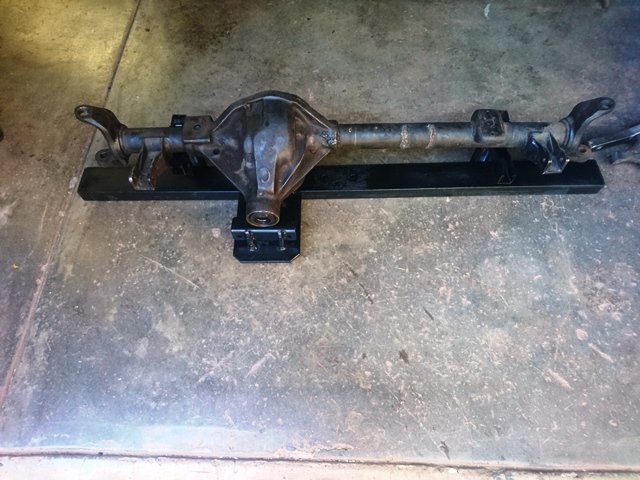

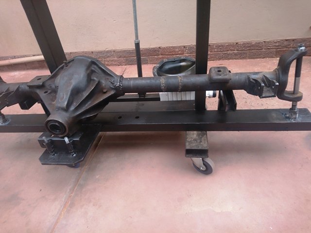

Het dit so twee of drie jaar terug op G60 Patrol gedoen. Caster angle 100% dieselfde gehou. Hy ry lekker en sleep maklik op A frame. Traction bars voor en agter opgesit om axle wrap te voorkom.

Grips... The caster correction was that done while welding on the spring perches or did you use correction shims?

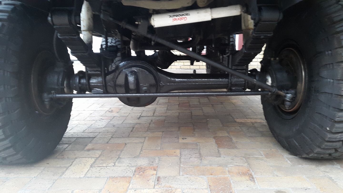

I am still spring under but need to correct the caster angle after the suspension lift.
Been looking for a local supplier of caster shims but no one locally knows what I am talking about.
Wooky wrote: Been looking for a local supplier of caster shims but no one locally knows what I am talking about.
Maniac 4x4 made mine. Basically wedges under the axle mounts that rotate the axle upwards.
While welding the perches.
Build a jig where you can pre-set diff caster and camber before installation.
