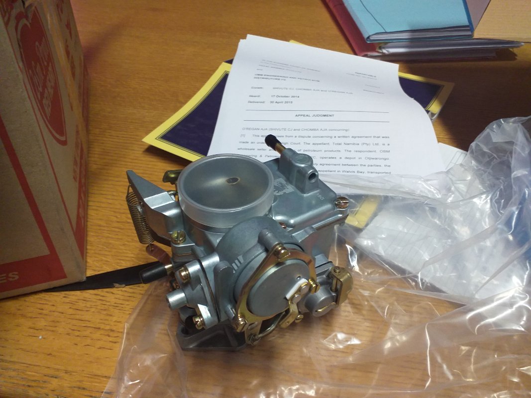

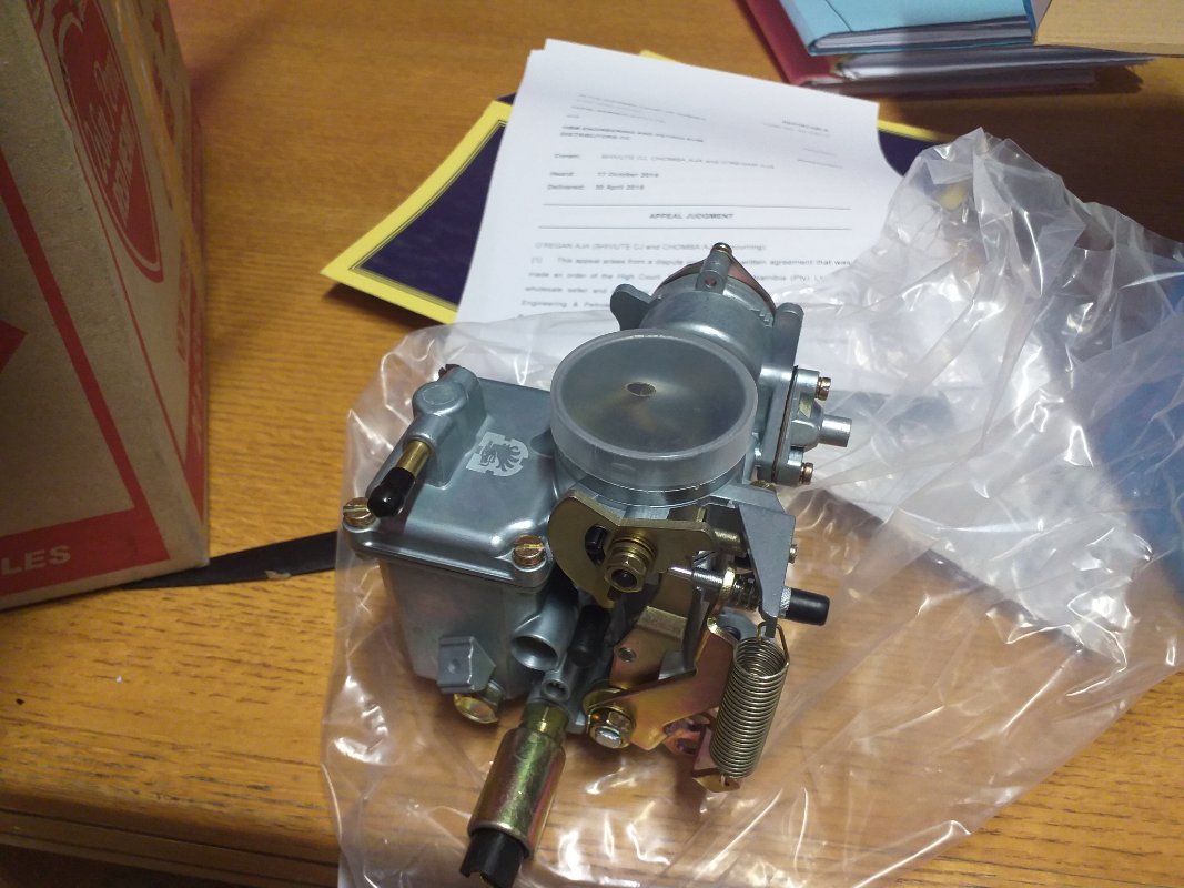

My service parts came.... and this beaut:
#192

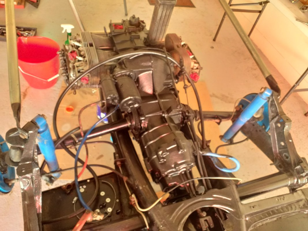

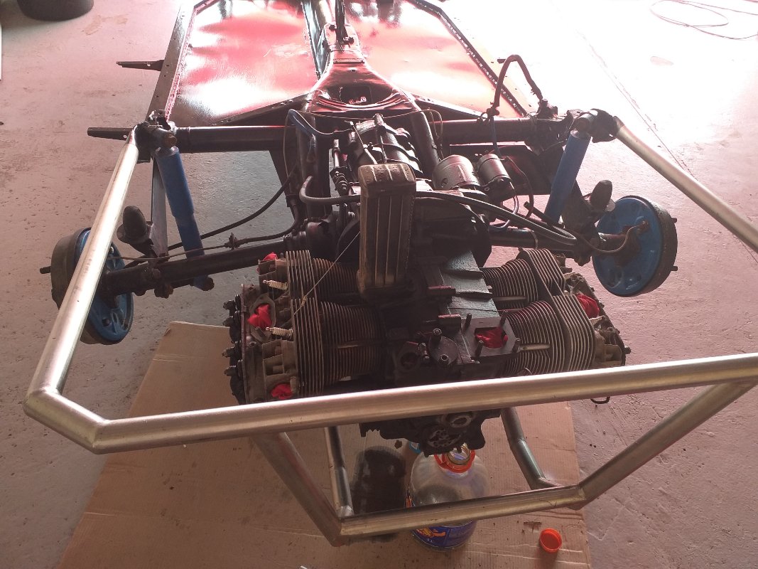

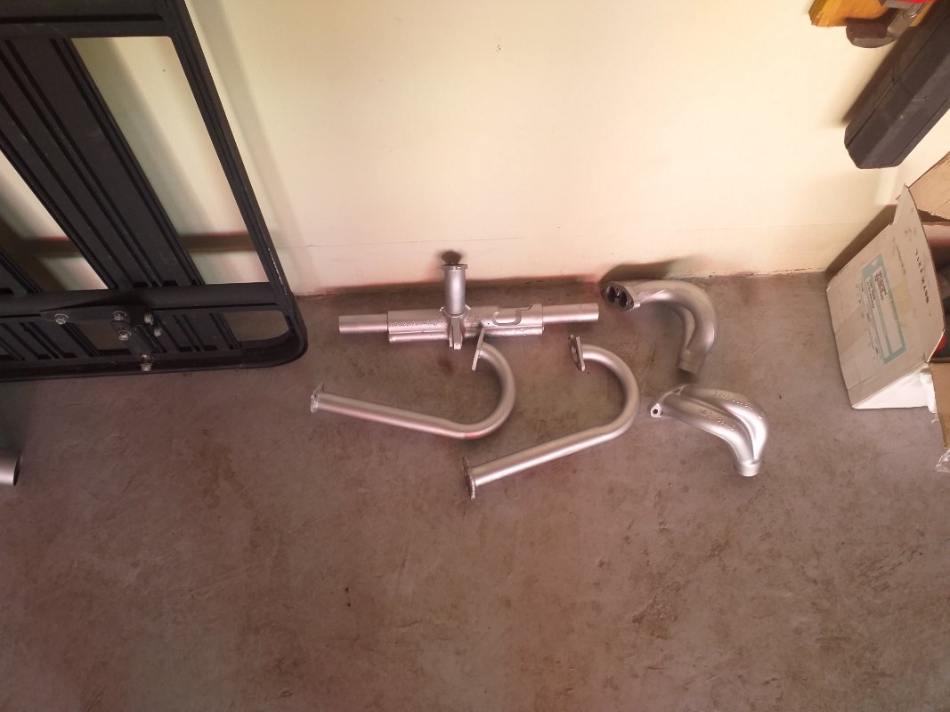

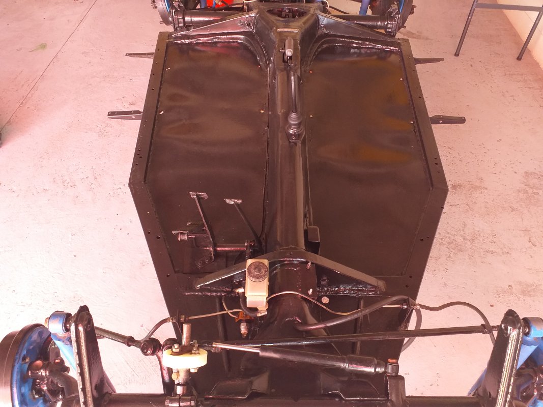

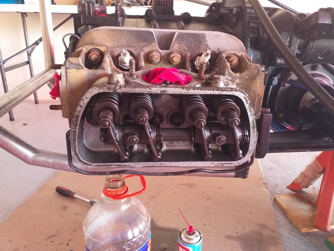

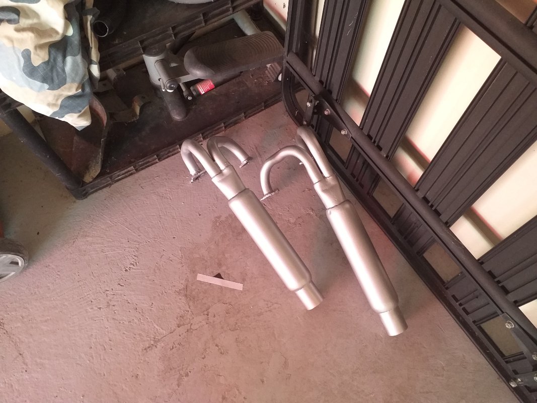

Some progress:
Took of the tins, dizzy, valve covers, carb, air intake, exhaust and fan shroud. Started painting and adjusting where necessary.
Frame and floorpan are painted.
Gearbox painted.
Intake and exhaust painted.
henris

#193
Post by henris »
Maak net 200% seker jy seel daardie pushrod tubes.
Looking good.

henris wrote:
Sun Aug 18, 2019 6:16 pm
Looking good.
Ek het vir my 'n stel bestel - die oues is al gaar.
Dankie vir die advies.
