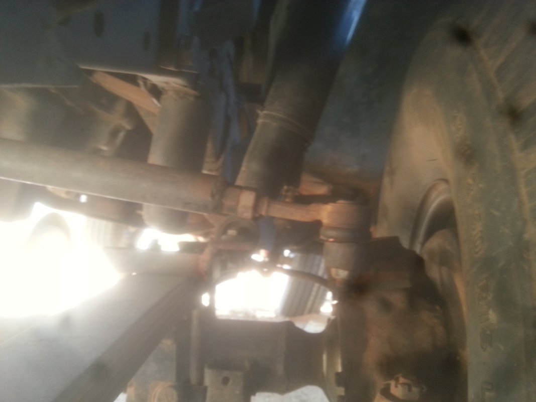

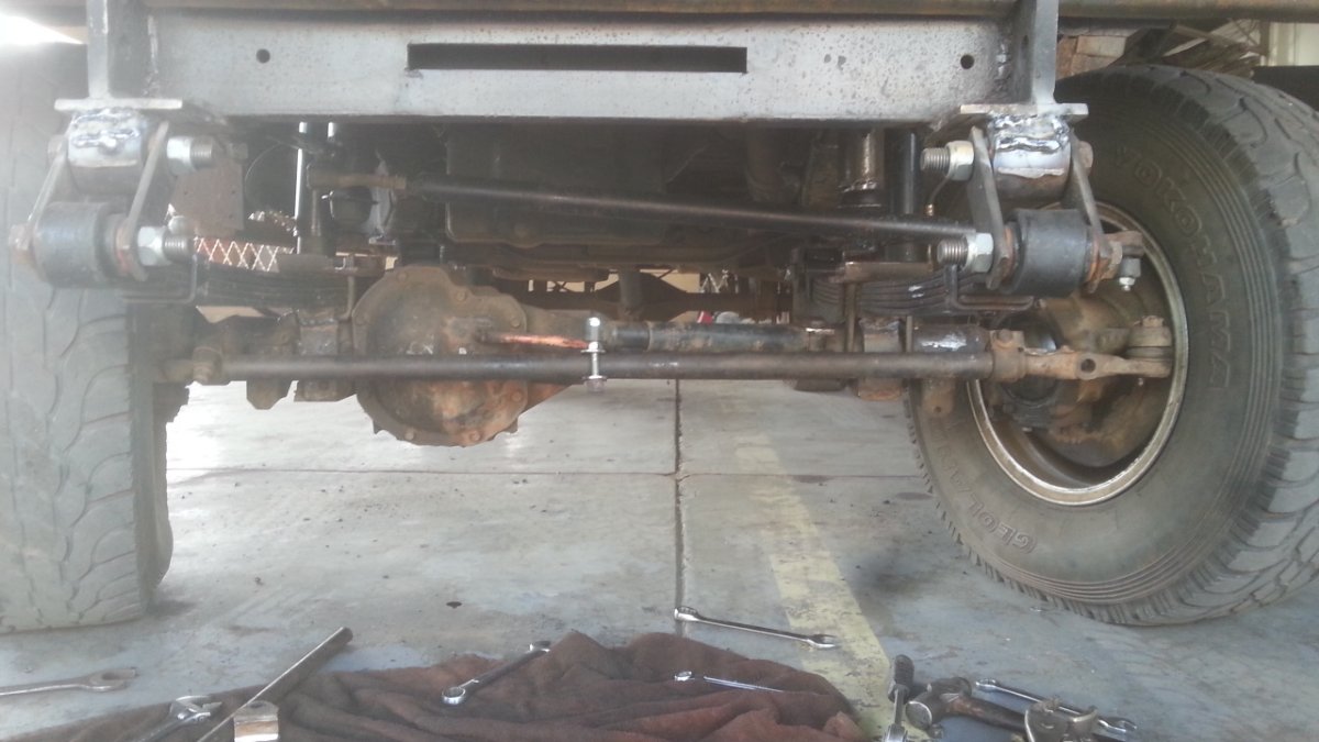

Here is my story, and why I need some advise/pointers. I cut out the Nissan D21 Hardbody IFS and was advised leaf springs are a quick and easy SFA. Not taking into account leag pack and axle position relative to things like an engine sump, it probably would have been.
Here is what I found.... the placement of the springs on the axle forced me to running directly under my chassis members. Along with the sump, this got me a 150mm lift. No way I can get the leafs closer to the chassis. In fact, in an attempt to keep it lower profile, I ended up with very short shackles. This does not work well, and I would have had to extend the chassis another 50mm to get a good angle on the shackle, or gone shorter on the leaf pack.
I guess the big problem with leafs I found, was the limited adjustability if you find things aren't working out exactly as you expected. One of my niggles has been my castor angle and the inability to change that without some major cutting, grinding and welding.
Anyhow, you get the picture of my frustration with my leafs compared to the adjustability I believe I would have with something like a 3 link on coils.

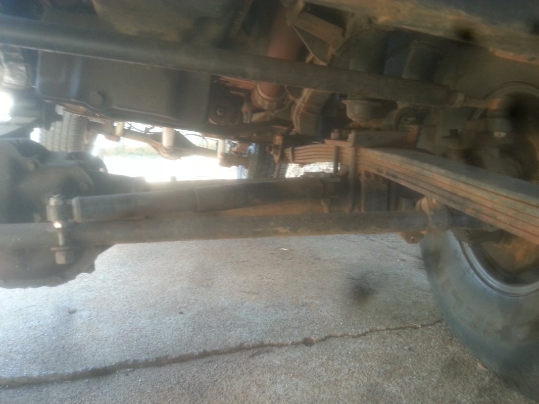

I am no expert on leaf springs by any means but have figured out that they might well look simple and old fashioned but there is a lot of art going into understanding how they work. And getting them to work well might actually be more difficult than going with a linked suspension.
What springs are you using currently?
How arched are the spring packs?
It sounds like the extra long leaves combined with the short shackle could really be doing you a disservice and that alone would make for a hard ride and lack of articulation.
How far are the spring perches inboard from the ends of the axle?
150mm is a lot of lift!!
Post some pics of your setup as it is now and lets see if the combined forum knowledge base can help....

Budget pushed me to use what I had. That happened to be a spare set of 1 tonner hardbody rear leafs. I planned the spring mounts on the front chassis extension I built out past the end of the chassis member as everybody was telling me it's best to have the shackle on the rear of the spring. That quickly went pear shape, as I had to drop 120mm to get the spring to sit horizontal. Believe me, I tried it with the spring at an angle between perch and the space I needed to fit a shackle in on the rear, and I had had an harmonic bump steer develop into a slow and increasing death wobble at anything over 40km/h. Back out with the grinder and swop the mount and shackle ends. Next problem was the off center locating pin on the leaf spring. This pushed my axle 60mm forward, and I was running into problems that the spring pack was inverting under the weight of the Sani.
Comedy of errors saw me with a military wrap and additional blade that was done incorrectly and I based everything on that. Ended up with very sharp angle shackle and spring pack that lays dead straight with blades trying to separate. Here some pics with the best articulation I can get out of my setup as it is.
Result seems to be the springs are binding on the military wrap and causes enough tension on the spring to make it bend to the sides if there happens to be any sideways pressure due to uneven road surfaces. My Castor is now at 7.5deg which is not working on this setup. If I go toward full lock, it gets to a point where the wheels get pulled further into lock. They will only straighten out up to a certain point of turning (if that makes sense). I need to pull back the Castor. But I have been holding back on that exercise while I work on a few other things. I basically pulled the car off the road last February until I can get a few other things sorted. Finances has made this a very slow process. I am hardly even looking at the suspension till I have a few other things sorted. Busy right now building new crossmembers and a carrier for the second transfer case. Reenen on the forum has given me some info as to the location of the oil pickup in the sump. If this pans out, I want to cut the sump above the front diff, which will give me space to do a suspension drop of around 50-80mm I think. If that is the case, I need to do the entire suspension over again. And leafs just don't fit under the car. A SUA would help, but drops it too much, and would require a whole new set of spring mounts anyhow.
