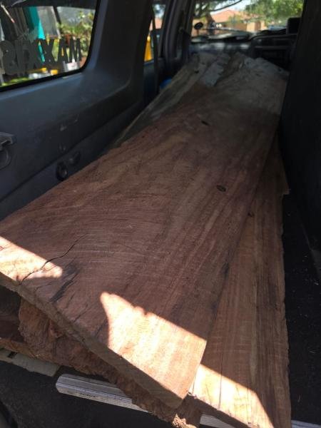

So a week or two ago, I drove the truck to the sleeper place in Centurion and loaded up 5 x 25mm thick sleeper planks...
The issue with sleeper planks (I learnt this during my barn door building phase) is that they are never square. And you will never get them square on a table saw. So this time I acquired a rotary saw and started off by cutting them nice and square on one side. After that, it is relatively easy. Despite the fact that the wood is uber hard, it cuts really nicely...

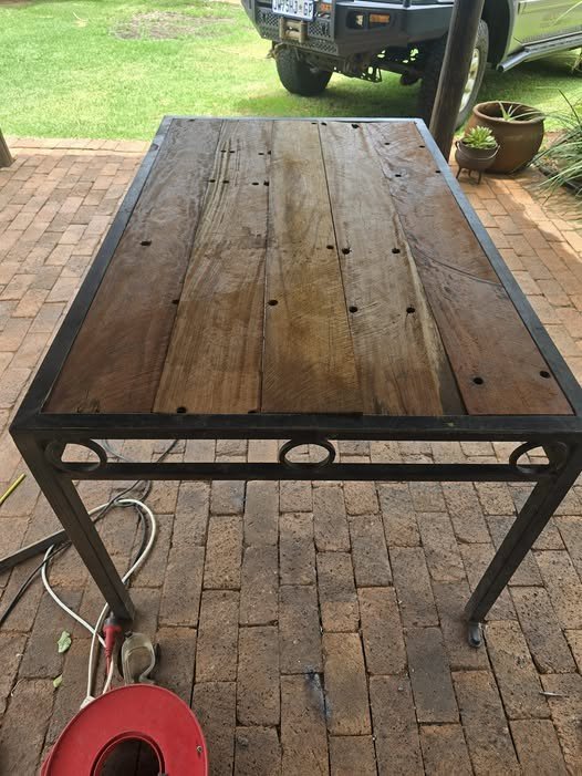

Anyways, on Sunday, I had the bits nicely squared and all cut....
Obviously, there is a big difference in thickness between a sleeper plank (25mm) and a tile (5mm), so I had to cut the supports out of the frame and weld in new ones. But that was easy...

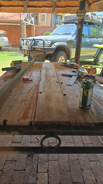

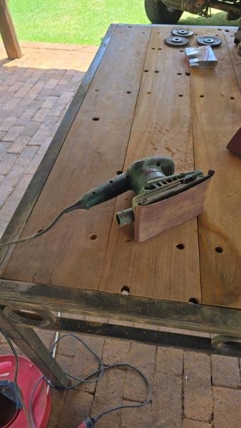

I left about 0.7 mm sticking out above the steel frame so that I could cut it down flush with the frame. This is in process, and the only place where working the wood has been difficult. Sanding it down takes forever. But I am almost done. Belt sander for the aggressive sanding (ie: to get it level) and an orbital sander to finish it off. Guess I'll be done with the wood work this afternoon...

Where I do battle every time is always with the sanding down. It is a bugger to sand nicely (the hardness). But after building the door I learnt that a belt sander and 40-grit surfaces it nicely pretty quickly and thereafter you just up the grit number until the finish is smooth. I normally finish it off with an orbital sander with 240 grit.
In fact, I've been doing a tiny bit of sanding after work each day and I'm almost done with the table top. I imagine I'll be able to paint the frame after work tomorrow and oil and refit the planks over the weekend. And then it is done.

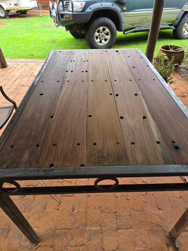

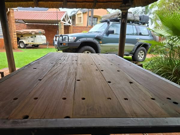

Got the new table top nicely flat and finished off on Saturday morning. I'm happy - it looks good.
I then stripped everything down again to give the frame a few coats of Hammerite smooth black.
It should be dry when I get home from work this afternoon, after which I'll reassemble everything and oil the sleepers. I am looking forward to seeing it all finished... :)
