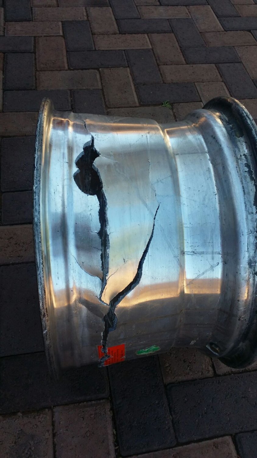

For me steelies all the way. Had a few bad experiences with alloys. Alloys break, steel bend. Easier to moer steel back in shape than find someone that can repair both.
My not so nice experience. Almost impossible for a hub to punch through a steel rim.
Steel all the way. Cheap to buy, cheap to fix. But some do bend easier than others.

we should consider the pro's and cons of OE Mags , against aftermarket mags, OE mags is much stronger than aftermarket mags, my choice against steel rims.

Martin de Jager wrote:we should consider the pro's and cons of OE Mags , against aftermarket mags, OE mags is much stronger than aftermarket mags, my choice against steel rims.
OE steel rims the best[emoji12]
What a life?!?😜
My OE alloy rims usually get sold off. OE steel are also lekker but I got rid of those as well in favour of aftermarket ones. The reason being that not all steel rims are suitable to convert to Beadlock wheels. Alloys don’t work at all for beadlocks.
