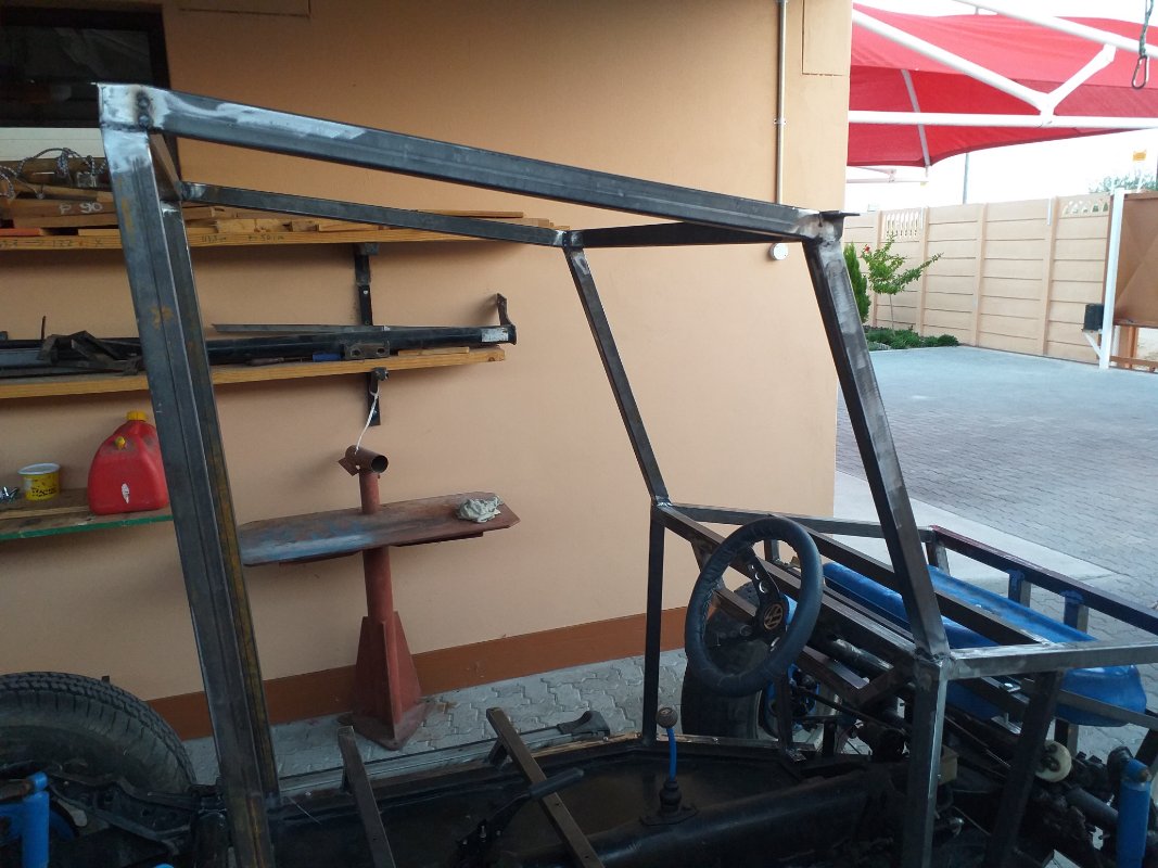

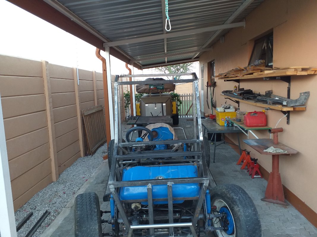

Starting to take shape.
Wife says it looks like a rat rod.

Looking good! Love seeing people make things!
Another word of advice though - drop a couple of diagonals in there just in case it goes over!
