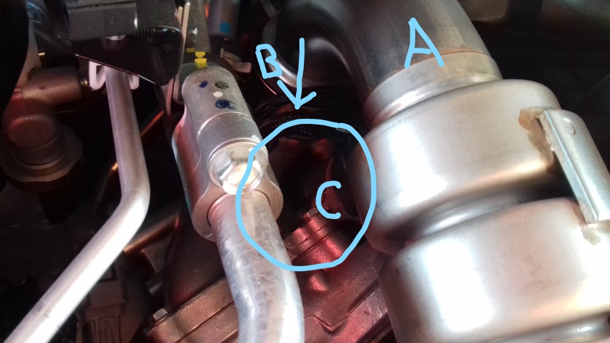

What would you do? Here are some pics of the oil leak:
A= The culprit pipe
B= The joint where it leaked
C= The oil
