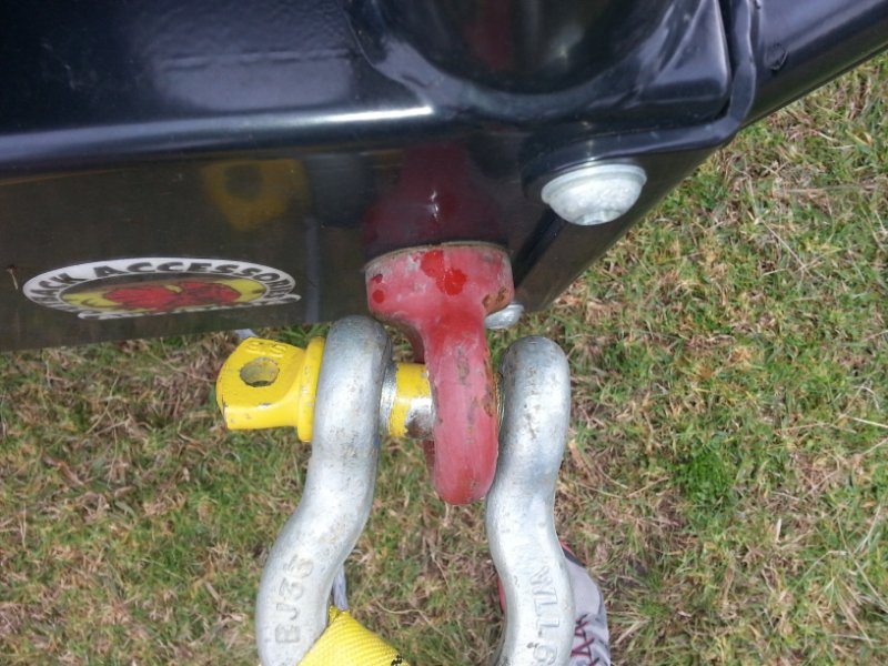

This is a pad eye. The people that lift stuff like containers etc. have these where they connect the slings to, with a shackle. Take note of the 'cheeks' around the hole. It makes the pad eye thicker so that the shackle fits perfectly.

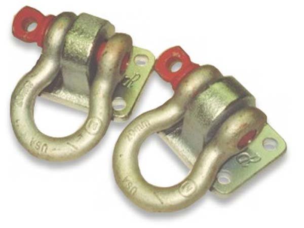

We call the pad eye recovery points. That is where we connect our shackles to. The shackle pin must almost be a perfect fit in the pin hole.

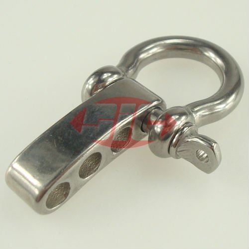

5MM-Adjustable-Stainless-Steel-Bow-D-Shackles-Clasp-4-Holes-Pin-for-Survival-Paracord-Bracelets-Climbing.jpg
Those last 2 aren’t rated shackles Chris....just sayin’ 😀

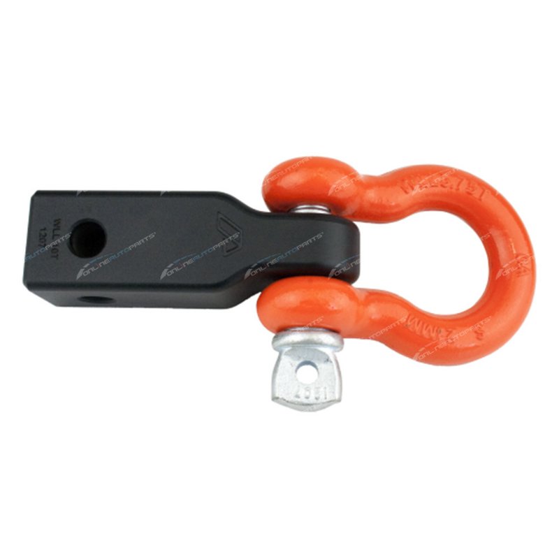

Now, one gets the thing in the photo below - hitch receiver. You slide it into your tow bar where the tow ball is.

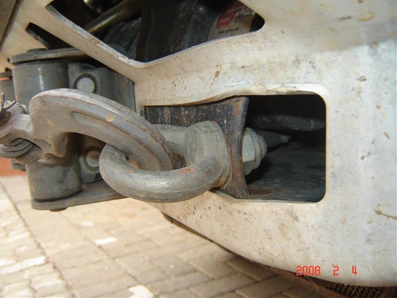

This is not good. Don't use that. It is a no no. One don't snatch from the middle of the tow bar. The recovery points should be as close as possible to a strong part of the chassis, like bolted to the ladder frame. Or bolted to the aftermarket bumper at the point it attaches to the frame.

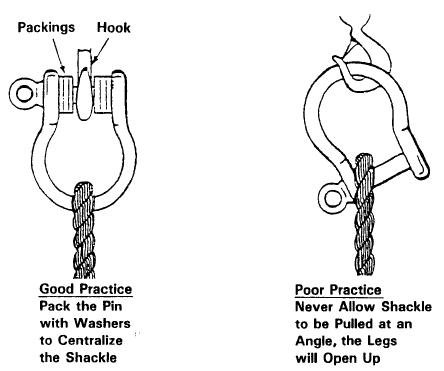

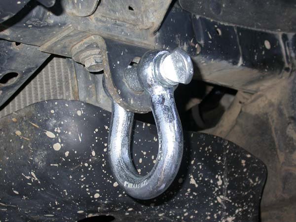

Some common mistakes made we often see with shackles.
Look at the pics and figure it out for yourself :D
Once the shackle pin is bent it is very difficult to unscrew from the shackle body.
shackle bolt.jpg (10.86 KiB) Viewed 5630 times

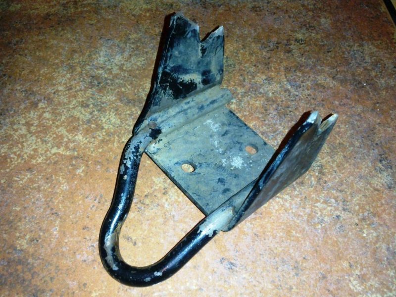

Now I want to talk about these 'Recovery points' you find under vehicles. It is there when you buy them. These are not recovery points. These are strap down eyes and towing points. They tie the vehicle to the flatbed with these tie down points.
( I don't want to see any comments about Hiluxes and Land Rovers on flatbeds. You guys got it? :x )

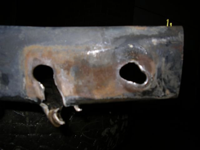

There are holes all over the place on the chassis. Don't just bolt something to these holes. It might not be thick and strong enough to have a recovery point fitted to it. There is a nice pic that demonstrate this.
