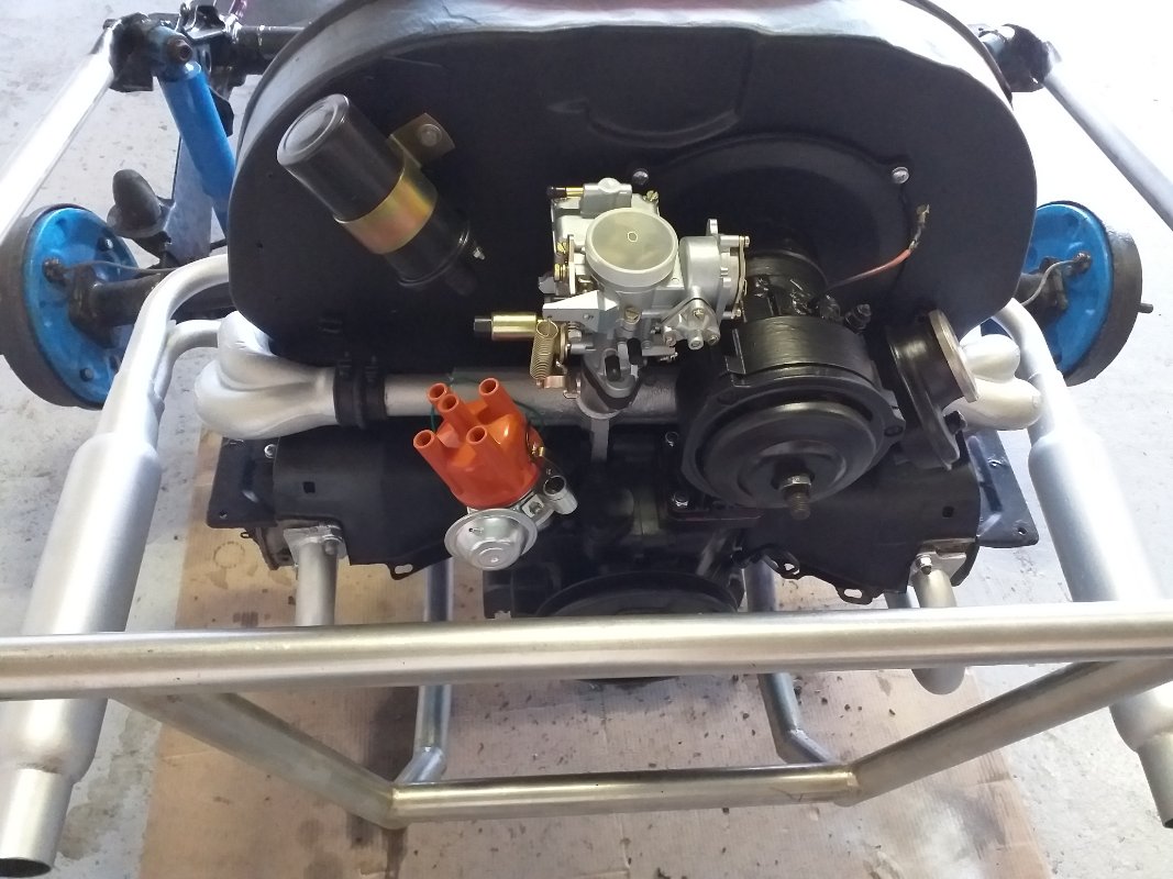

Took of the cylinder heads, cleaned the heads and valves, replaced the push rod tubes, adjusted the valve clearance.
Painted the shroud, lubed the fan bearings, replaced the belt, distributor and fitted the new carburetor.
New spark plugs, adjusted the timing.
Still not idling as it should, but I will tweak the carb to get it right.

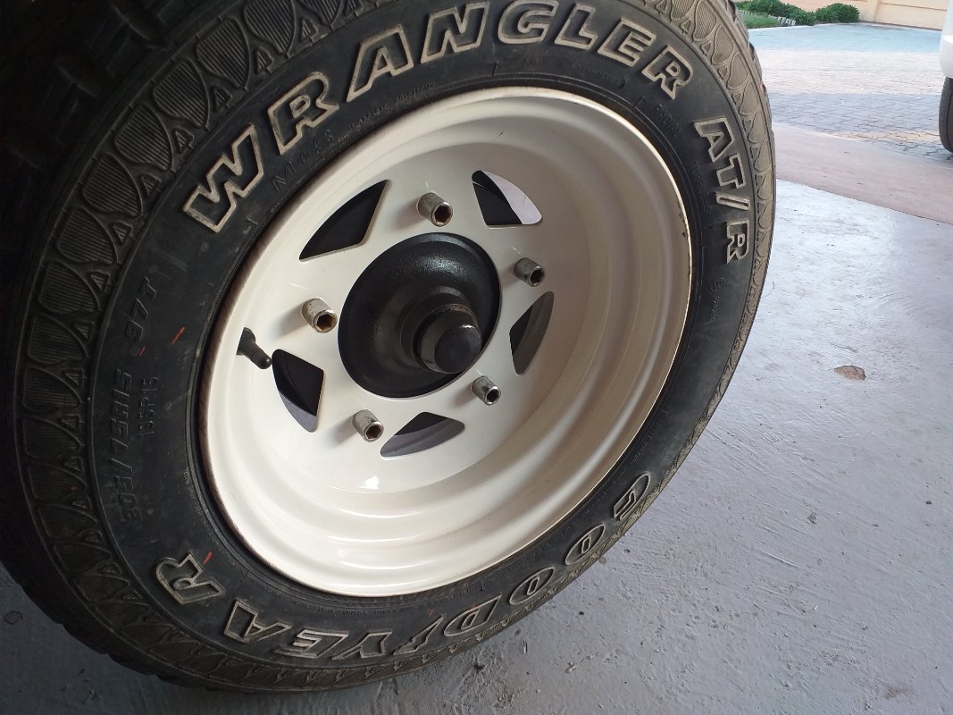

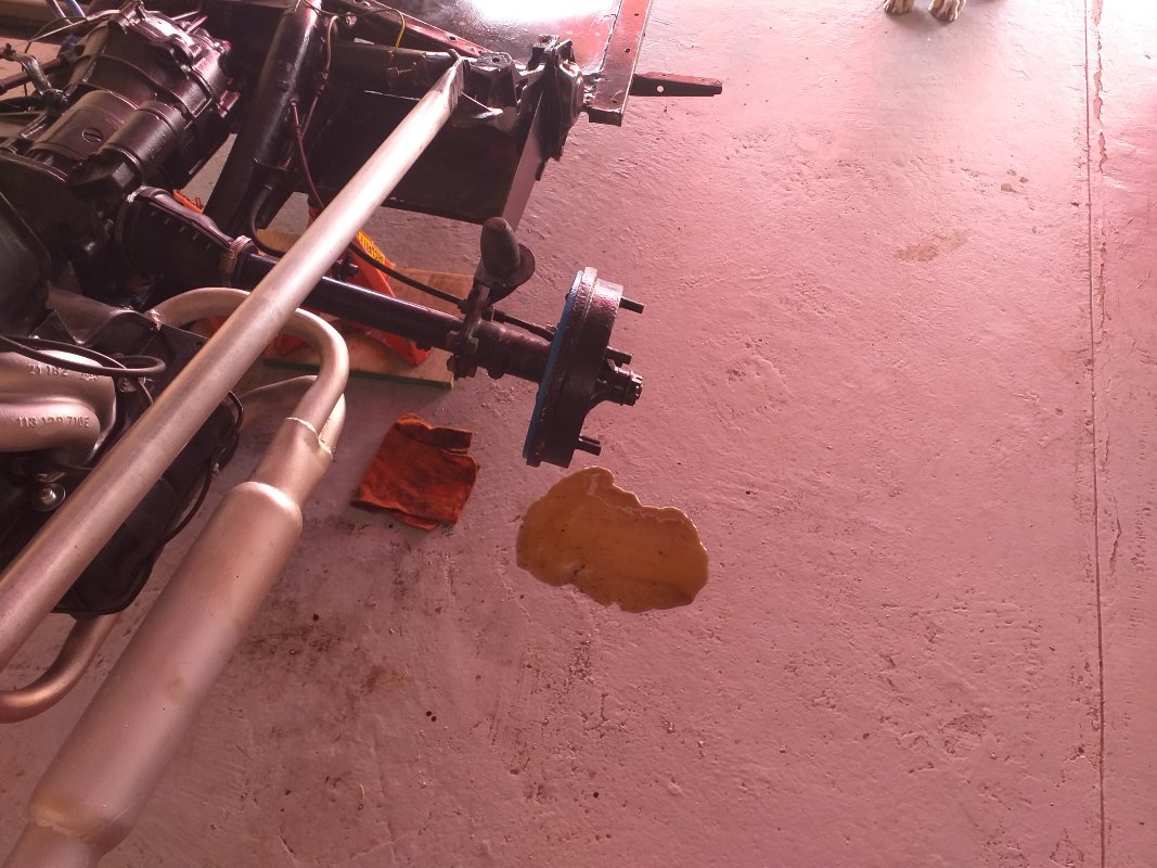

After replacing the brake pads, wheel cylinders, springs, retaining pins and axle boot, I filled the gearbox with oil.
Came back to this:
#204
The rear hub seals were fubar. Only found this out after I filled the gearbox and there was enough oil to reach the rear wheel bearings.
This project is getting expensive now...
#205
Fri Sep 06, 2019 8:45 am
if I had a dollar for eveytime I've heard that.....
just don't tell the missus what it cost 🤣

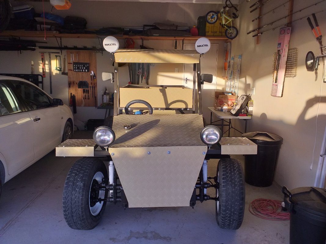

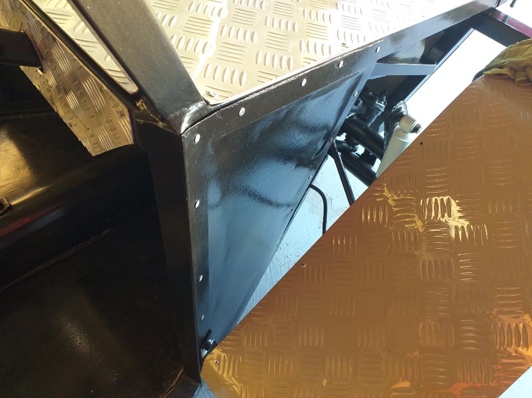

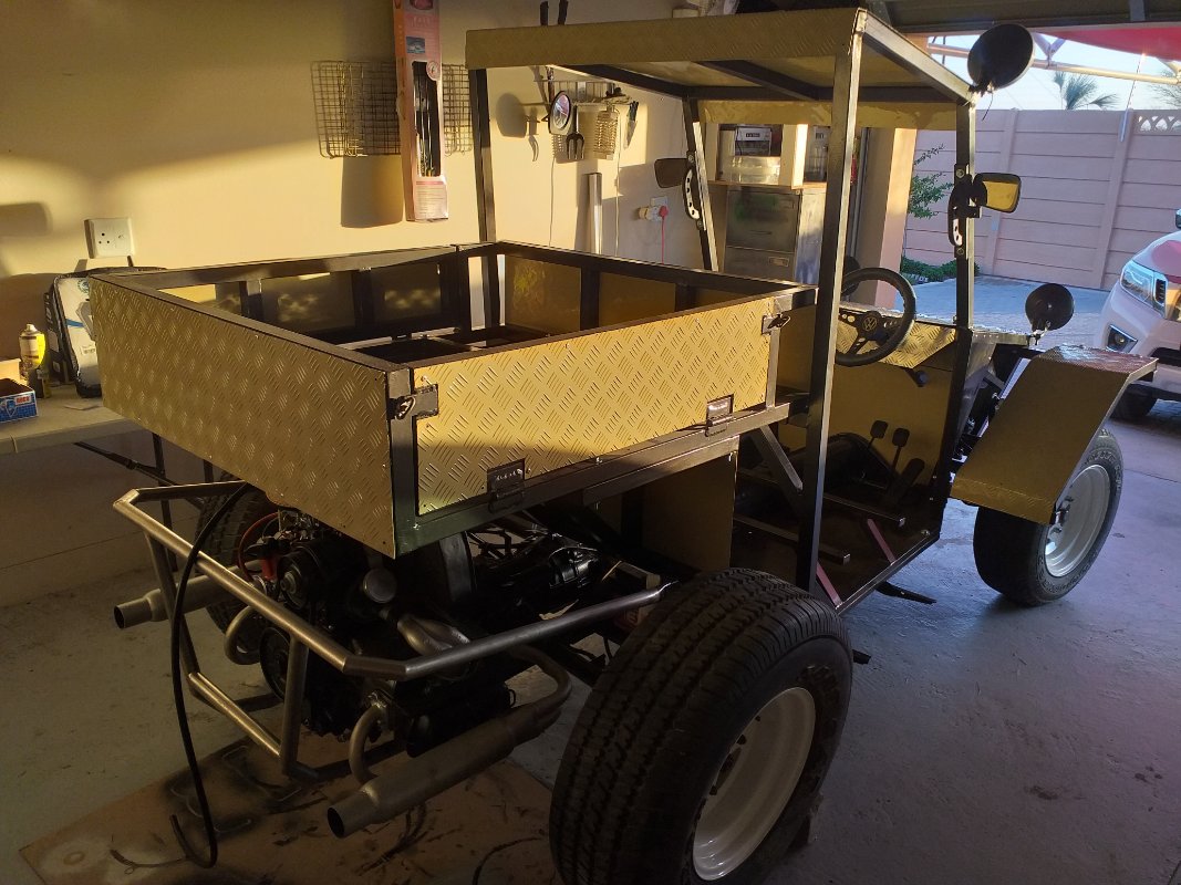

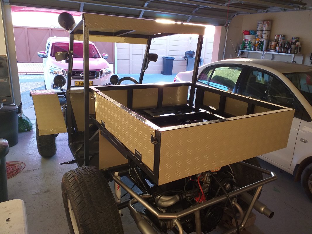

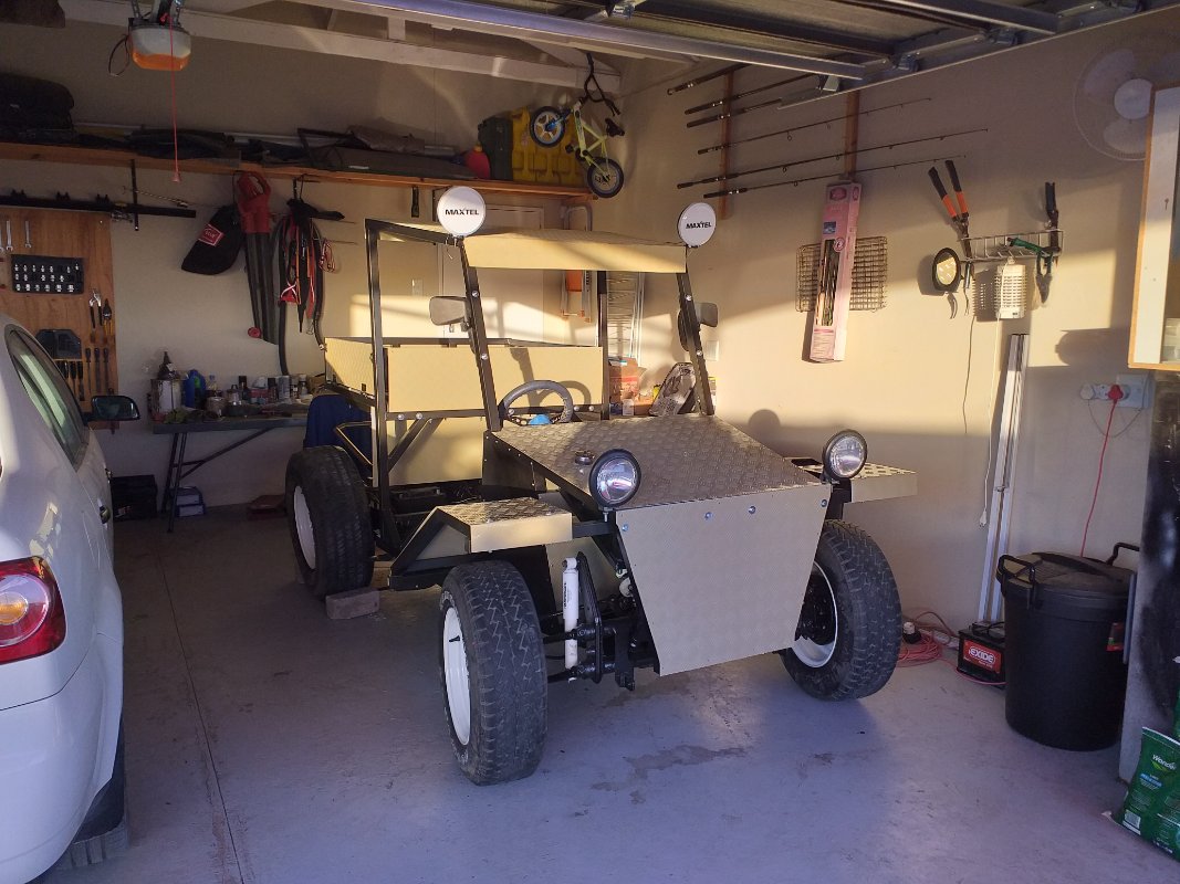

Made some progress:
1) Rims (off-white) and alu panels painted (Land Cruiser Brown :lol: )
2) Re-assembled the frame;
3) Fitted lights
4) Tank in and connected to pump;
5) Steering done;
6) Brakes and cylinders replaced (again)
7) Rear hub seals replaced
8) New shocks fitted.

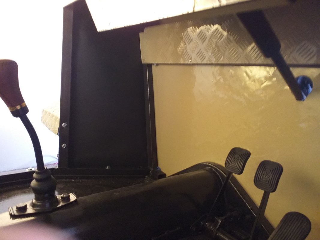

#207
To do list:
1) Re-install seats and side steps;
2) Handbrake adjustment;
3) Bleed the brakes (and adjust if necessary)
4) Wood -loadbin
5) Re-fill gearbox oil;
6) Wiring and dashboard assembly
