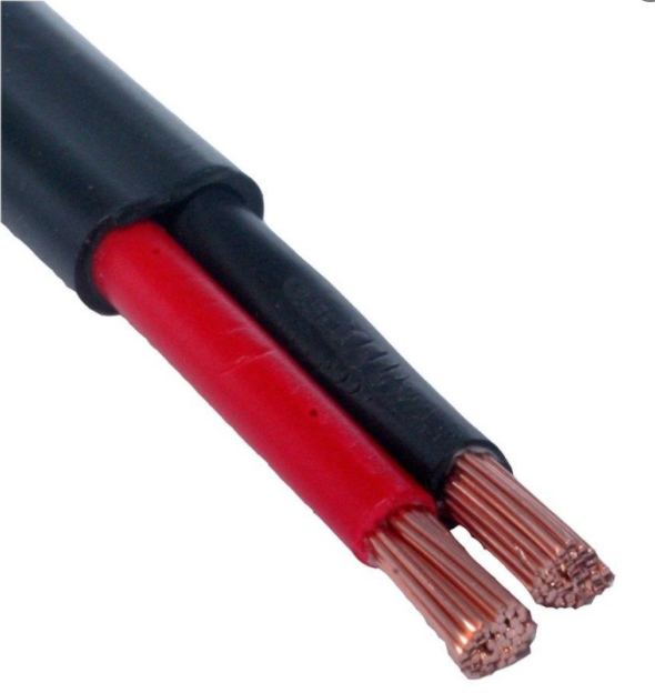

I'm busy upgrading my trailers 12v power, I'm installing a National Luna DC-DC 25amp charger, this also has a solar input, so while I'm busy I would like to run that cable too with the BH connector on the draw bar.
Does anyone know where I can get double insulted cable like in the below pic?

I thought you were selling everything?
Have you tried AC/DC Express?

Probably AC DC or voltex
Posts: 1545
Your best bet will be AC/DC Geoff.
They sell solar rated wiring in the single colour in 10m rolls. That is what I used for my setup but have a section of heat-shrink every 30cm to keep the two wires together.
The trailer is coming with... and its worth double there than it is here, at worst I sell it that side.
Paul#25 wrote:
Mon Aug 23, 2021 11:29 am
Thanks guys, will give them a call

Just a piece of advice. Those strands must be as fine as possible. Else they will fatigue and break.

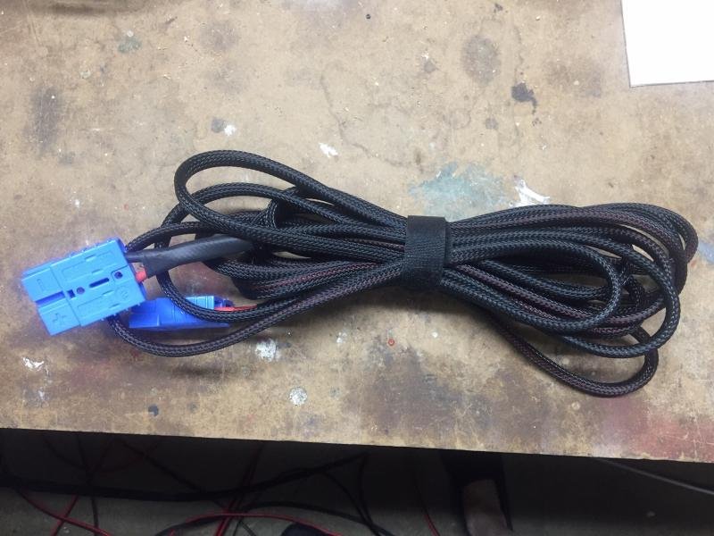

For cable try Citilec in Highlands North.
Its sold as panel wire and has the very fine strands as indicated by Henris above.
I bought 10mm for R18/m and 16mm for R25/m
By way of comparison for 16mm the price at ODW is R79 and 4x4 Direct is R60/m.
They also cut to length. I haven't bought thinner guage from them so I don't know if they'll cut thinner wire.
To keep the wires together I would use braided sleeving
https://www.three-d.co.za/#!items/gp-braided-sleeving

I mean Henris, the recovery guy, from Nigel.
Refer post #6
Woolf wrote:I mean Henris, the recovery guy, from Nigel.
Refer post #6
Oh yes, I edited my post
