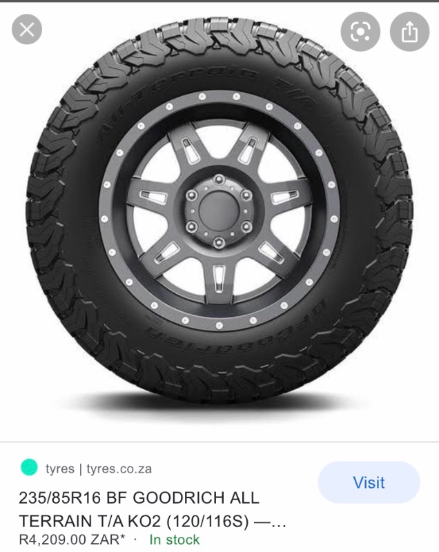

[emoji1312]for once this Porra talks the truth [emoji1781]
... the recent KO2 version of BFG ATs even better
with more tread down down the sidewall ... on my 235/85/16s ... nearly 1/2 way down the sidewall ...
but, must admit, they dont like deflating too much on extensive soft sand travel, river trips, beach etc
Out of the 50000 target mentioned prev how many Kms will be soft sand travel ??????
I feel the temp of tyres with my hand more than
sticking with pressure rules ... but looking to buy some TP sensors etc
