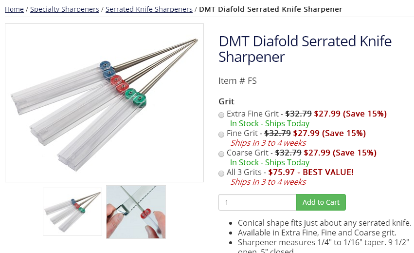

How do you sharpen a knife that has half serrations? Like my CRKT which has a blade similar to the one below?
httpimages.salsify.comimageuploads--iitrt0t5--c_padw_1840h_824fl_clip.png8ajgrmhpjdmyawyfjqous.png

Google serrated blade sharpeners.

Thanks Chris. So sharpen like normal and finish off with a kit like that?

Ice, I have never sharpened a serrated knife. But the serrations should be sharpened separately, each serration on it's own with a round sharpener that fits perfectly. I guess a chainsaw file of the correct diameter will work?

Thanks. Will go look for a kit today. I use my knife alot and the serrations work well with rope and stuff. But they are getting a bit dull now.

Don't fall for a sale's pitch to use a triangular stone on serrations. It destroyes them by taking the points off each one.
