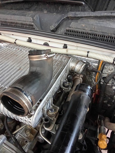

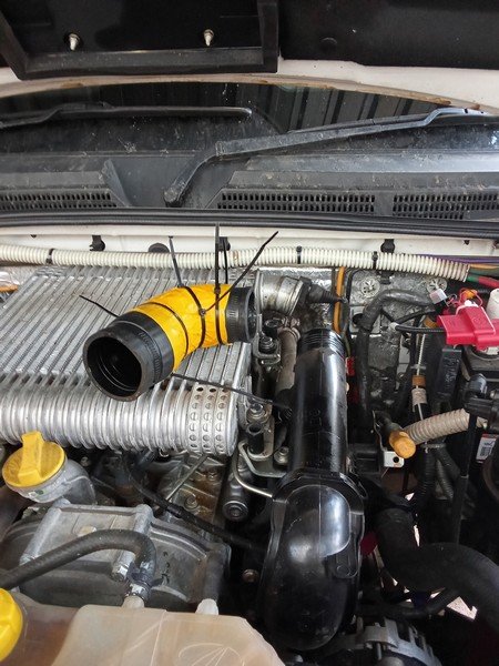

if i look back at it, all started last week Monday morning on my way to work when i felt slight power loss which i dismissed as imagination.
stayed like that until Friday few Km before final destination when shushing noise started which i tough coming from pollen filter or cabin fan.
on open road i did not feel any difference in power but as soon we got off the tar power loss feeling was much greater , sshhh noise louder and black smoke visible.
thanks to duct tape and few cable ties problem was temporarily sorted.
Jadranko
Has thanked: 92 times
Been thanked: 154 times
Posts: 305
Post by Jadranko »
yesterday i was looking for replacement.
independent spares suppliers all said:no stock,1-2 weeks lead time,R650-R750 range.
well known spares suppliers did not even bother but to just say NO ,next in a line please.
on advice to try my luck at GANGR and Best Drive (which are 2km from my work) i went there.
holy (what ever ) ,not only that they have what i need there is a wall 10m long and 2m high full of pipes of all sizes one can think of.
silicone booster pipe 51-57mm cost me R195.
i believe they sell at takealot as well as there was wall of branded boxes waiting for collection.

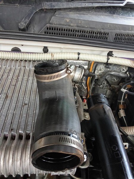

i would never expect for 90 degree pipe to crack like that on inner bend.
pipe is 5 years old but there is no hair crack lines any where no matter how i squish or bend it.
