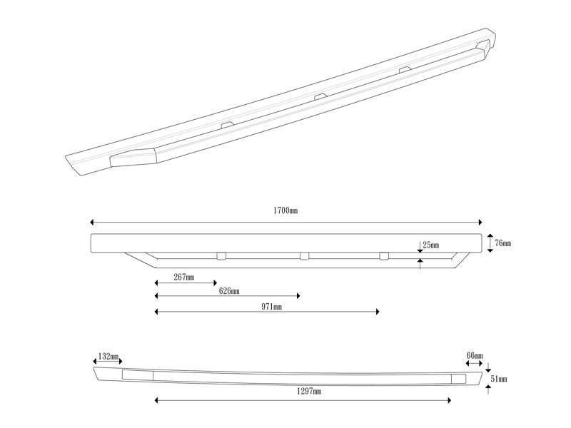

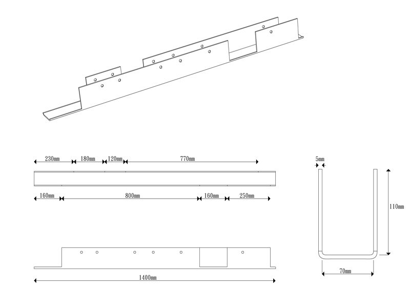

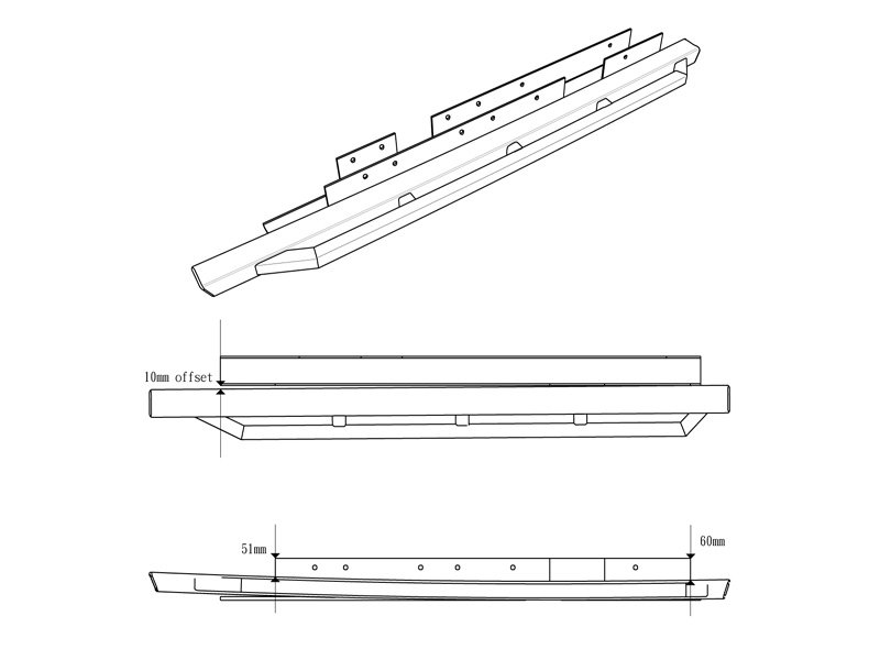

All the rock sliders for the Disco 1 and 2 attach in a similar way to these shown above. They are a 5mm plate "U" channel that covers the lower sill area between the wheel arches. There aren't any brackets attaching to the chassis on any of the designs. I have saved the plan's I've downloaded and can upload them if someone is interested.

As promised, here are the plans for the Disco 2 rock sliders.
I got them from this thread - https://landroverforums.com/forum/disco ... und-28617/

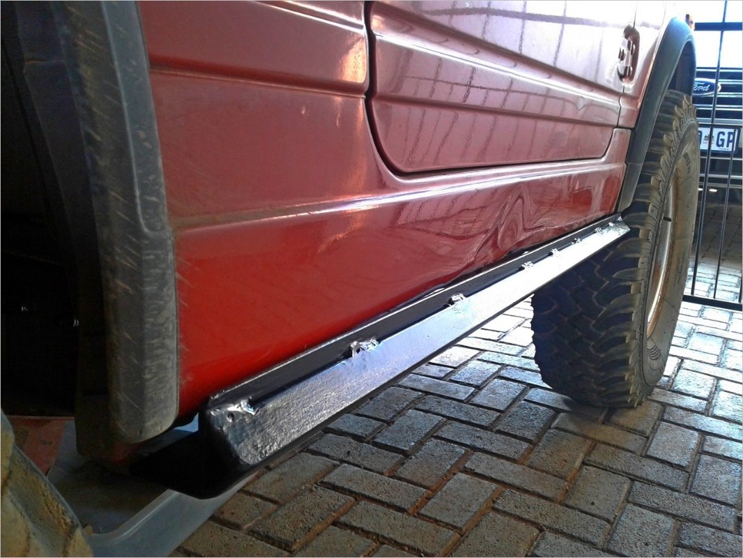

Paul#25 wrote: All the rock sliders for the Disco 1 and 2 attach in a similar way to these shown above. They are a 5mm plate "U" channel that covers the lower sill area between the wheel arches. There aren't any brackets attaching to the chassis on any of the designs. I have saved the plan's I've downloaded and can upload them if someone is interested.
Have you got a photo of those mounted to an actual vehicle?
#44
Mon Apr 16, 2018 9:54 am
I don't have any saved photos, but there were some from a thread where a guy used the plans to build a set. When I have a gap I'll try to find the link.
