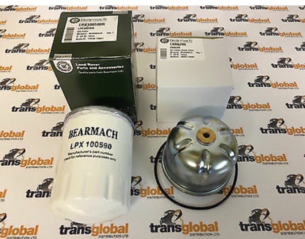

An oil change is a bit overdue on my 2001/2 TD5 Defender 130 and I have, to hand, the requisite oil and the two filters ... both standard and rotor.
