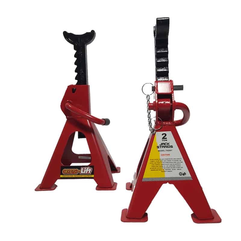

We often need to work under our vehicles and there’s equipment and techniques & ways...
We need to do it safely and have enough head-room to get down under and get the job done.
To kick off this discussion thread here’s some pictures below ....
I often use Normal Extendable stands and or Tree- trunk Blocks ...
The third picture below shows adjustable 4-legged stands for each wheel ; with a Hi-Lift
jack one could get car up to a fair elevation ...
