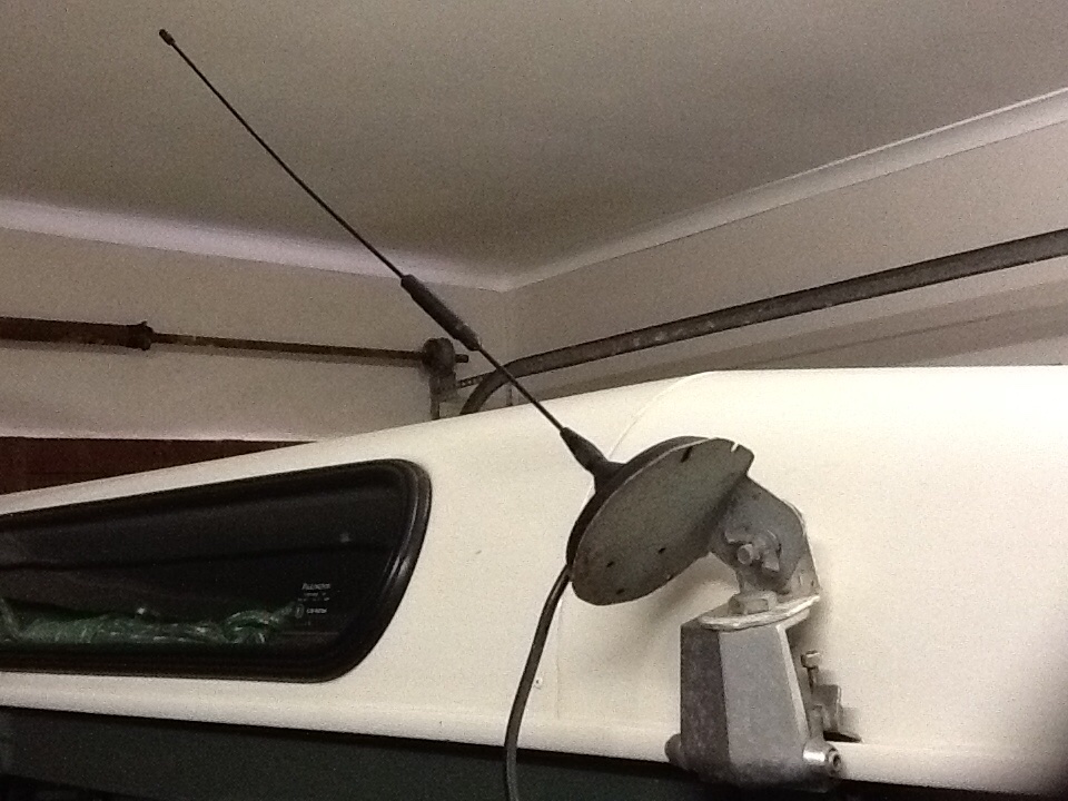

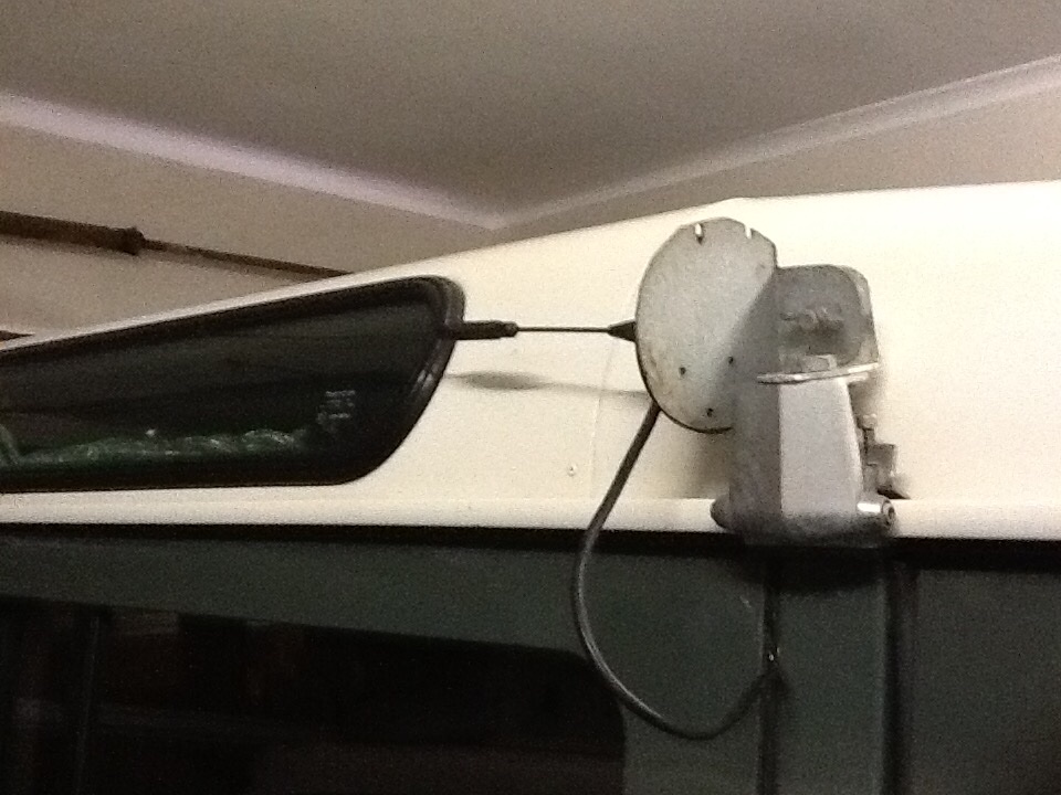

I have used a gutter mount with a swivel action to allow entry in garage.
Works for me. Also helps a bit with the branches
Cheers
Graeme
