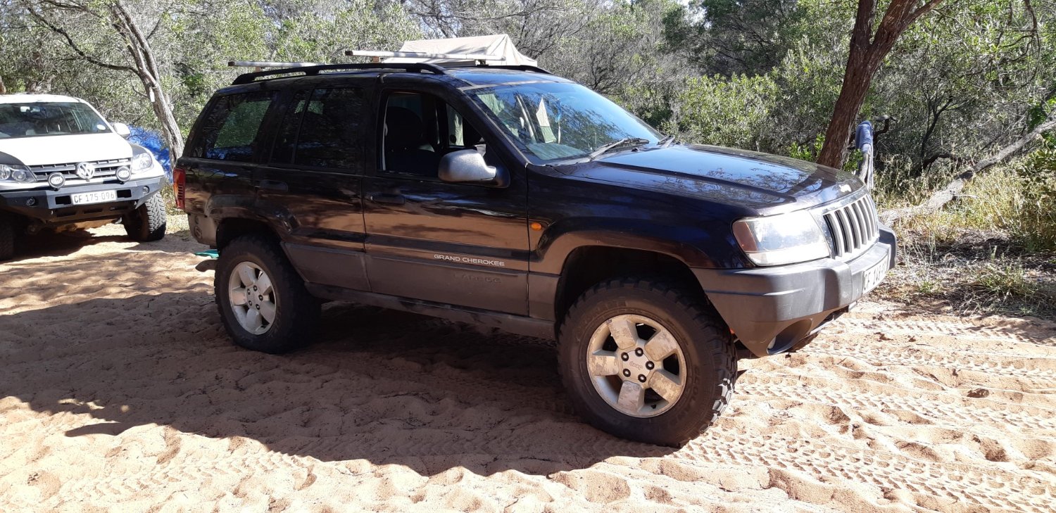

My gat het ge jeuk en ek het gekrap....
The Granny-wagon Jeep was just too low and the Wrangler all terrain tires just did not do it any more. :(

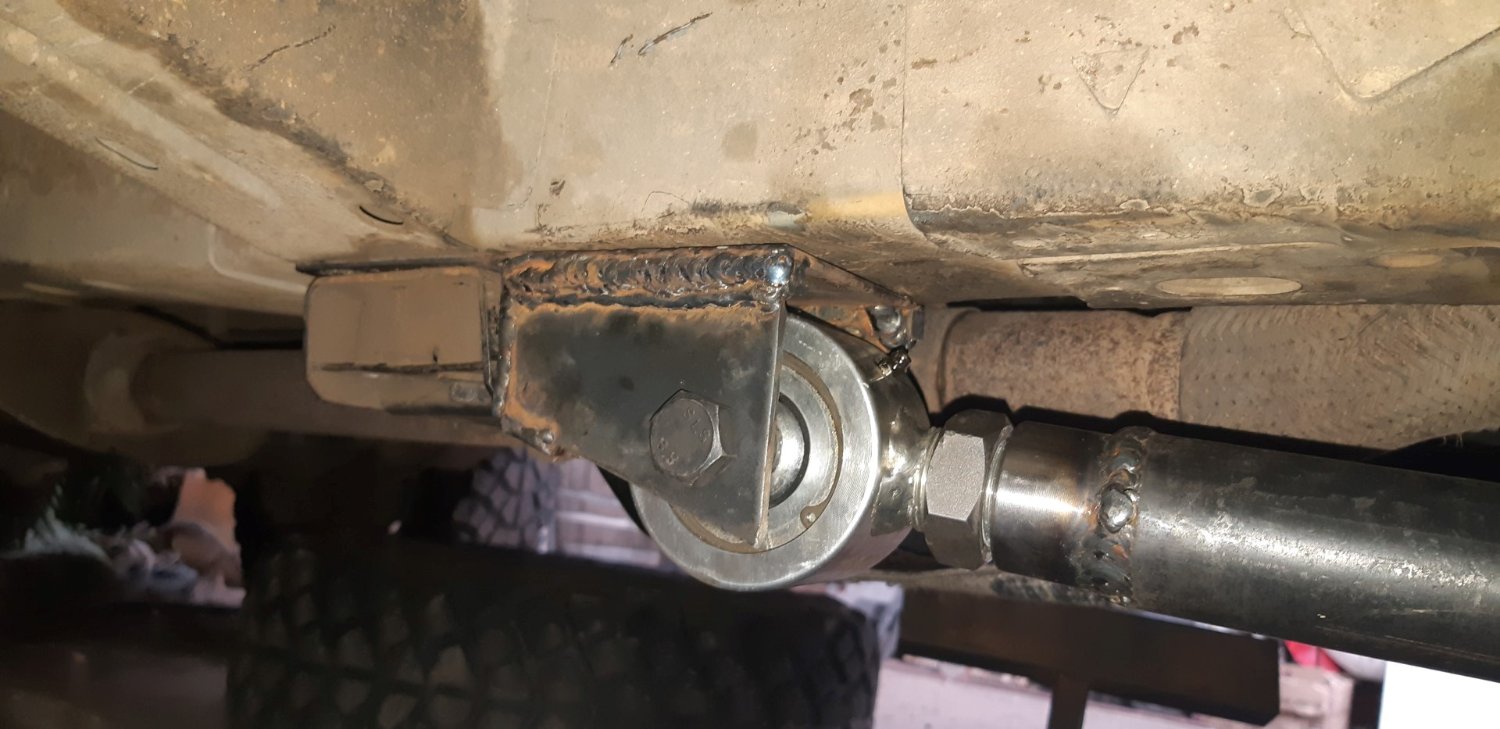

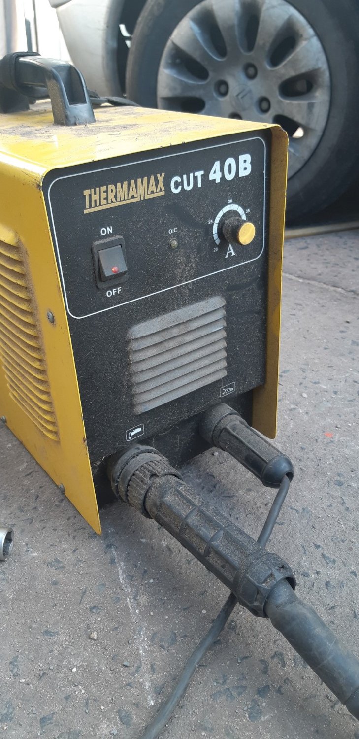

Pulled out a plasma cutter , Grinder, Welder and a few other tools and started the build process.

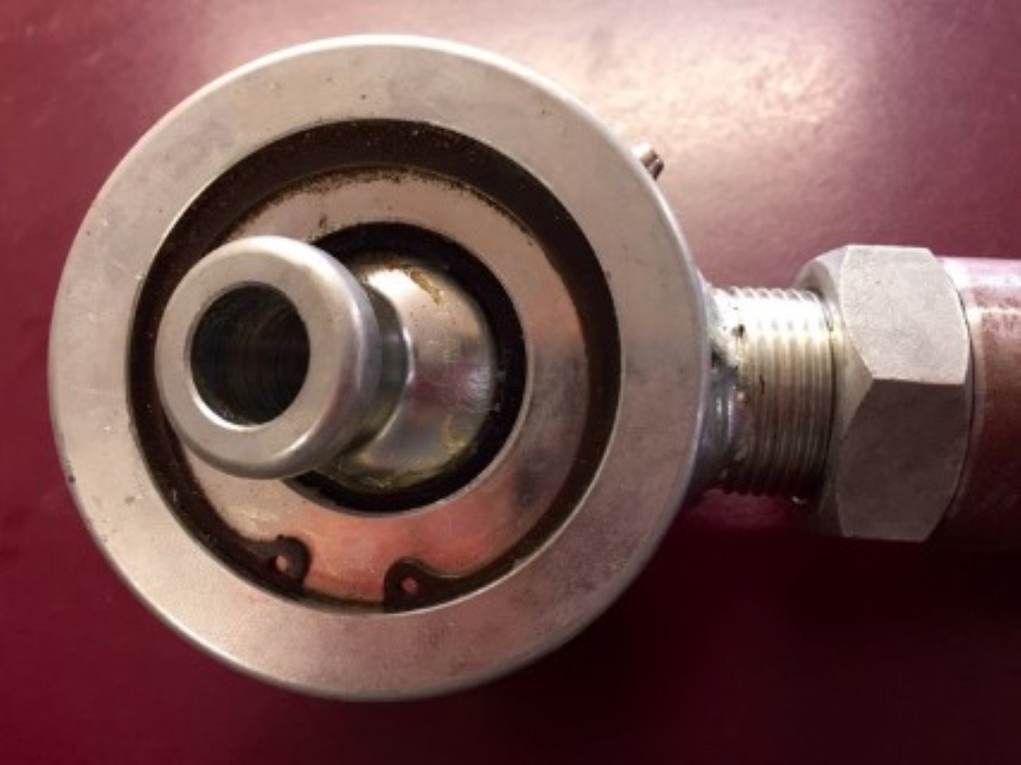

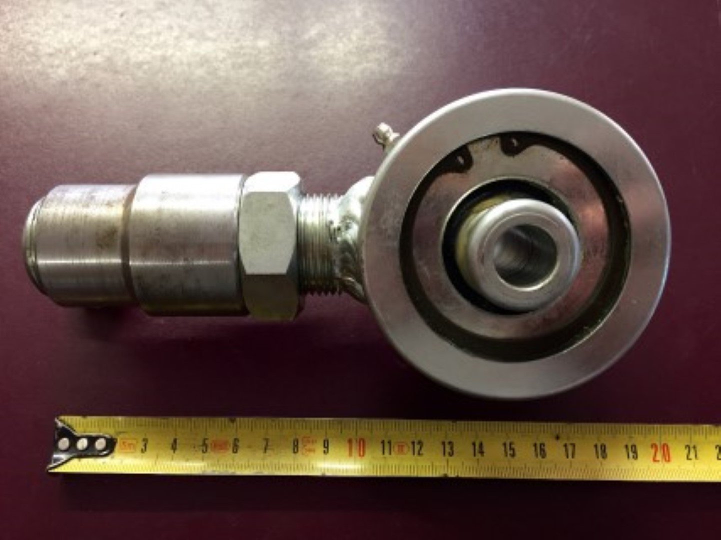

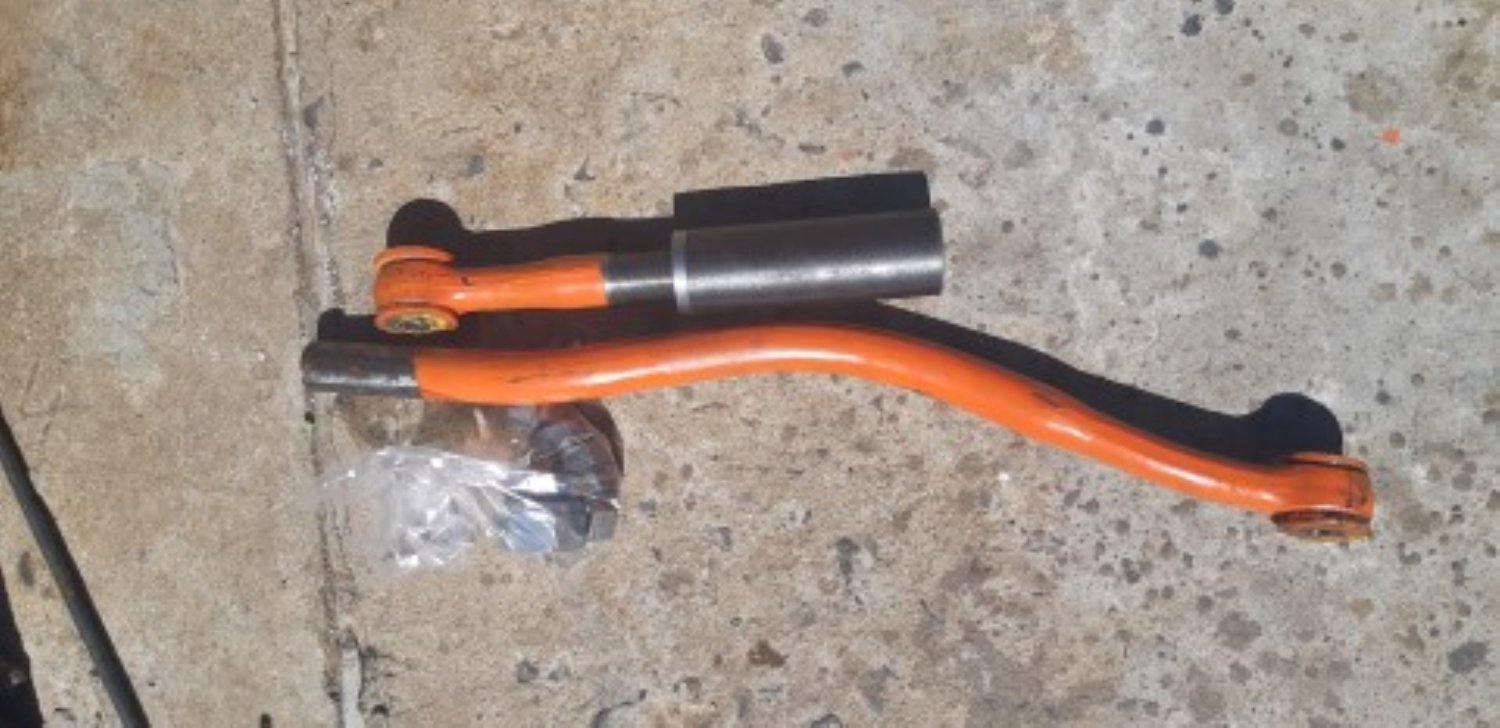

Spoke to a few guys ...done a lot of homework and then ordered some monster Johny Joints from Polokwane.

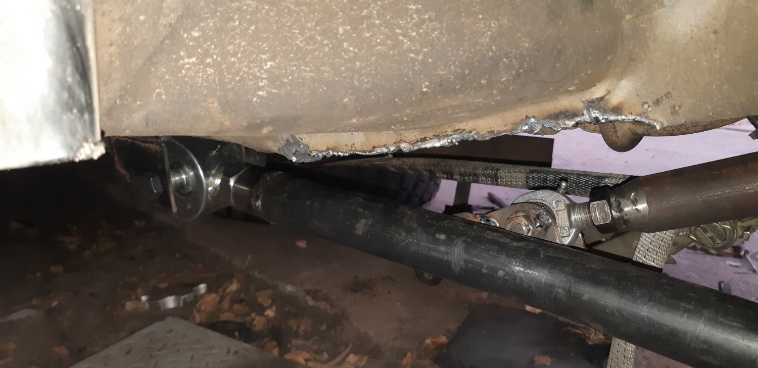

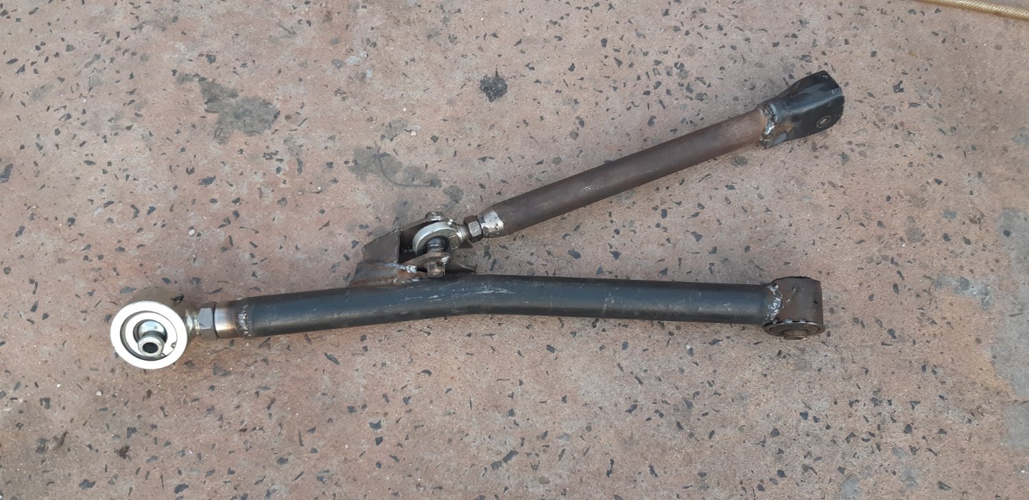

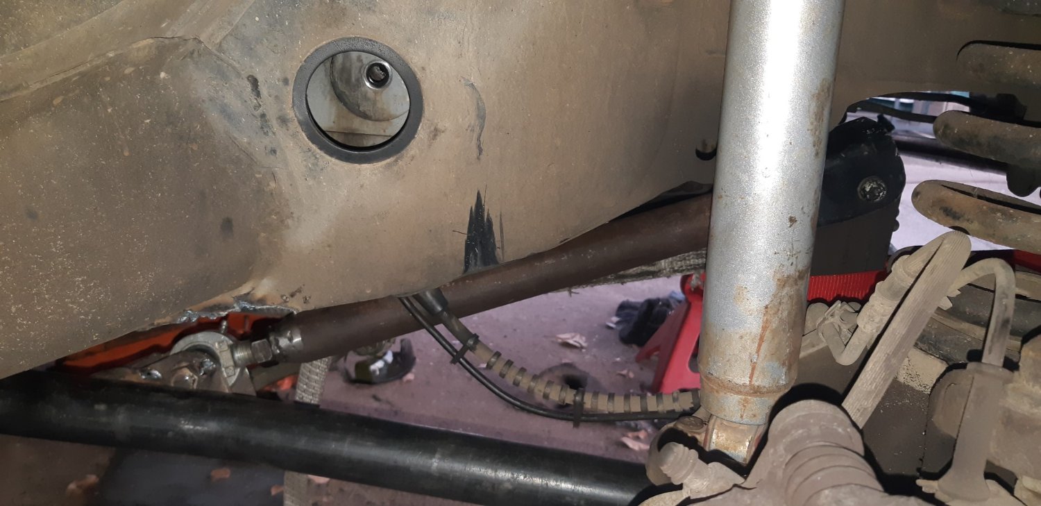

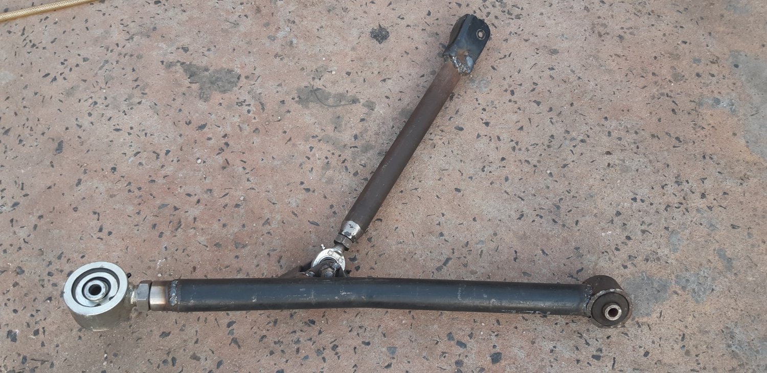

The arms are made from Schedule 80 steam pipe.

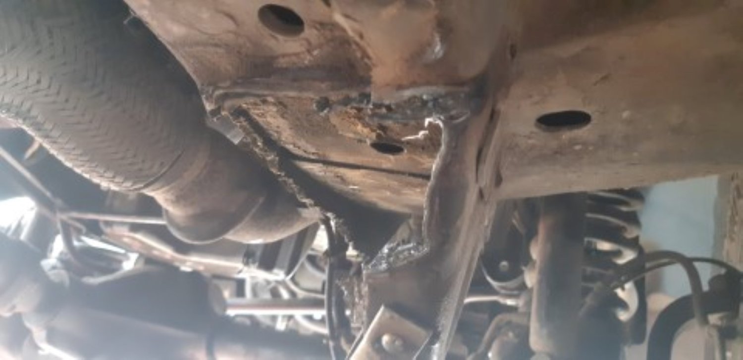

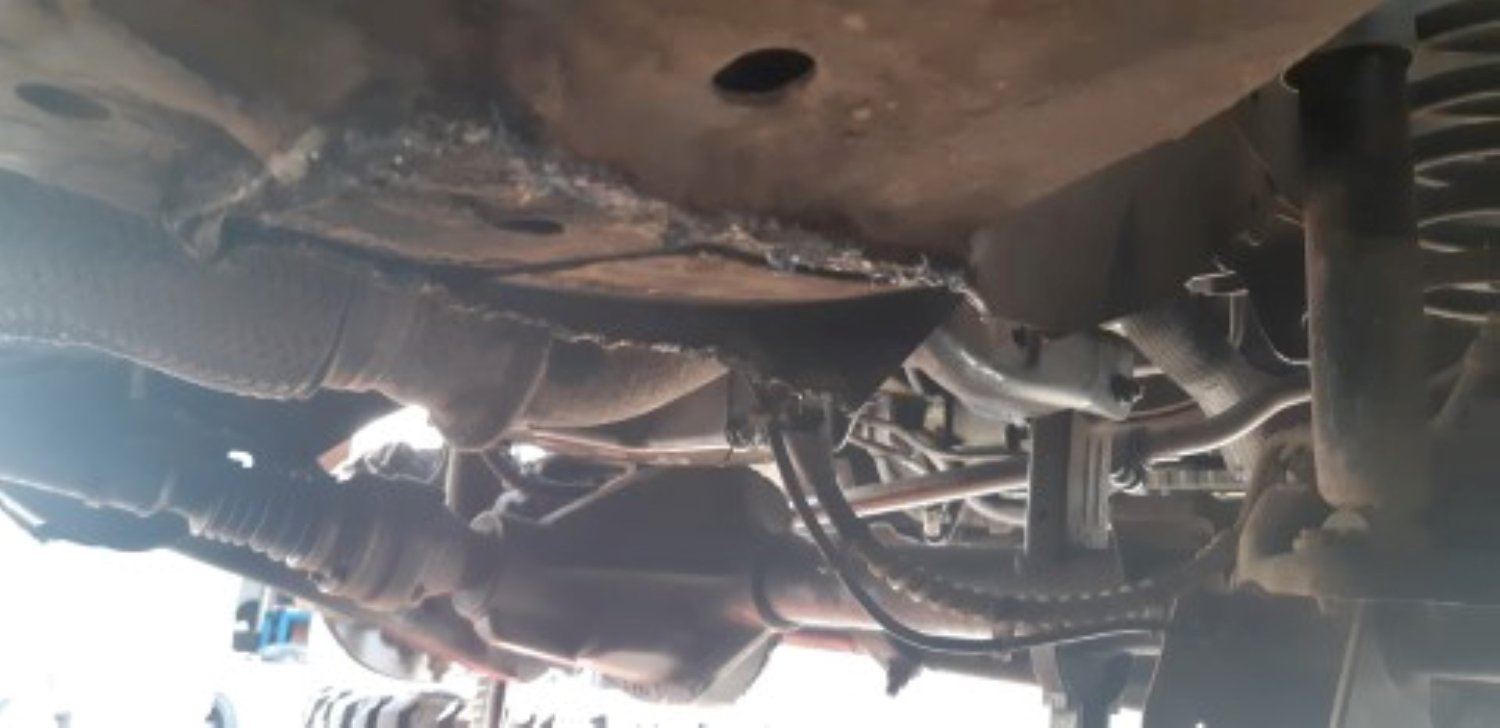

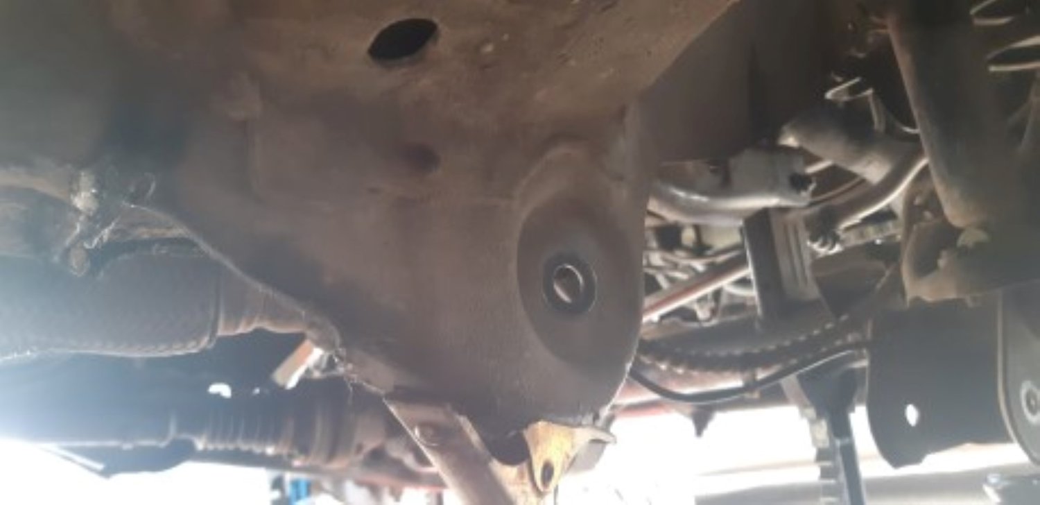

From when the Joints arrived to finish took me 3 days of work. That was building brackets...Cutting the original mounts for the Lower arms of with a Plasma cutter etc.

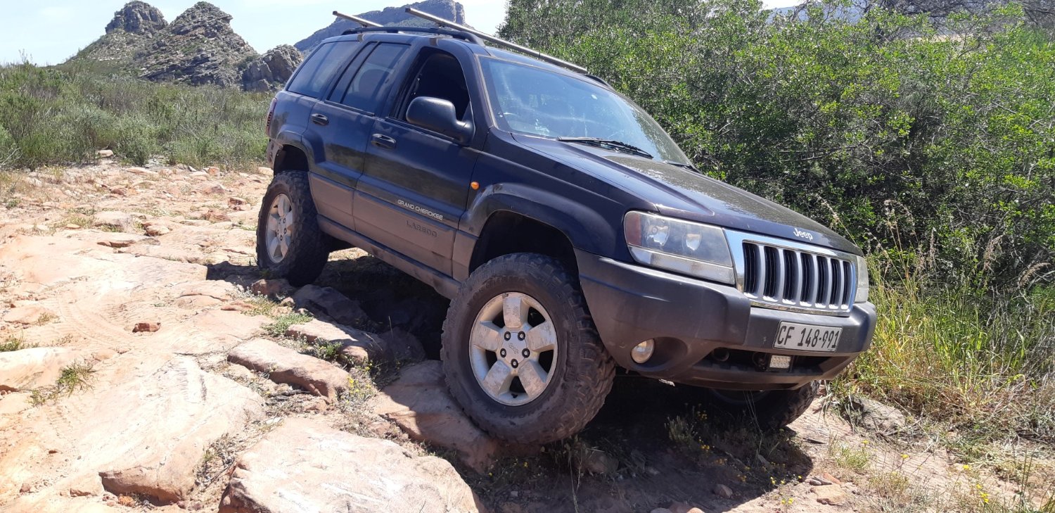

Took it the past weekend to Klein Tafelberg for a test. Man o man ...what a difference in ride quality and then on the trail....

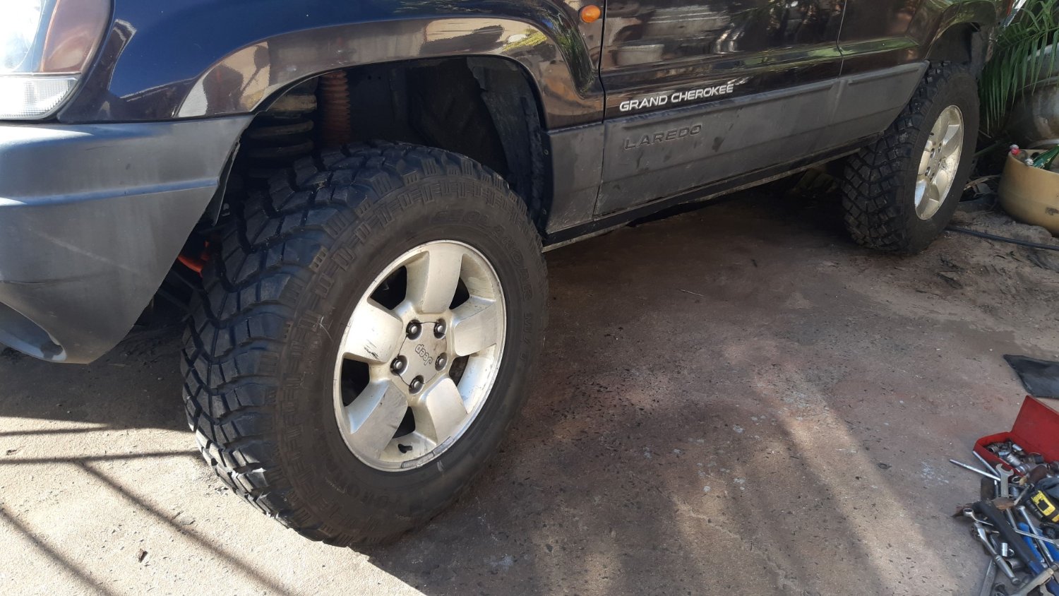

It is chalk and cheese difference between standard with 31 inch tires on and now with a 4 inch coil lift with the long arms in the front.
Still need to build the rear arms. So far the rear only got longer shocks and a A arm spacer to bring the A arm back into alignment.

Some pics of the Joints.....

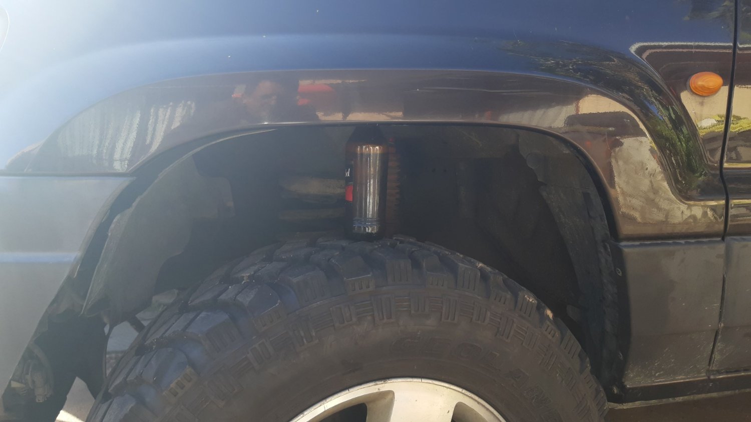

Still need to do a few things.....
Coil spring fell out in the front on full flex....Build coil retainers...
Brake hoses need to be extended.
ABS wires need to be extended.....
Build rear long arms.
