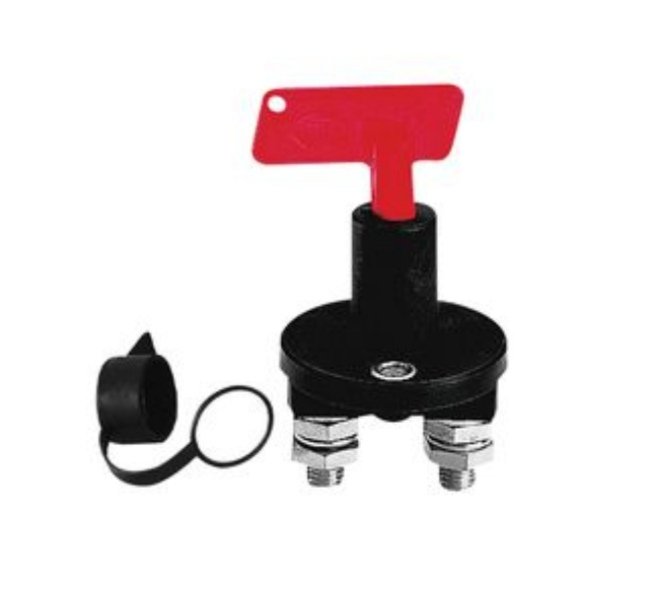

if its the cranking battery you are talking about then fit a battery isolator switch. Park and isolate the battery. Or just disconnect the battery when you park it. Battery should stay charged for three months if not longer. If he drives the car less often than this he needs to give it to me.
- Posts: 7183
Yes, disconnecting the battery is an option, but then he has to reset the clock & radio each time.
But certainly a cheaper & simpler option.
