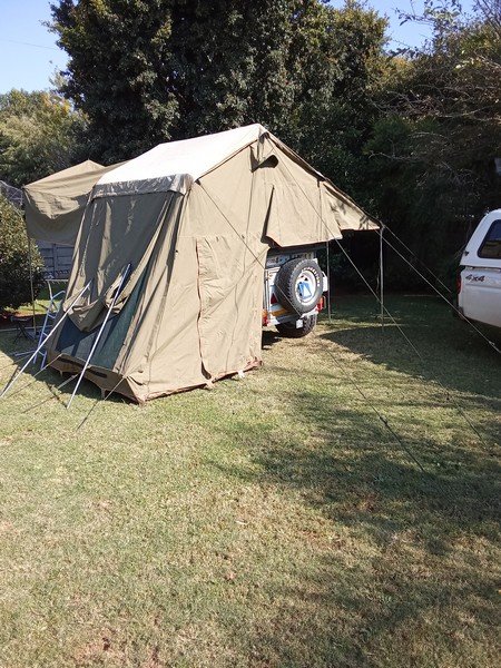

finally i managed to take a look at trailer and tent.
one of the 3 frames over the bed was broken and it made 5mm hole on add on room ceiling. patched.
same size hole at the floor.patched.
there is patio cover for back of the trailer(about same size as front one) and all around shade net panels that can be zipped
but i haven't get time to install it.
busy with fridge slide ....

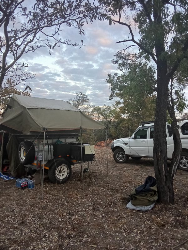

Testing the trailer at Marafiki lodge 20 km from Swartruggens

few things i did :
-fridge slide with storage box in front of the fridge and folding cutting board.
-there is now compartment storage under the fridge that can be accessed from opposite side when fridge slide is out(i use it to store gas bottle
cooking top.fridge 240v transformer,home design :) compact braai.....heavier things
-there is now storage compartments above the fridge(all the way from back to front of trailer)with access from the back door.
this drawer ,first meter of it,have pivot point and can tilt down and open trough back door if trailer is not full to the roof,for light not so necessary things that require access while traveling.i use it for extra shoes,blanket,pillow....
-trailer came with two gas bottle holders.each above wheel.one is removed and i build small kitchenette in its place (it can be seen on the photo as black box with two amber cat eyes)which holds portable gas stove(220g cartridge one),plates,cups,pan,spatula..
