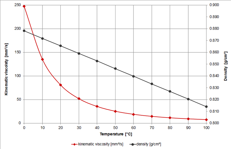

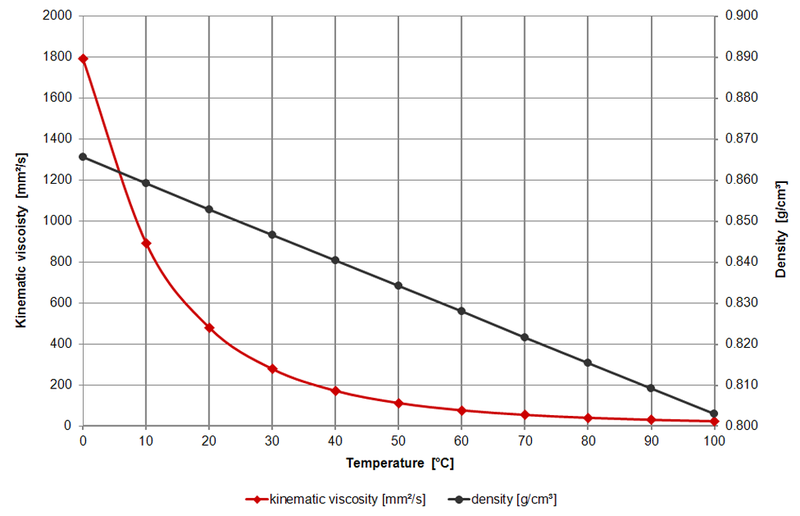

Hi Manny
If you look at the two oils
1.ATF
Source:https://wiki.anton-paar.com/za-en/autom ... fluid-atf/
2. Gear Oil 75W140
Source: https://wiki.anton-paar.com/za-en/autom ... fluid-atf/
You will see at about 80Deg Celsius the ATF viscosity sits at 9.57mm^2/s and the MTF sits at 33.544mm^2/s (Dynamic)
So seeing at this viscosity is MUCH lower, it will slip much faster. Thus your synchro gears that depend on friction to match the speeds is not that effective anymore and causes your scratching.
Also just check some ATF fluids are synthetic whereas MTF oils are mineral. Make sure you flush out the old oil properly!
The hotter the gearbox becomes the lower the atf drops, the worse the synchro mesh will be.
Or atleast that is my opinion...
