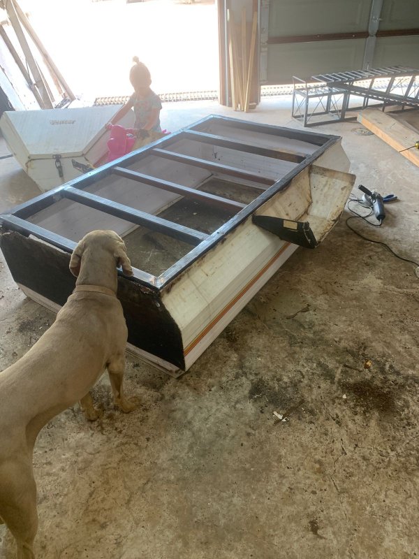

So flipped it around, bolted off the small bits and pieces only to find more and more rust. Removed the axle with wheels and leaf springs (560kg spring load)
Looking at various options to either to fix up the rust bucket or only create a quick fix and drive until the wheels fall off(too late I believe)
I decided to go ahead and cut out the complete bottom, because I decided to make my own ladder frame Chassis (50x50x2), cause why not...
Now started the fun part to Mig weld the body to the ladder frame... 3 days Later. Also having to mention that I used a product called "End-Rust" everywhere I did not cut out old sheet metal to prevent further corrosion and followed that by some red-oxide.
Noting that I decided to upgrade the leaf springs to new 750kg leaf springs from the old 560kg one, hoping the chassis might be a tad stiffer than the original one (1994)

Weld a 50x50x5 supporting angle iron to where the leaf-spring mounts will be added to distribute the load. Add back the axle assembly with new upgraded leaf-springs, new hangers, new 40mm bolt assembly kit
Taking 1.6mm flat-bar, I also riveted or at-least wedged the original venter hull between the flat-bar and ladder frame (70x4.8mm rivets)
