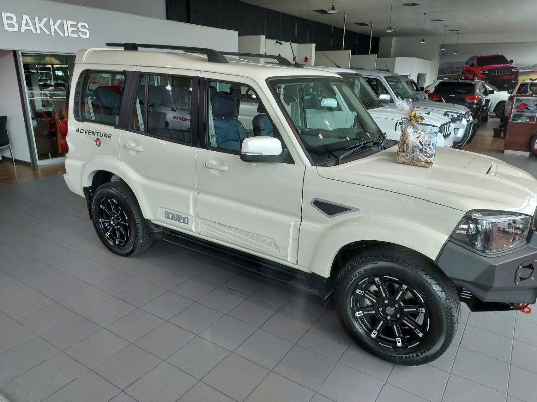

2) Why the Adventure Edition?
First and foremost, I am not a fan of any "special edition". It gives manufacturers the excuse to charge an exorbitant mark-up for relatively little additions to a vehicle. But not so much with the Adventure Edition. It has larger tyres and rims, a bit more ground clearance, decent front and rear steel bumpers, decent recovery points, better approach and departure angles and undercarriage protection plates over some important bits. I did a quick calculation, if we were to take a standard S11 and do the same mods as with the Adventure Edition, we would have paid R13k more. Mods (properly done by a reputable supplier) are very expensive in Nam.

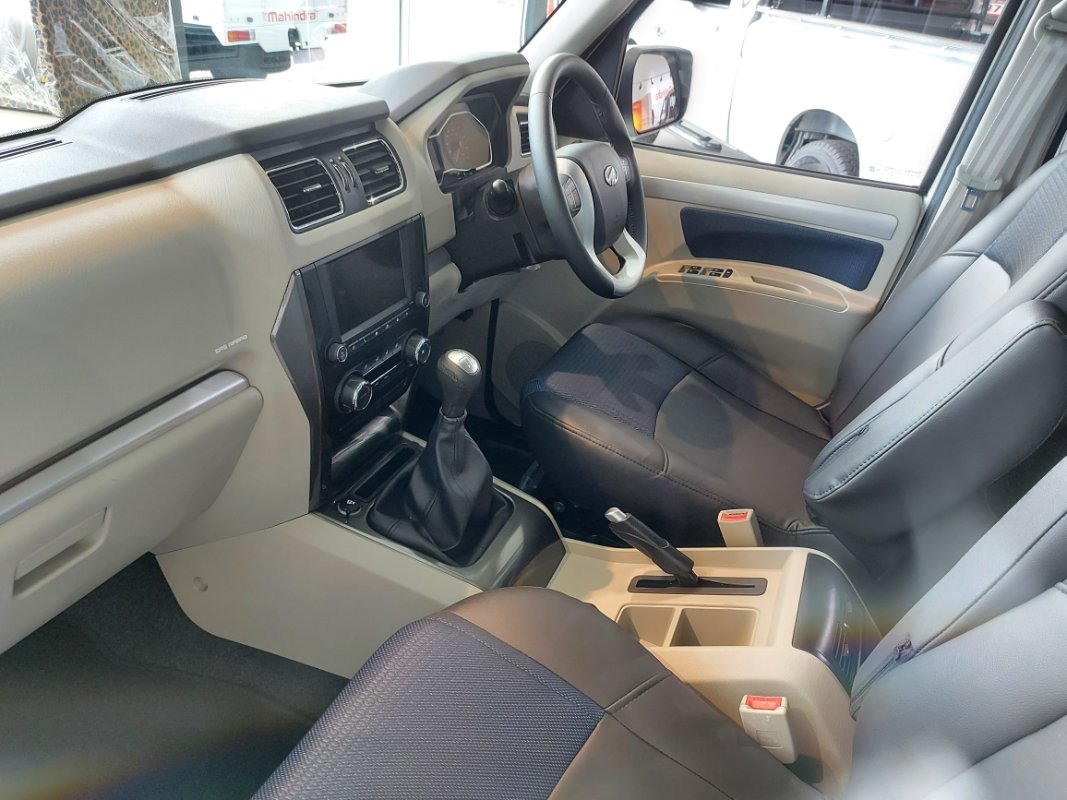

3) What the interior like?
My wife and I had a long discussion about this because it is difficult to reduce to words. Best way to describe it: it is like driving a large Jimny crossed with a 110 Defender (the older more preferred model). The seating position is commanding and it conveys a sense of sitting on top of the road rather than on it - if that makes any sense. Although the steering wheel can only move up or down, I found it very easy to get into a comfortable position (I am 1,92m tall). Both the front seats has an armrest which I think was a clever addition. Its a bit higher up than a standard center console but the more stouter gentleman would perhaps find it a bit intrusive. At one stage during the trip my wife took a nap, so she reclined her seat and mentioned that the seating position with the arm rest felt like sitting on a lazy boy and she quickly dozed off to the sound of diesel engine. Another drawback of the arm rest is that you have to swivel it to its upright position before you can undo the seatbelt - but that is a minor niggle.
The seats, although fitted with a combination of faux leather and cloth, is surprisingly soft, plush and generally a nice place to be in. I am sure the softness will dissipate over a few years and will most properly not wear as well as other seats in more expensive brands. This can be mitigated to a certain extent with some proper seat covers, but it will have to be custom made due to the arm rest.

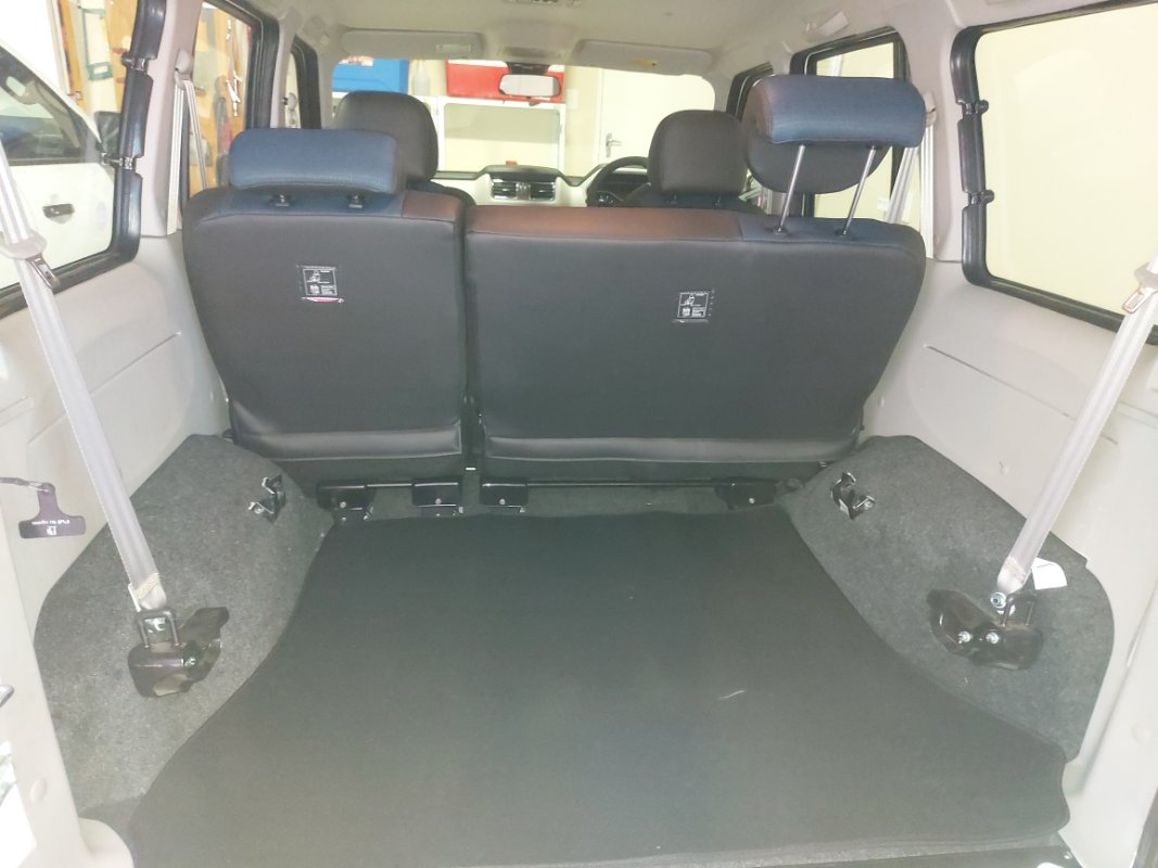

The back seat (or 2nd row seat) is just as comfortable. It reclines and slides forwards or backwards (mainly due to get access to the 3rd row seats). Its bottom bench is quite wide and measures about 58cm from the back rest to the end of the seat. In comparison, my Wildtrak's seat measures at 47cm. The most noticeable attribute is not rear legroom per se, but the fact that rear occupants' legs can rest at a 90degree angle. From the top of the bench to the floor is 49cm (my Ford comes in at 37cm).
However, with the 3rd row seats fitted, there is very little legroom at the back between the 3rd row and 2nd row and between the 2nd row and 1st row. This is not an issue for me as the first thing I did when we got home, was to remove the 3rd row - which was surprisingly easy to do. With these seats removed, the boot space is awesome and it makes the vehicle so much more versatile. It also allows the 2nd row to slide back which creates more than enough legroom between the 2nd row and 1st row - with the driver's seat adjusted to my preference, I can easily sit behind the driver seat. I doubt I will ever put the 3rd row seats back.
Due to the large windows all round, and the high roofline, the cabin is airy and large. In the front row I have 12cm of headroom which increases to 20cm in the 2nd row. Mind you, if the vehicle were to stand in the sun for a few hours, the interior will get hot very very quickly. This can be mitigated to some extent by the use of visors or a slight window tint.
The climate control function works really really well, but due to the size of the cabin, it has to work hard to keep the desired temperature (mine is set at 22degrees Celsius) and can be noisy sometimes. The infotainment system is surprisingly easy to use, but it cheap. So too the sound system. It is loud enough to enjoy your music, but the sound is somewhat hollow.
Make no mistake, the cabin is cheap and riddled with hard plastics. Do not expect a dear layout - ultimately you get what you pay for. But it is easy to clean and it is robust. I won't mind a bit of dust, mud and goo on the dash as I would on my Ford's dash.

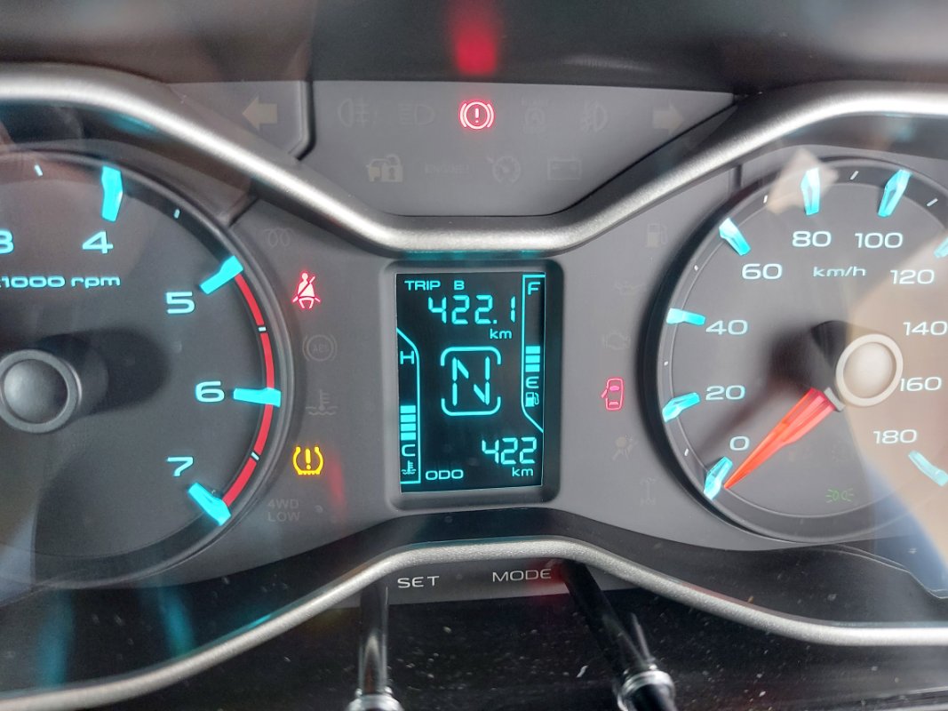

A few actually. Although M&Z Motors gave us superb service when we took delivery, we drove the vehicle off the showroom floor with a warning light on the dash. This was due to the infotainment system and the TMPS not being able to communicate with one another. When we got home, I rectified this by simply forcing the infotainment system to relearn the TPMS, and after about 5 minutes, all was good and well. Now I must give M&Z credit that they informed me of the warning light when they handed over the keys and undertook to send us new sensors on Monday which would be fitted at their local workshop. They knew we had a long drive ahead of us and I appreciated the heads-up and the suggested remedy. However, had they taken the time to properly read the manual, they would have been able to do what I had done before delivery.
Which brings me to my second issue. The Adventure Edition is fitted with 245/65R17 all terrain tyres while the standard S11 is fitted with 235/65/R17 highway tyres. During the TPMS learning process, I noted that the spare wheel is 235 and not 245 as the other wheels. I will notify M&Z about this and request that they fit the correct tyre to the spare rim.

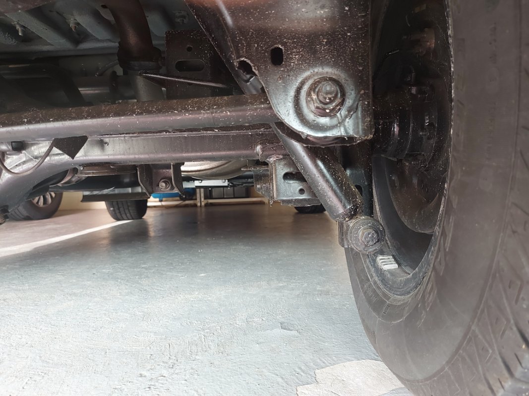

Regrettably, I am yet to take it off-road. There was simply not enough time this weekend to do so. At first glance it certainly looks the part and with the steel front bumper fitted, it will have decent approach angles. The rear steel bumper however will lower the departure angle IMHO. As mentioned above, the engine has more than enough torque to negotiate a slow climb and the gearing will be well suited for beach drives as well.
But is has some limitations: The lack of a locking diff and the positioning of the rear shock mounts will make a rocky climb difficult, but not impossible - one would have to chose the correct line to prohibit any damage to the rear shock mount and side steps. Although the sump is well protected by a robust steel plate, there is no protection underneath the fuel tank. This will have to be rectified. I also noticed there is sufficient space to fit a 20lt aux tank, which I would consider first before fitting a protection plate over the existing tank.
I am sure that despite its limitations, it will be able to do most grade 3 and (some) grade 4 obstacles, but it would require a guide who knows his stuff. But for the most part, I am sure it will do well and hopefully as time goes by, I will be in a better position to elaborate on its off-road prowess.

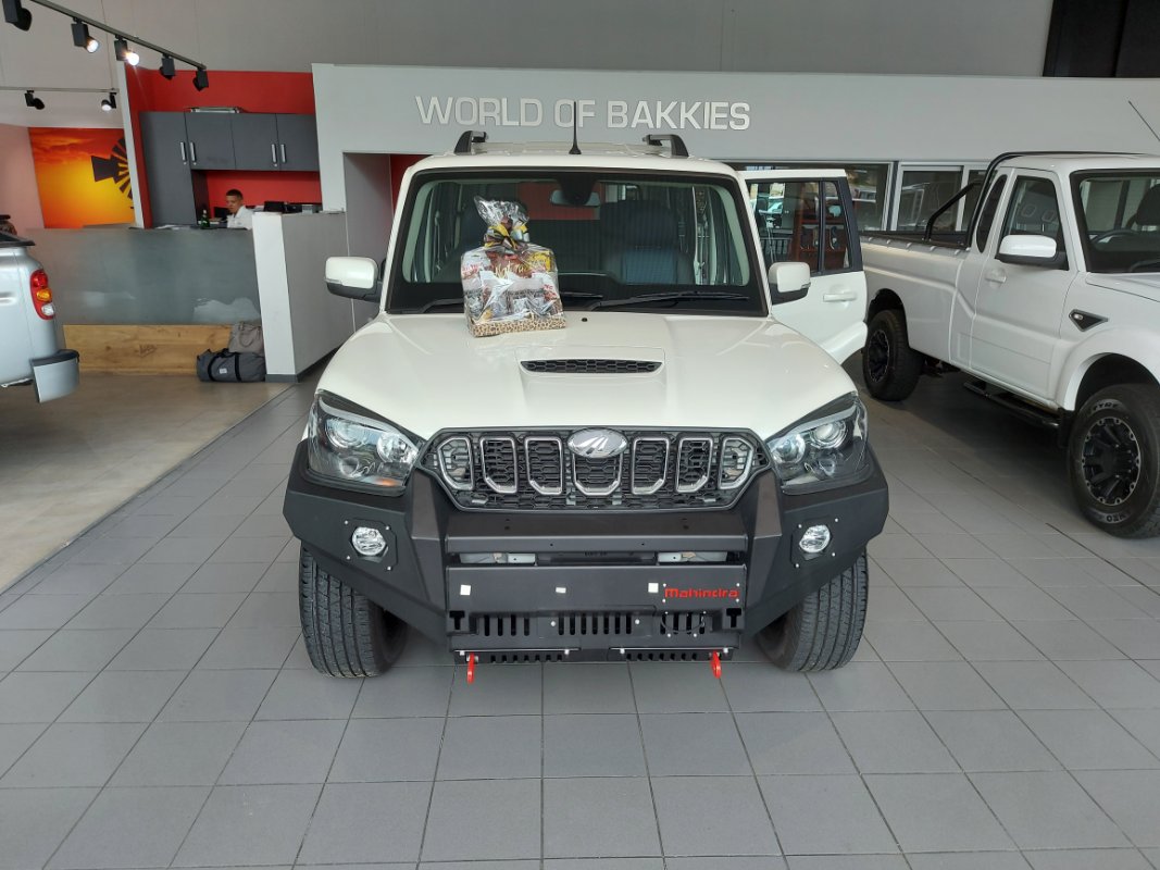

Some pics:

The S11 is advertised as fitted with auto lights and a TPMS as standard. But it's not what you may be used to.
The auto lights work well with the only drawback being that you cannot engage brights from that setting. I reckon it is only meant for when you drive through a tunnel or in gloomy conditions. To engage the brights, you have to adjust the stalk to the usual headlight position.
Much the same as with the TPMS. It does not reflect the actual pressure or temperature of the tyre, but only shows "Ok" on the infotainment system. According to the manual, if the pressure fluctuates by 0.3 bar, it will illuminate an alert signal on the instrument cluster.
