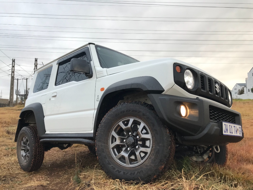

So as I'm new to the forum and keen to share my toy with you Oaks.
JB74 :
Has a 40mm Lift kit from ToughDog
Wrangler 215/80R15 for shoes
and some other not so exciting non-standard bits
The plan 1:
Rockslides ( Des-Sol or Wildog ) kind of undecided , anyone got some feedback on these it would help me .
3/4 roof rack from Frontrunner
Radial cup protectors ( Des-Sol or Wildog ) Also undecided on these
So that's my starting point and as we all know it will never end there .
I'm open to any advice on what good bad or a solid start on this little beast of mine
Thanks Guys

Ok so I think I need to take a better pic , this one is about as exciting as watch paint dry

Decided to take the long way to work today
Some better pics

Wave
Posts: 625
Post by Wave »
Much better photos! Looks sh!t hot Iron

Rock sliders - The Wildog ones look great, but don't have a very good mounting system. The Des Sol ones are tough as nails.
Radial Cup protectors - You need to match the rock sliders with the radial cup protectors (RCP's), e.g. With Des Sol Rock Sliders, you can only use Des Sol RCP's. Again, the Des Sol product is tough as nails.
Roof racks - It's best to avoid weight on the roof of a Jimny. The manufacturer recommends max 30Kg, The Front Runner roof rack is 28kg, The Easi-Awn one is 32.5kg
