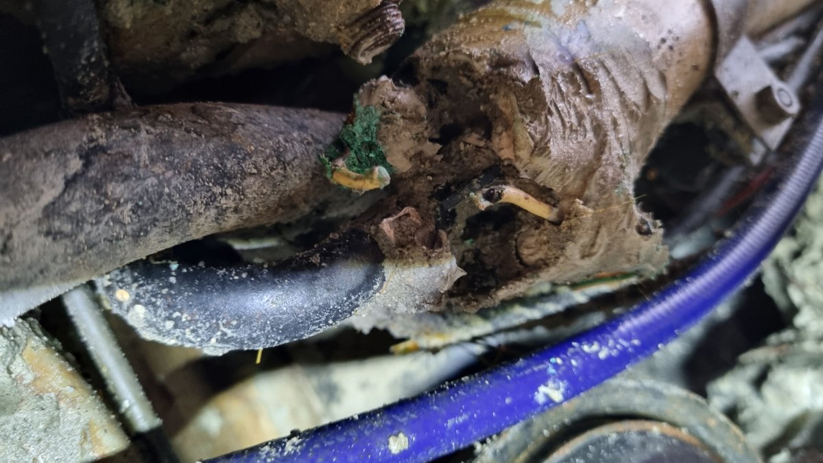

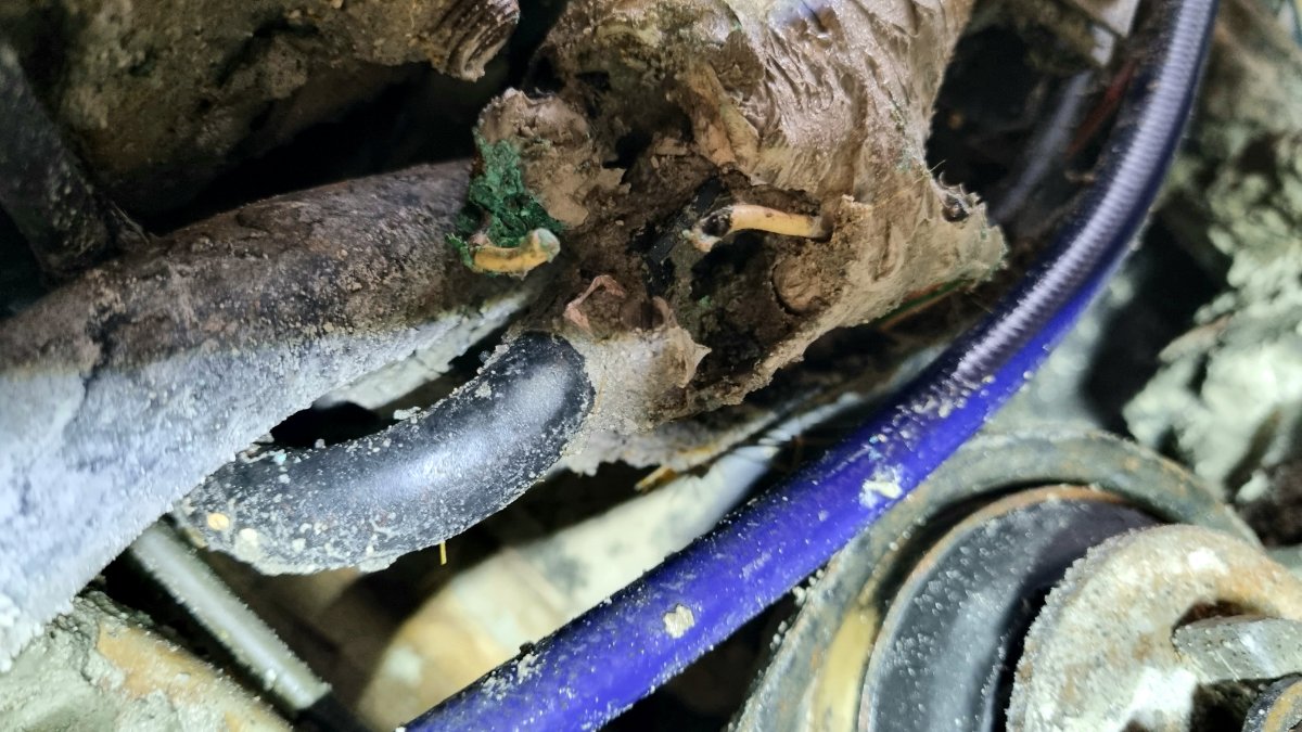

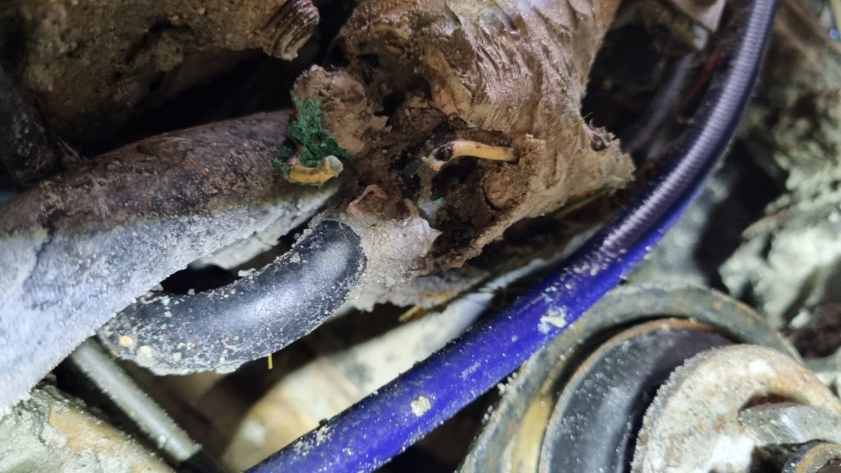

Then my eye spot what I immediately knew what the problem was.
From the Silicone sealer I applied in the beginning of the trip on the Positive terminal
Touching the pump body and with the high salt contents of the pan mud the wire was corroded completely off with the the green acid slime found on a vehicle main battery terminals.
Barely touching either side so if Renay switch ignition on there is just enough power to run the pump and I get fuel pressure. But when we try and crank to start the engine the movement prevent the pump from getting power to pump fuel.
Man o man o man when I saw this I knew I'm driving the Syncro home.
Removed the Silicone and old wire. Extended the wire and a new push on terminal on and the engine Fired up.straight away.

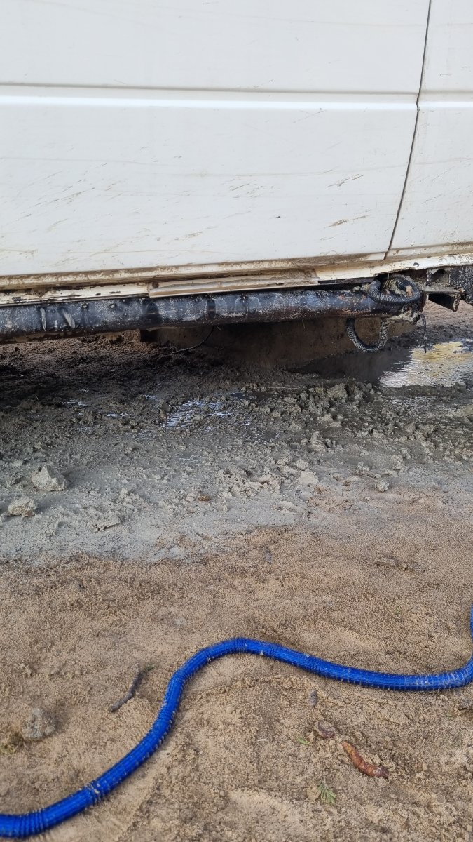

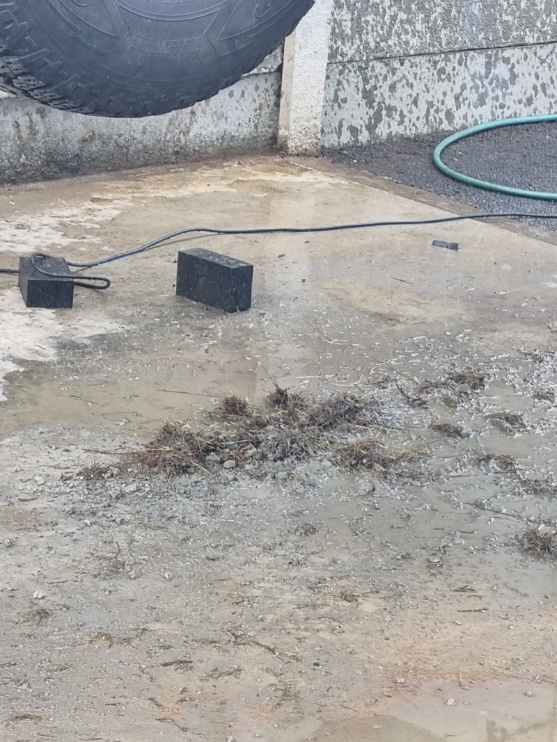

Early morning I was at the car was around 8am it took the guy with the pressure cleaner about 45 minutes to give the chassis a decent wash. The whole time I left the engine running as the starter was not sounding to happy aswell as my Alternator bearings from the pan journey.

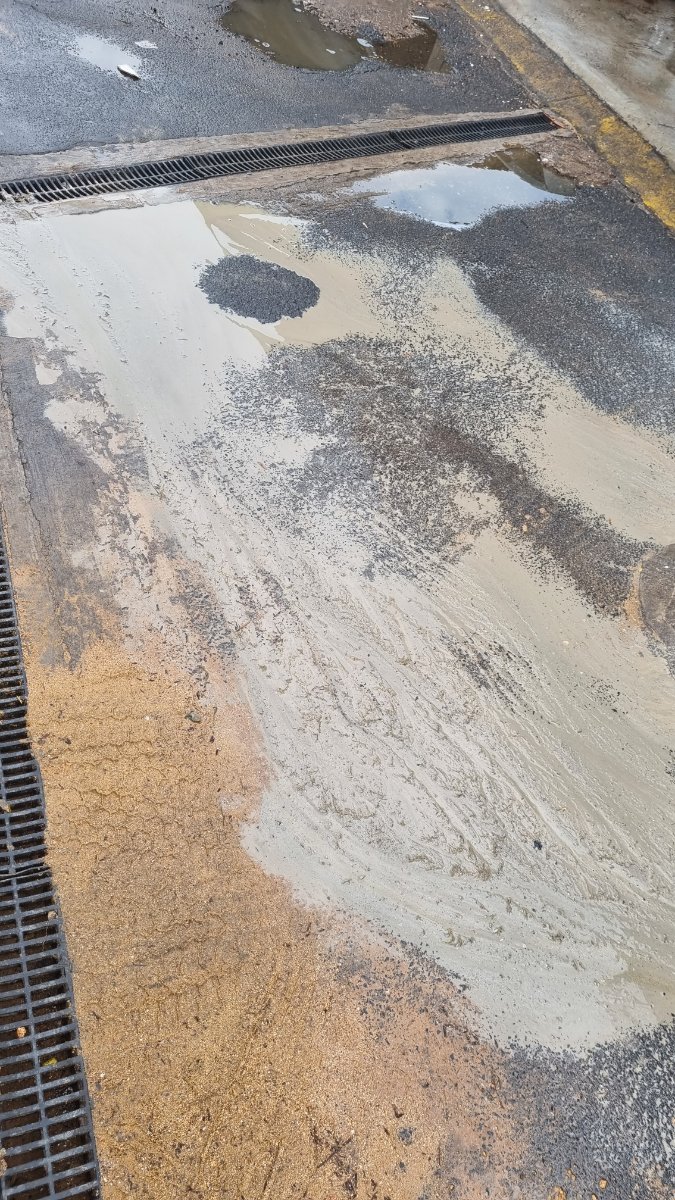

This was now the 2nd mud wash the bus recieved with the mud turning in to liquid cement running in to the separation oil catching tanks.
Gave the bus a decent wipedown and vacuum inside.

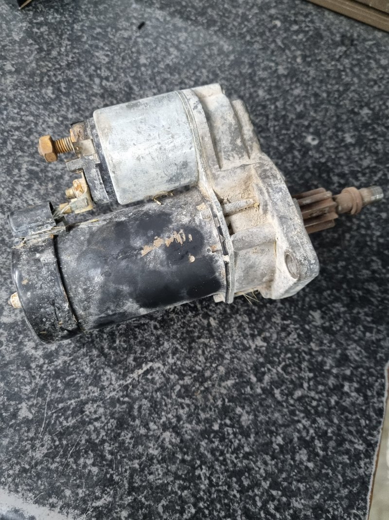

Starter dead as a door nail.

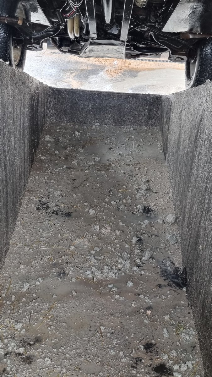

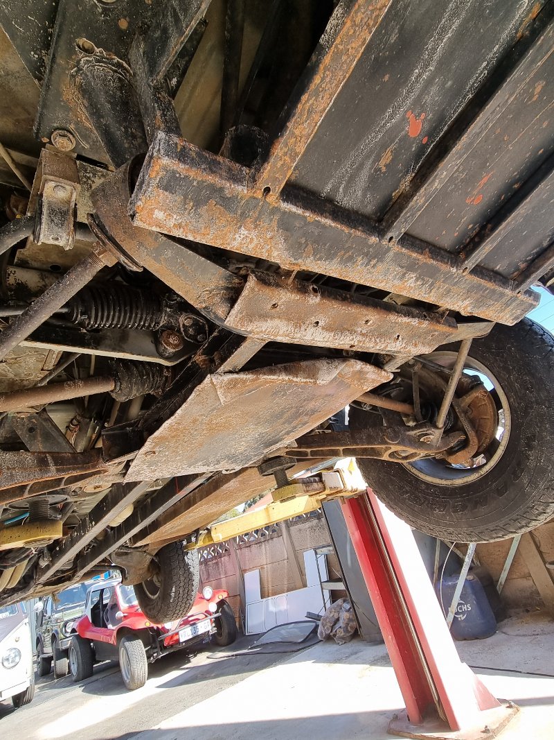

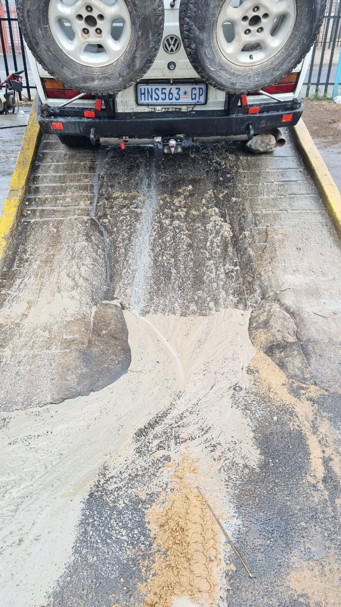

Pushed the bus to the hoist and jacked it up to have better access to pressure clean more.
My one guys got stuck in with the pressure cleaner and Holy Moly I could not believe how much mud he managed to pressure wash out again.

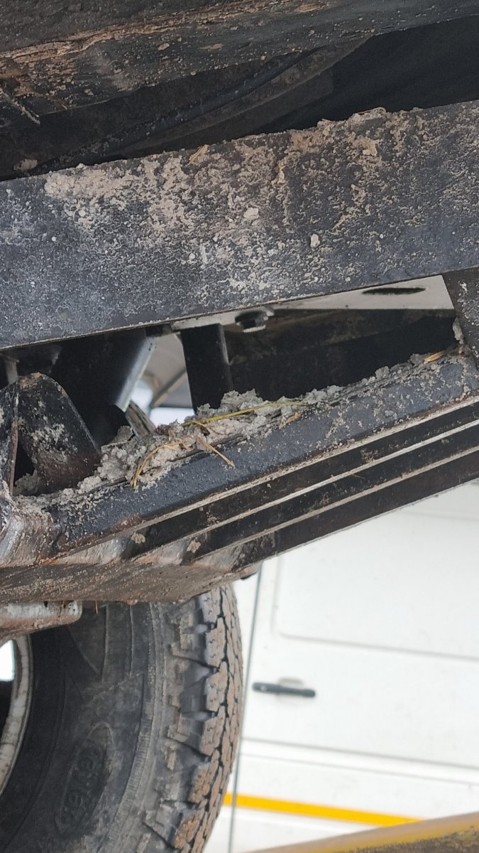

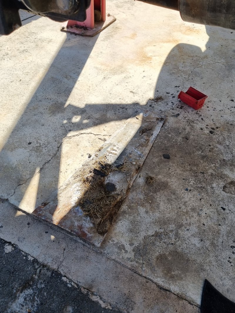

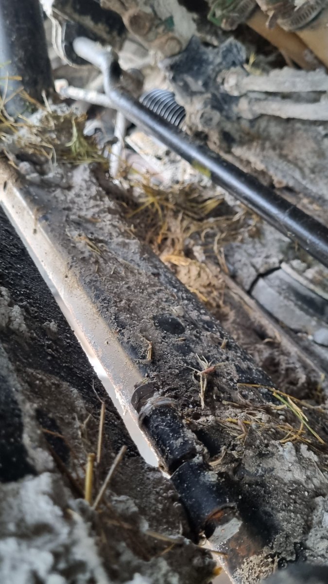

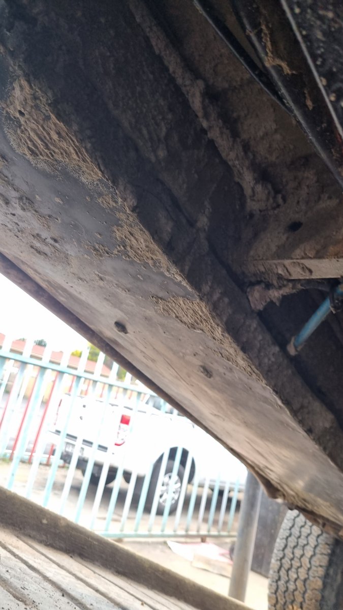

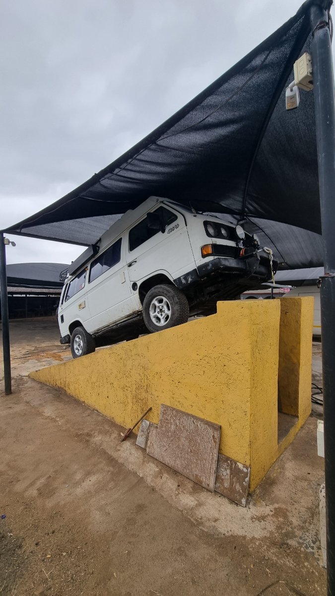

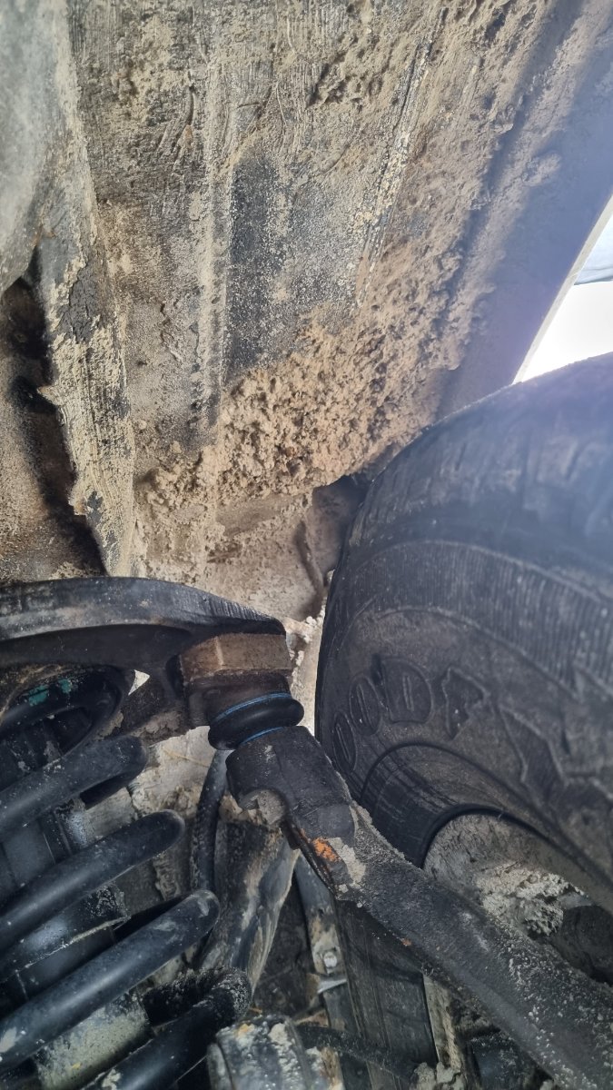

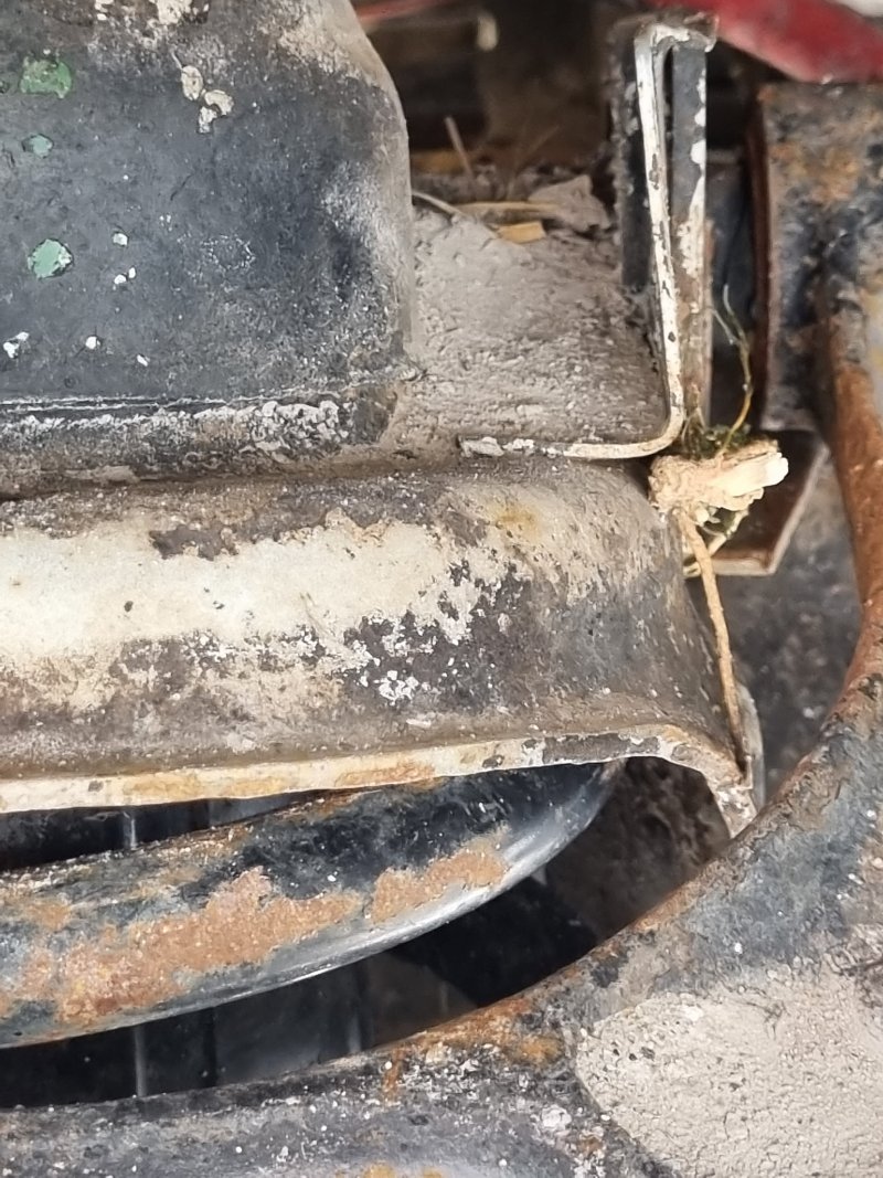

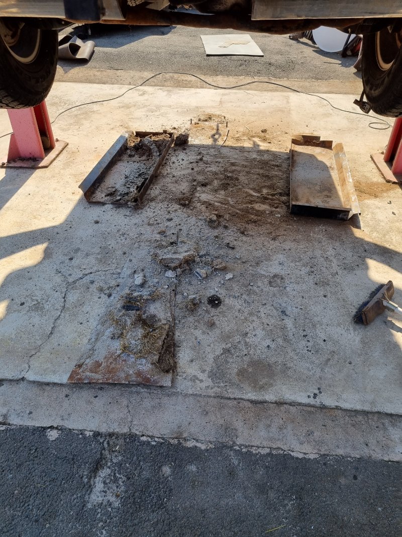

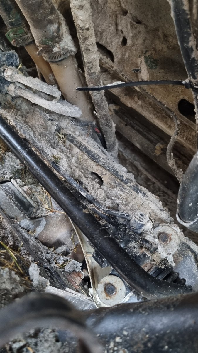

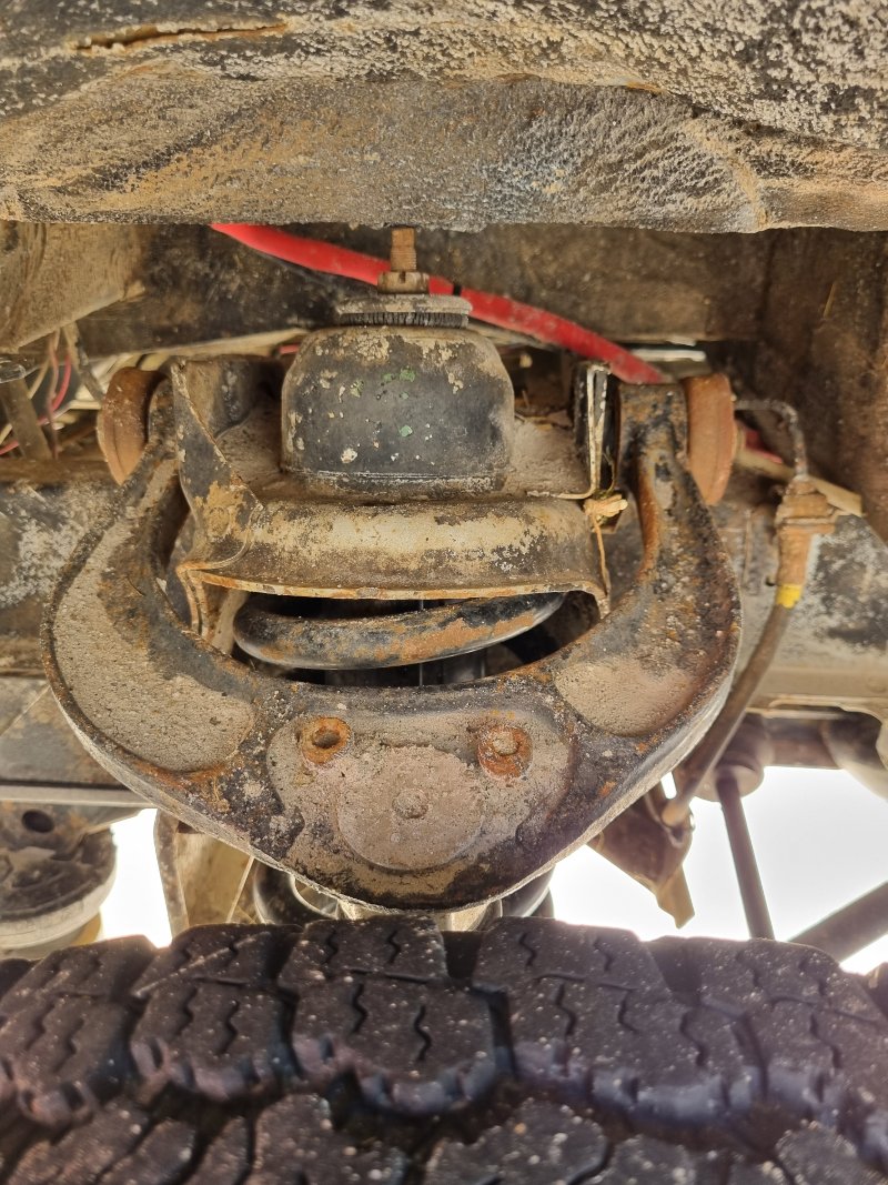

Monday 17 May morning we removed the dead starter and my one guy removed all my skid plates to reveal alot of Mud stuck just above where the skid plates were.
On the pics you can actually see the abuse the one front skid plate took bent backwards
From being the lead vehicles and in a rush hitting holes and jumps.
Again I instructed our cleaning guy to get stuck in and pressure clean again.
Pictures attached tell the story.
So boys and Girls the wet season in the salt pans is no playground for a volksie bus unless you want to make alot of work for yourself.

Thanks for your reports and photos. I suppose the moral of the story from your last posts is to stay out of the mud. As much fun as it might be to go spinning and drifting in the salty mud, it's going to cause you lots of work to get it cleaned off and stop the bottom of your vehicle rusting away.
Posts: 1234
#53
Paul#25 wrote:Thanks for your reports and photos. I suppose the moral of the story from your last posts is to stay out of the mud. As much fun as it might be to go spinning and drifting in the salty mud, it's going to cause you lots of work to get it cleaned off and stop the bottom of your vehicle rusting away.
Correct to say fun when you drifting in the mud but causes so much unnecessary headaches

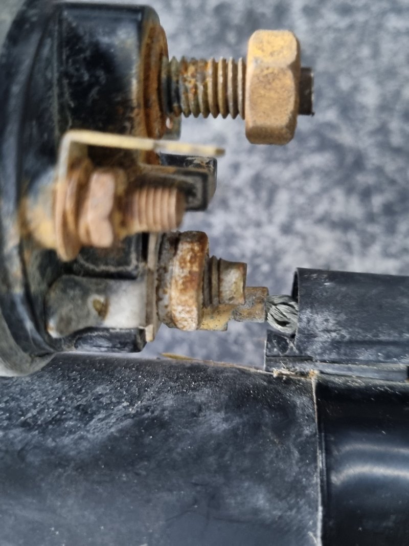

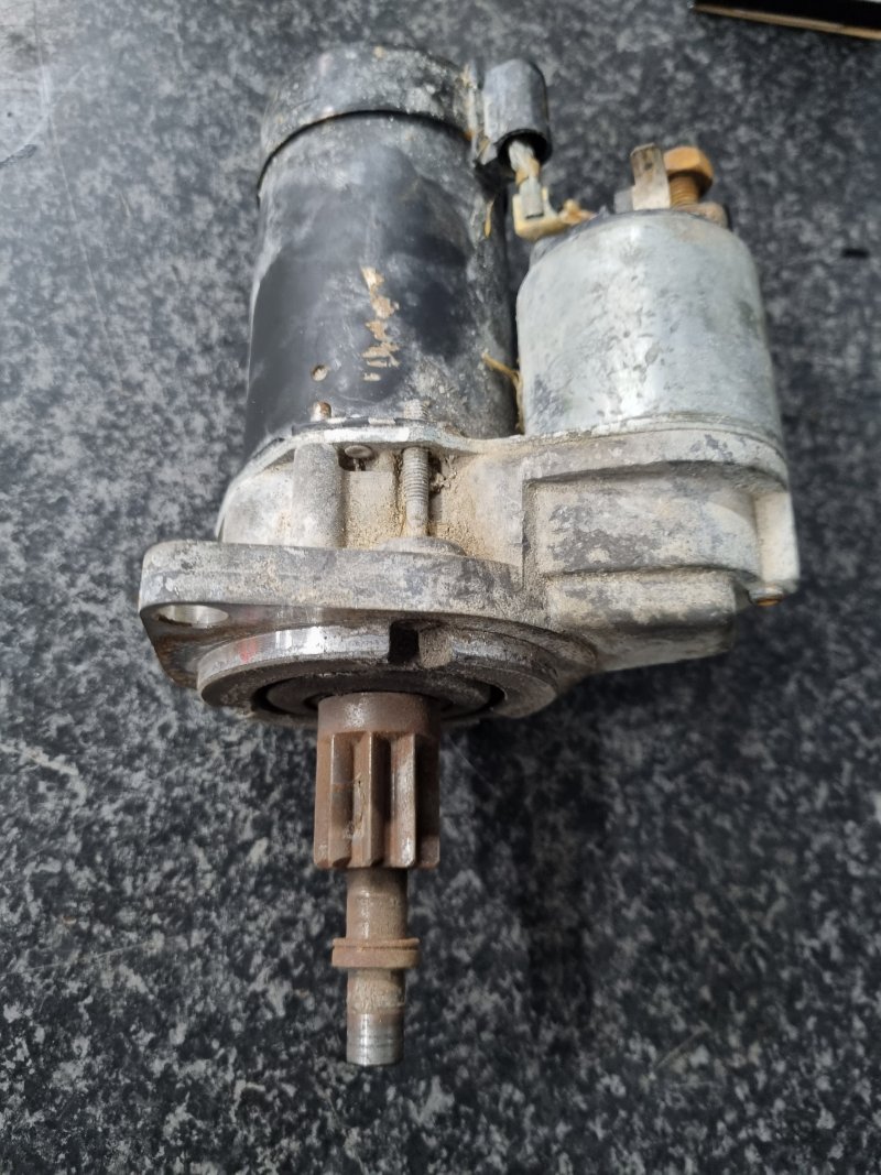

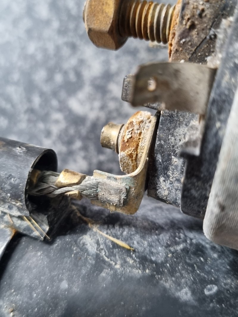

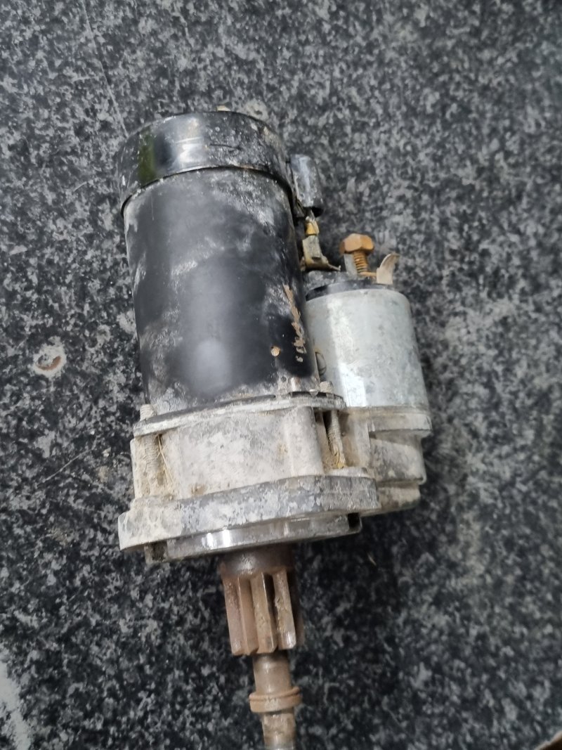

If you look at the picture of the Brand new starter installed 5 days before the trip how rusted it is
That alone tell you a story
Other important fact is to drive a casual speed without pushing and damaging your Vehicle
