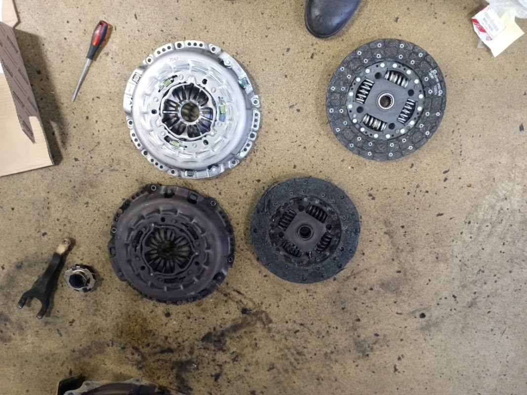

Toyota Fortuner G6 2.8 4x4 MT Clutch Failure
That clutch is badly burnt, I think what saved you is you had the failure and then had to drive 100km, so who is to say where it burnt blue
before failing or after.
This is, in my view, what swayed them in your favour.

Bogaards wrote:
Wed Feb 22, 2023 3:12 pm
Attached the pictures of the clutch that was removed.
Would appreciated some technical comments/feedback.

Bogaards
Has thanked: 57 times
Been thanked: 91 times
Posts: 226
Post by Bogaards »
I think the driving for a while with it definitely played a part.
Something must have been wrong beforehand. For example when reversing out of my garage there was a slight shudder.
So it might have had a scar already, then with the added weight of the caravan it just started slipping and once it started it was doomed.
Just glad it got sorted.
Bogaards
Posts: 226
Post by Bogaards »
Just an update, comparing it to the old clutch, there was definitely something not right with the old clutch. When reversing out of the garage there was a slight shudder. Nothing major, but comparing it to the new clutch something was brewing in there.
Bogaards
Posts: 226
Post by Bogaards »
Attached a picture of the old and new clutch.
I assume the old clutch was red-hot...
Quick question, the inner disc, does it look the same on both sides?
Posts: 1545
If you are referring to the clutch plate, most if not all of them aren't symmetrical. The splined centerpiece is offset and can only be fitted one way.
