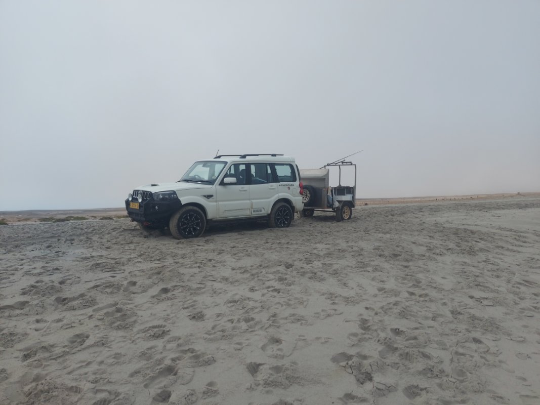

So I am back from the coast and it is time to report on the Scorpio's performance.
First the bad:
1) Unless you are a midget with abnormally short legs, you cannot totally fold the passenger bench down.
2) Deflating the tyres to anything below 1,2 bar sets off an array of warning messages: the first being low pressure and the second a possible puncture. The last-mentioned may be due to the fact that I deflated the tyres while the engine was idling. At some stage a 'Merican voice starts kakking you out, but this only happened once.
3) The smallish fuel tank of 60lts. I filled up in Oshakati and then again in Otjiwarongo. From Otjiwarongo to Henties Bay is about 460km. Although it at that stage showed a consumption of 12,8km/l, you have constant range anxiety when driving up and down the beach. An additional 20lt would do just fine.
4) It lacks a bit of oomf compared to the Ford and Navara. You have to keep the engine revving between 3000rmp and 3500rpm to get the most out of it in thick sand. This obviously in turn will affect the fuel consumption. If you however keep in track, you can drop the revs to 2000rpm, but when you have to skip a few tracks, you need to rev it.
5) Due to its flat arse, all the dust and salt spray (from the salt roads) accumulate on the back door and window - I suspect its shape creates low air pressure at the back.
6) The moment you switch on the headlamps, the LCD screen of the radio darkens automatically. At night time this works fine, but in misty daylight conditions you can see almost nothing on the screen. I tried to fiddle with the settings, but to no avail.
Now the good:
1) Fully laden with 2 adults, a dog and 2 weeks worth of luggage, it showed a 12,6 km/l consumption up to the coats at 125km/h. When I left the coast yesterday, and combined with beach driving while towing a trailer, it showed 10,3km/l. Most of the driving was done by my father, so I cannot tell you what the actual consumption in 4x4 was, but I suspect it was in the range of 7-8km/l.
2) To get to one fishing spot known as "Trappies", you have to go down a dune. In 4H and with a trailer, it idled down in first gear beautifully. Compared to my Ford where I had to engage HDC before attempting it, it did really really well.
3) Apart from needing to rev the engine, it drove sand quite well. Comparing apples to apples (power and torque), it would drive circles around my previous NP300 in the sand.
4) My mom and dad, both being in their 60s, enjoyed the vehicle. They mentioned that it was an easy drive and more comfortable than they initially expected. The only thing they bemoaned was the lack of a "oh-shit"-handle on the A-pillar which would have assisted them getting into and out of the cabin.
5) The interior cleans easily. The home we rented had a vacuum cleaner and every day we returned from fishing, I would vacuum out the sand and mica from the carpets. Although the carpets are cheap, one swipe of the vacuum nozzle is enough to suck up all the sand. A big plus is the small (or narrow) dash - just as easy to clean.
My parents are still at the coast and they plan to return on Thursday - I'll then be able to report on the total consumption figures for the whole trip.

I have swapped the Ranger for the S11 for a few weeks, just to get a proper feel of how the S11 does duty at the coast, compared to the Ranger.
First and foremost, it does gravel better than the Ford, unladen of course. Being a manual, it gets better consumption too.
It does sand quite well, but not as well as the Ford, and is less practical at the beach - there is simply no substitute for being able to chuck sandy chairs and tables on the back of a bakkie. This can be solved by building myself a trailer (purpose made for fishing) and by fitting a roofrack to the S11 (not that I use a roofrack much, but at least I can affix the awning thereto).
Overall I feel less sympathy for the S11 than the Ranger and I don't feel bad thrashing it around a bit, which it seemingly can handle with ease. The S11 is a no-frills mechanically honest vehicle.
I am swapping it again for the Ranger this weekend.
