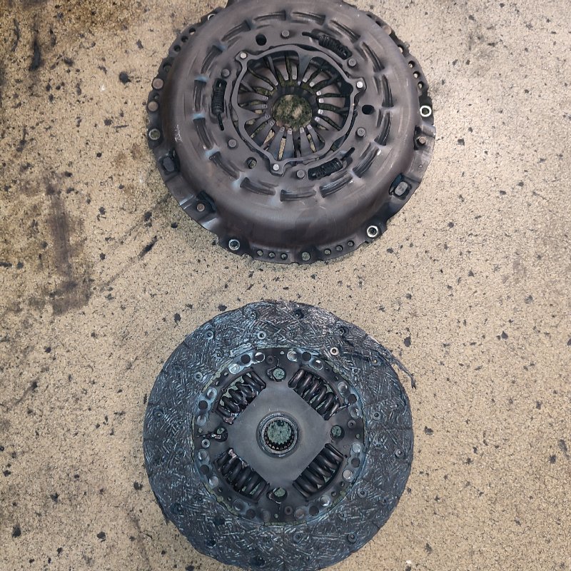

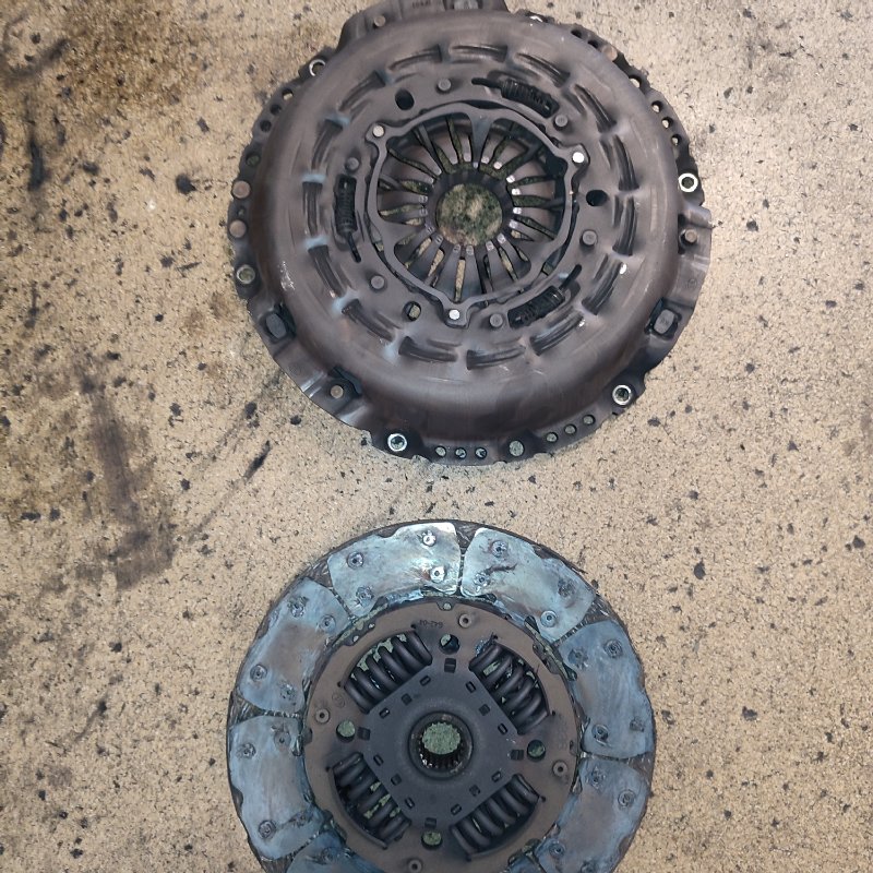

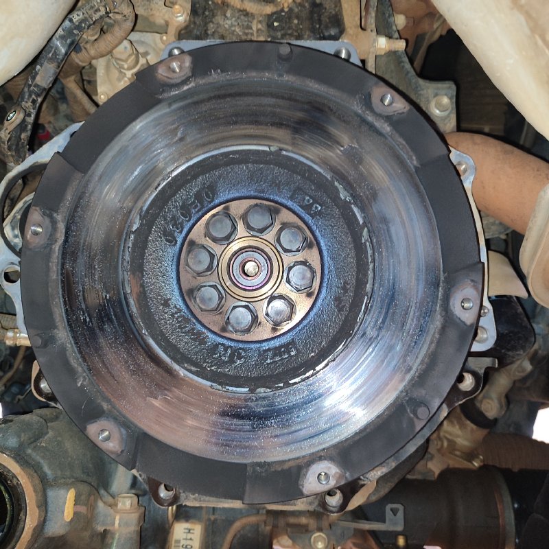

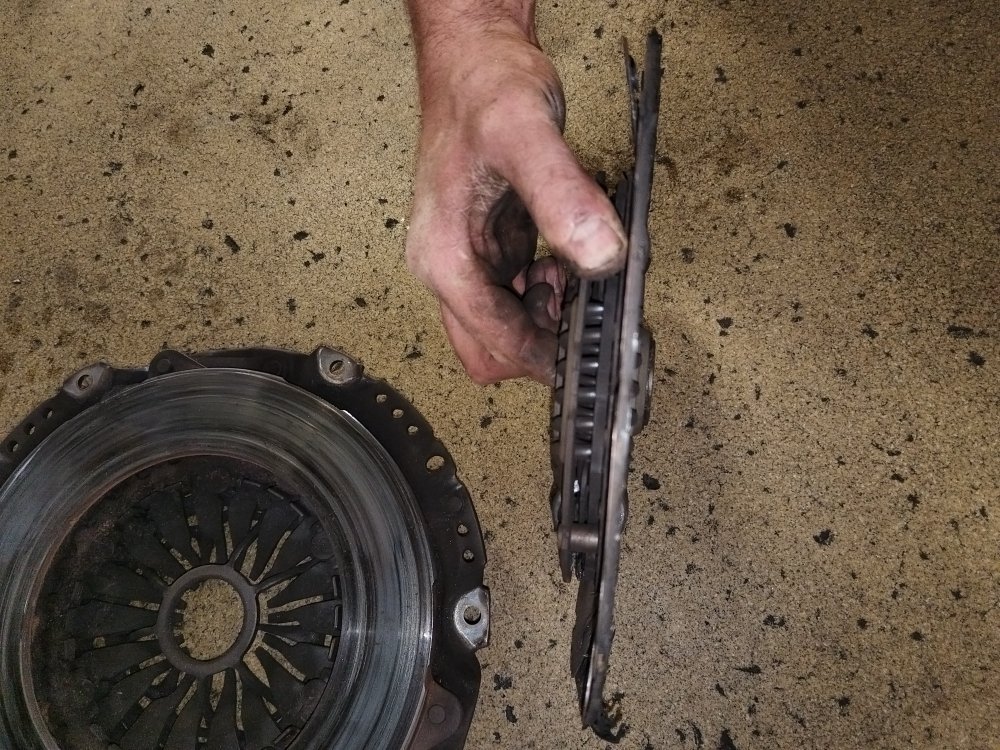

Bogaards
Has thanked: 57 times
Been thanked: 91 times
Posts: 226
Post by Bogaards »
Attached the pictures of the clutch that was removed.
Would appreciated some technical comments/feedback.
Rule #1: Don't let SWAMBO drive. Most women use the clutch pedal as foot-rest
Rule #2: Don't use high range on a slope when towing
Bogaards wrote:
Wed Feb 22, 2023 3:12 pm
All I can say is goeie mur. Never seen one that bad.

Will try and get some input on off-road driving practices with regards to the clutch. Sometimes there is no other way than to use it.
I should maybe point out that for the last 100 km of its life it was slipping every now and again between 2500 and 3000 rpm. Suppose that could contribute to the final look?
I'm a little concerned about the sudden failure. That clutch and pressure plate sure look like you went and towed the trailer through Baboons pass.
If you only drove gravel......something else is wrong. I would say ask Toyota about the slave cylinder and the adjustment there. The slave is a standard external slave cylinder, check the adjustment on the rod and also check the pedal travel adjuster at the pedal box.
