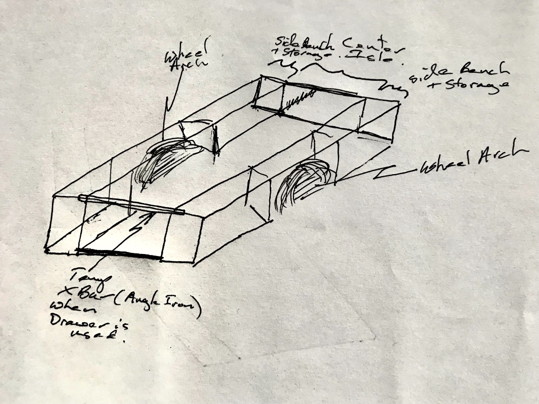

Shane,
Rather do it like this:
Two side Bench structures to wheel arch height
... with storage underneath ( water, fuel other etc)
Then keep center Isle versatile :
either empty for access
or a removable drawer or slide
Then an overlying easily secureable platform
of 3 sections: 2 side bench platforms
& 1 center isle platform
then just have two drawer slides
either side of the center isle
such that drawer can be inserted
or removed completely .
Have single additional removeable cross bar
of angle iron for better frame rigidity if necessary .
This is what I'm changing my set-up to.
My bin is approx 165*165cm ...
and my 2 side benches will be approx 45cm wide
and center isle 75cm wide .
To better utilize vertical canopy volume
my rhs bench structure will support
a 3-level shelf system (not shown)
that will be accessible from Gull-Wings ...
or from inside ...
Drawing perspective from rear RHS ...
