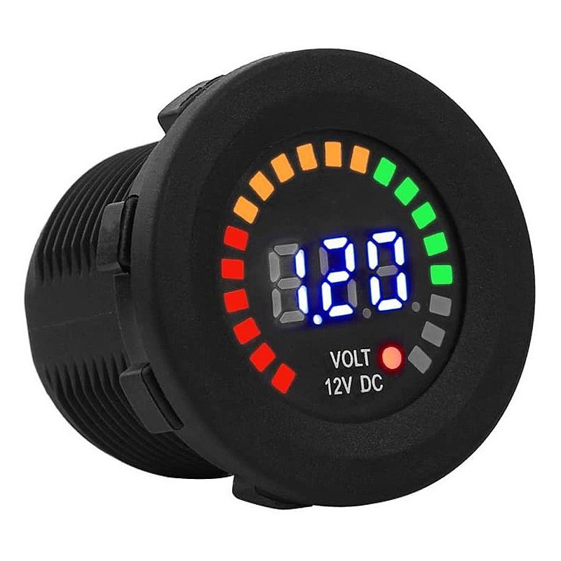

I'd also have a battery monitor so you don't over draw.
LUMENO USB.jpg (6.58 KiB) Viewed 5645 times

Good call on the USB and volt meter. I'll add that.
