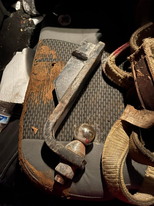

They were doing a snatch recovery with a static rope attached to a dropped toll ball.
The bonnet wasn't open.
There was no soft weight on the rope.
He was up to his axles in thick mud.
It was going to end badly regardless.
Just a pity it ended as badly as it did...

Just looking at the pics and seeing that the lowered tow ball hitch (adding more leverage to the forces), one would think that someone should have seen this accident in the making (tow ball bad on its own, but on a hitch like this it is x10 worse).
Really really sad. RIP Ryan

Truly terrifying to note the amount of force required to pull a vehicle stuck like that one, and where the weakest link eventually was.

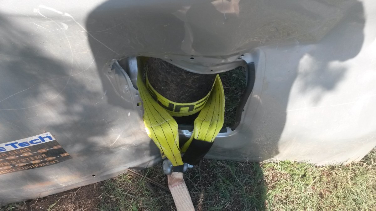

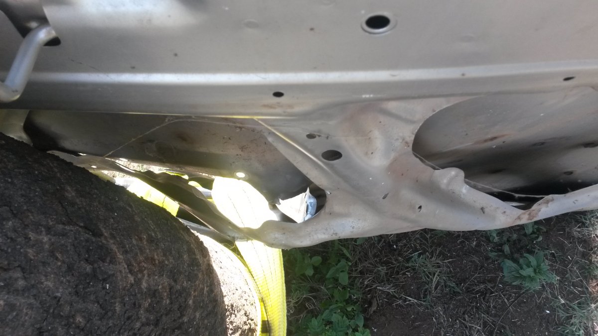

I see there have been a few comments on this on the dirktatorship forum saying things will have been fine if the bonnet was open. I sort of say possibly.
The following few images were photos I took of a failed snatch recovery demonstration by SecureTech (I think) for the Nissan club many years ago. It took a few attempts to get the effect they wanted. It was basically a few "failed failed snatch recovery" demonstrations until they could get the shackle through the bonnet. So the photos of the dents are the photos of the shackle failing on one of the failed demos. The other photos will show where the shackle went straight through the bonnet more-or-less where the intercooler vent is.
This was just a normal shackle. A piece of the towball / towbar / towbar drop plate etc would obviously have much more momentum.

If the bonnet was open, Ryan would probably have survived, but that tow bar would have wrecked the bonnet and probably have broken the windscreen.
It went through windscreen glass
buckled a steering wheel and still had enough energy to kill him.
So it would have still been a disaster, just a non fatal one...

Manny - yes - he possibly would have survived. Still, it is a moot point. My point being that even following best practices, one underestimates the forces and momentum involved in these things at your peril. I will perform snatch recoveries when I really need to. But I prefer other options when they will work.
It is the same with the hi-lift jack I lug around everywhere. In cases, it really has it's use. But I treat it with respect. It scares me. Snatching is the same.
