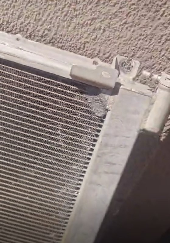

- My alumminium radiator was made 5 years ago, and I was told I should get at least 10 years from it. Only once back did it start to leak.
Small leak, bit none-the less, disappointing that it had to get fixed this soon.

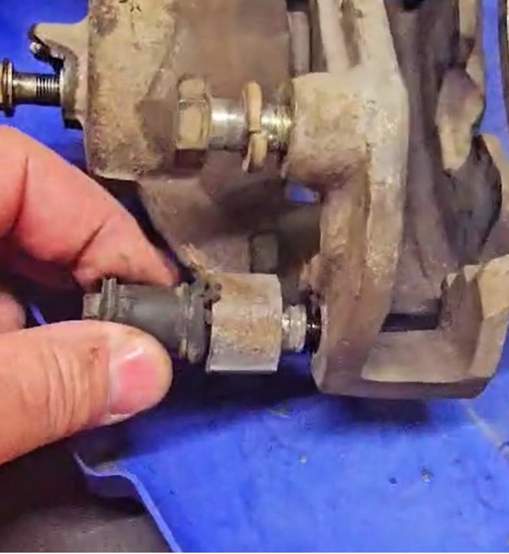

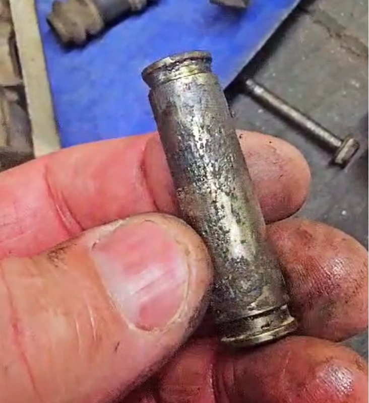

- Calipers - the slide pins jam up from old rubber seals gone, starts to let water in and rust

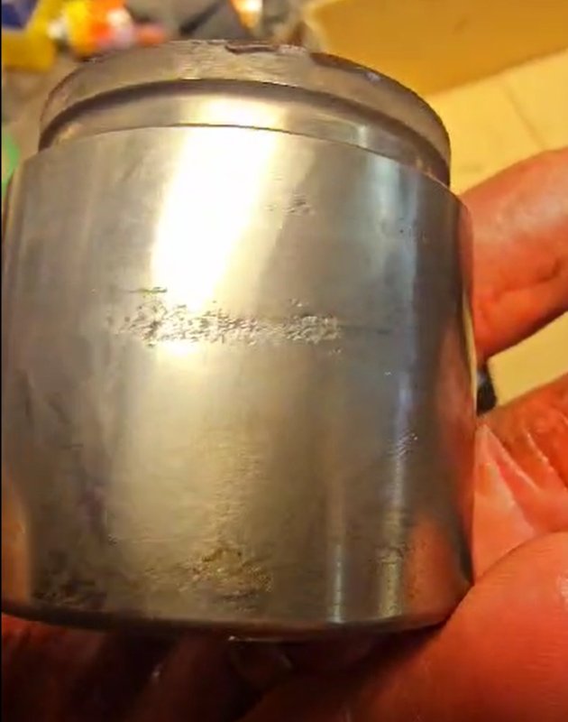

- Calipers (again) - cylinder ware, then start to leak break fluid and allow corrosion in

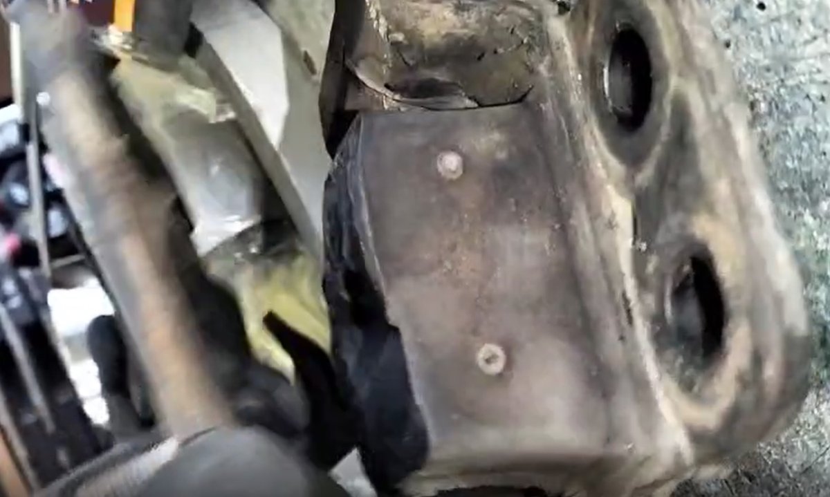

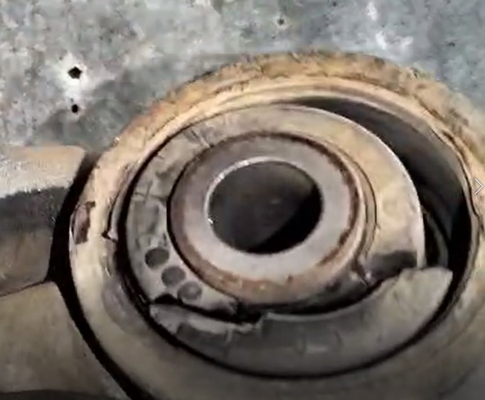

- One engine mounting (typically left side for the inline 6 engines), completely snapped in half.

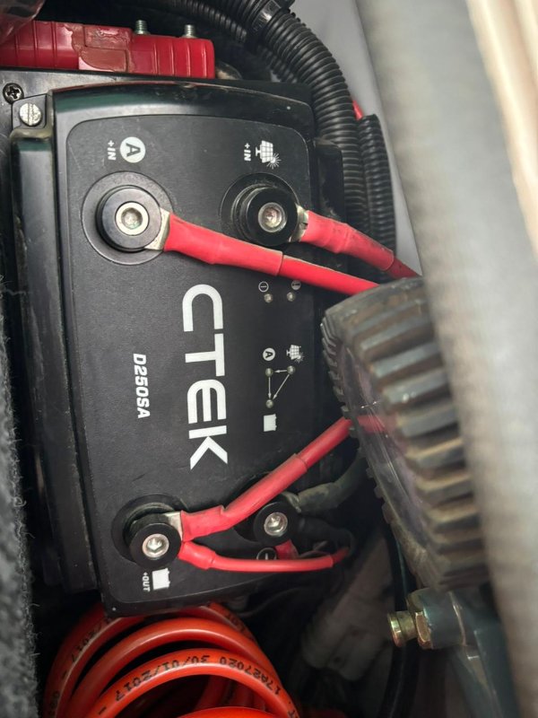

Oh, and my CTek stopped working on the first day of the trip.
Fortunately, I could bypass it so that the alternator charged both batteries while driving, and split the batteries again when not driving.
At least this was also fixable.

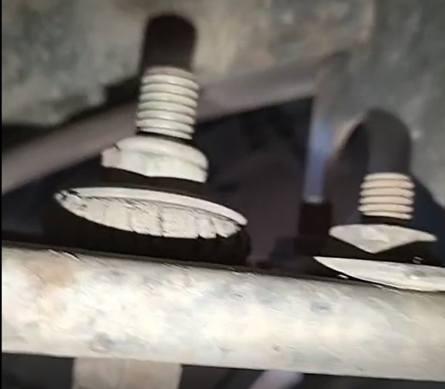

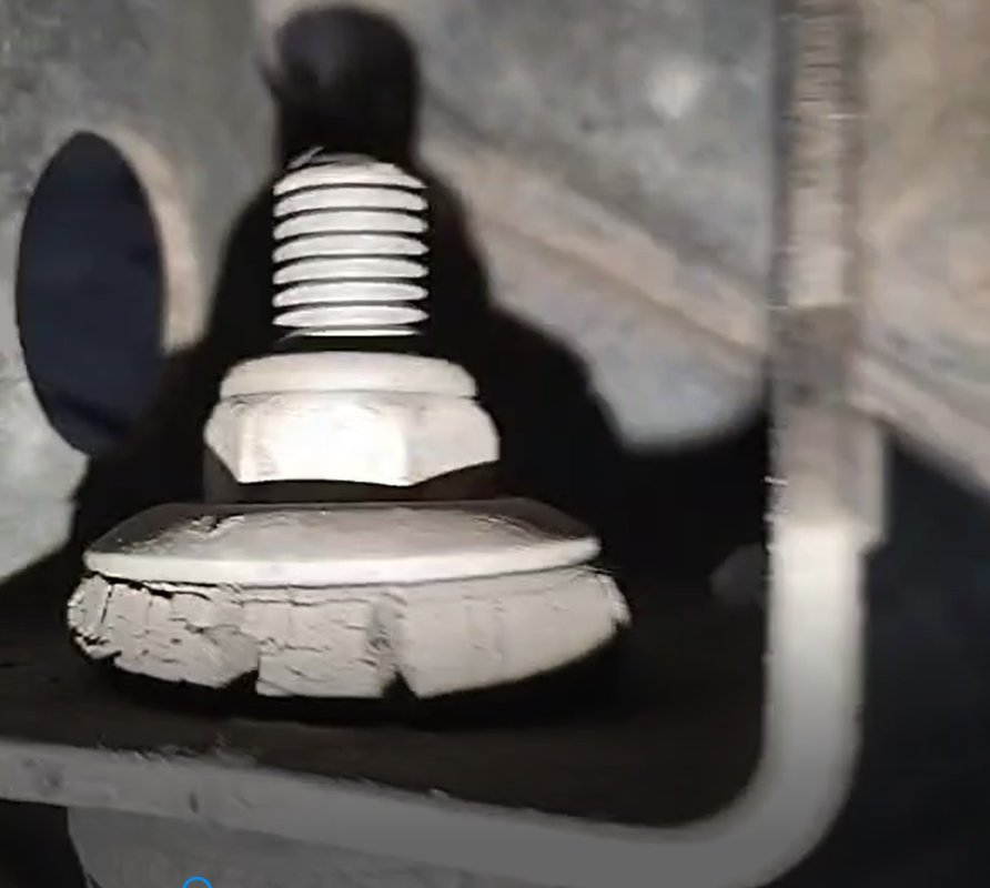

Sway bar bushes mangled:

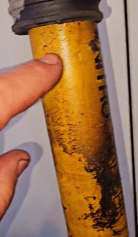

The Caliper cylinder that pushes it in and out. They were badly worn, leaks break fluid out and allow corrosion in.
Caliper has slide pins which have rubber seals. Seals tired.
Then they start to jam up, causing the break shoes to ware unevenly.
Lots and lots of bumping up and down on sand roads makes for shocks to go tired quicker.
And after getting home I learned that my radiator started to leak. No issues on the trip. It was a slow leak. But still, dissapointing that this started to happen after only 5 years of duty.
I did not know that engine mountings can break in half like this.

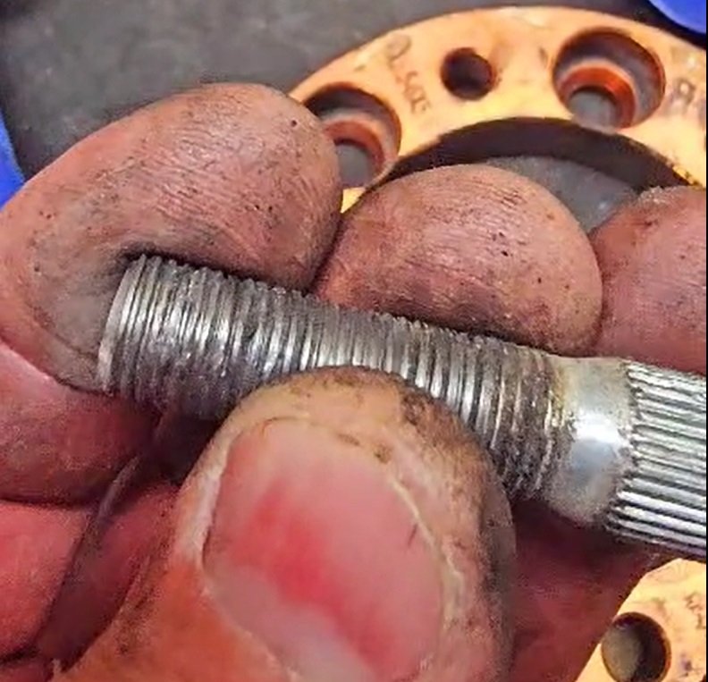

Stud threats that were apparently too tight, eventually they will fail and let the wheel go:

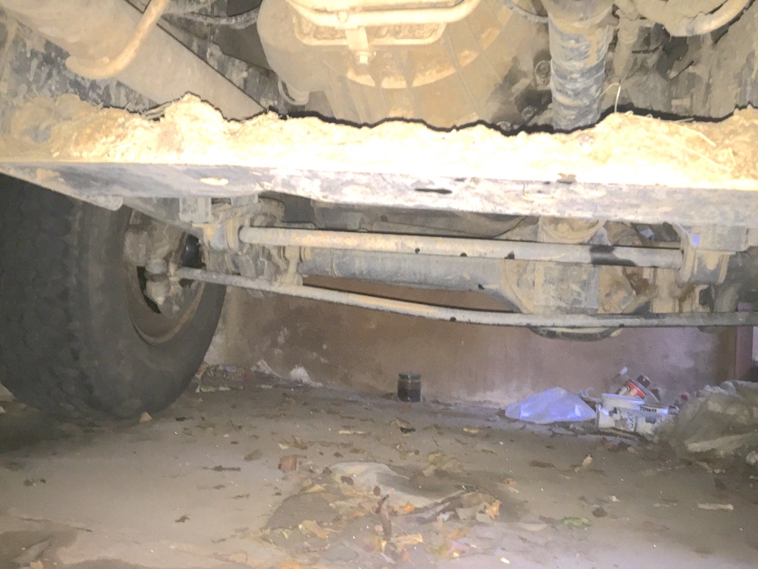

... a month or 2 back we popped down to the E Cape and stayed on a coastal farm between (nearby) Kleinmonde and
Port Alfred. ( Conveniently there was a shortcut dust-road straight inland to the Pig and Whistle in Bathurst !)
Anyway , to get back on topic, on our way back N we stopped for one night at the Hogsback hotel before heading N again
and opted to travel the R351 backroad from Seymore to Whittlesea which includes the treacherouly steep and notorious Katberg Pass ascent ...
We slept that night in Queenstown before rejoining the main route back to Joburg.

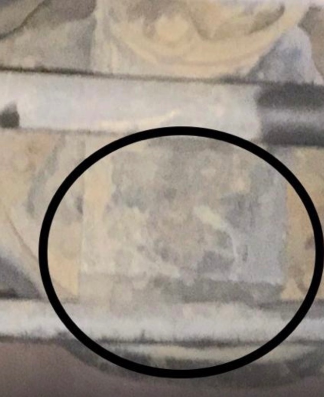

I then noted some steering play & wandering and on investigation I found that the trackrod (behind the front Diff) was seriously bent.

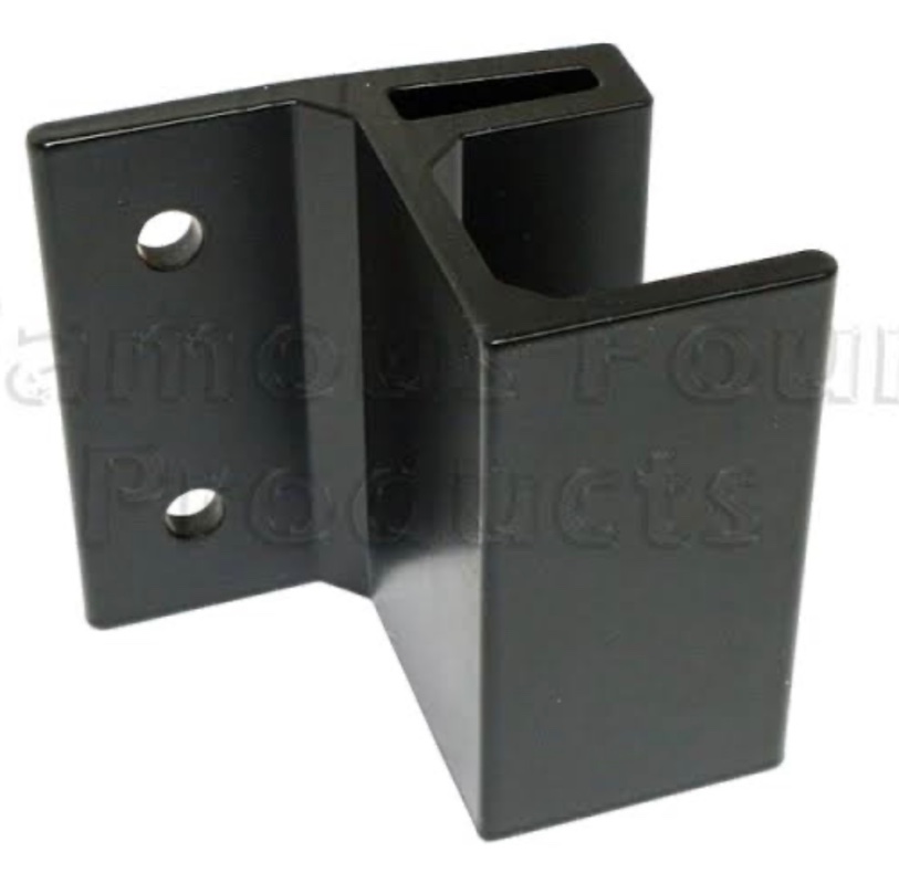

The 3rd picture depicts the very heavy duty
rod protector that is standard on a defender; its open face is towards the rear of the front diff and the 5mm channel steel serves to surround and so protect the trackrod
The 2nd picture shows the warped rod
that, after Katberg, passes right UNDER (!) the protector !
( ... cant really explain how it managed to get there!)
The 1st photo looking from the rear is very feint but the outline of the protector can just be made out.
That standard trackrod was about 16mm in diameter
... my new heavy duty one is about 32mm
and I think its made of sterner stuff...
