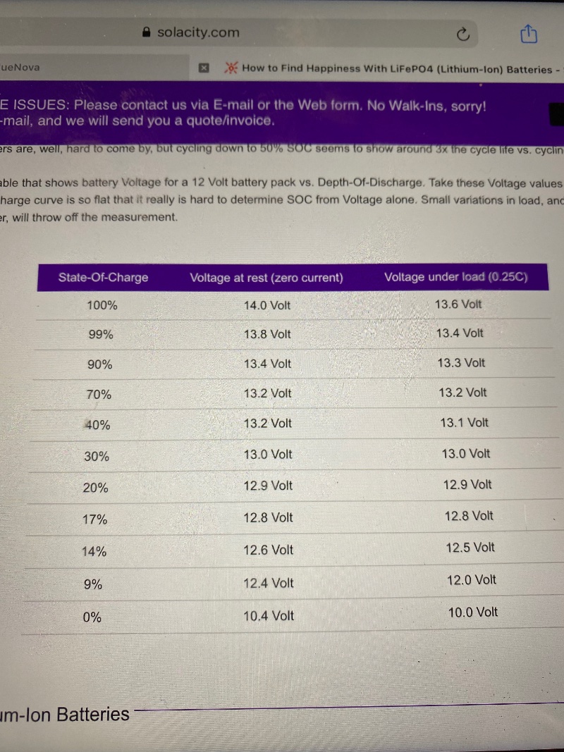

The other difference is determining the state of charge of lithium batteries. You should have a fancy shunt(I think it’s called) installed. Just monitoring voltage of the battery only gives you an indication of capacity. I have attached a table that gives an indication of state of charge. Note that from a voltage reading of 13,2v you have 70% capacity left and then it drops quickly from there.
As for charging, lithium batteries charge super fast if being charged with the correct charger, being alternator, solar or ac. Basically they “ take” a charge very quickly. I do think your panel is too small to replace the usage of a fridge long term. When charging off the alternator my battery is absorbing 25amps so generally after running 90 -120 minutes it is fully charged.
