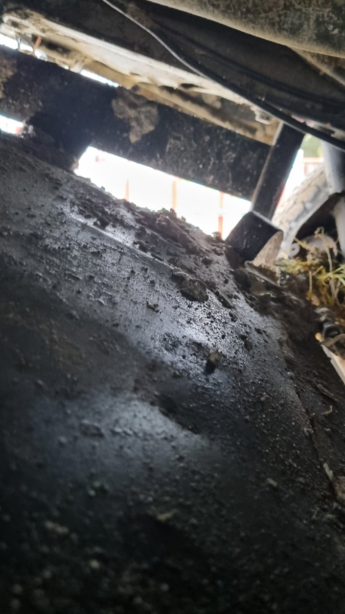

Monday 17 May morning we removed the dead starter and my one guy removed all my skid plates to reveal alot of Mud stuck just above where the skid plates were.
On the pics you can actually see the abuse the one front skid plate took bent backwards
From being the lead vehicles and in a rush hitting holes and jumps.
Again I instructed our cleaning guy to get stuck in and pressure clean again.
Pictures attached tell the story.
So boys and Girls the wet season in the salt pans is no playground for a volksie bus unless you want to make alot of work for yourself.
Thanks for our group kamaraderie sticking together and helping one another with challenges as that is actually what makes the trip Special.
I'm busy going through my bus prepping it for the next adventure and doing few upgrades
Over and out

Thanks for your reports and photos. I suppose the moral of the story from your last posts is to stay out of the mud. As much fun as it might be to go spinning and drifting in the salty mud, it's going to cause you lots of work to get it cleaned off and stop the bottom of your vehicle rusting away.
The humble person makes room for progress; the arrogant person believes theyโre already there.
- Has thanked: 148 times
- Been thanked: 264 times
- Posts: 1264
Correct to say fun when you drifting in the mud but causes so much unnecessary headachesPaul#25 wrote:Thanks for your reports and photos. I suppose the moral of the story from your last posts is to stay out of the mud. As much fun as it might be to go spinning and drifting in the salty mud, it's going to cause you lots of work to get it cleaned off and stop the bottom of your vehicle rusting away.
If you look at the picture of the Brand new starter installed 5 days before the trip how rusted it is
That alone tell you a story
Other important fact is to drive a casual speed without pushing and damaging your Vehicle
