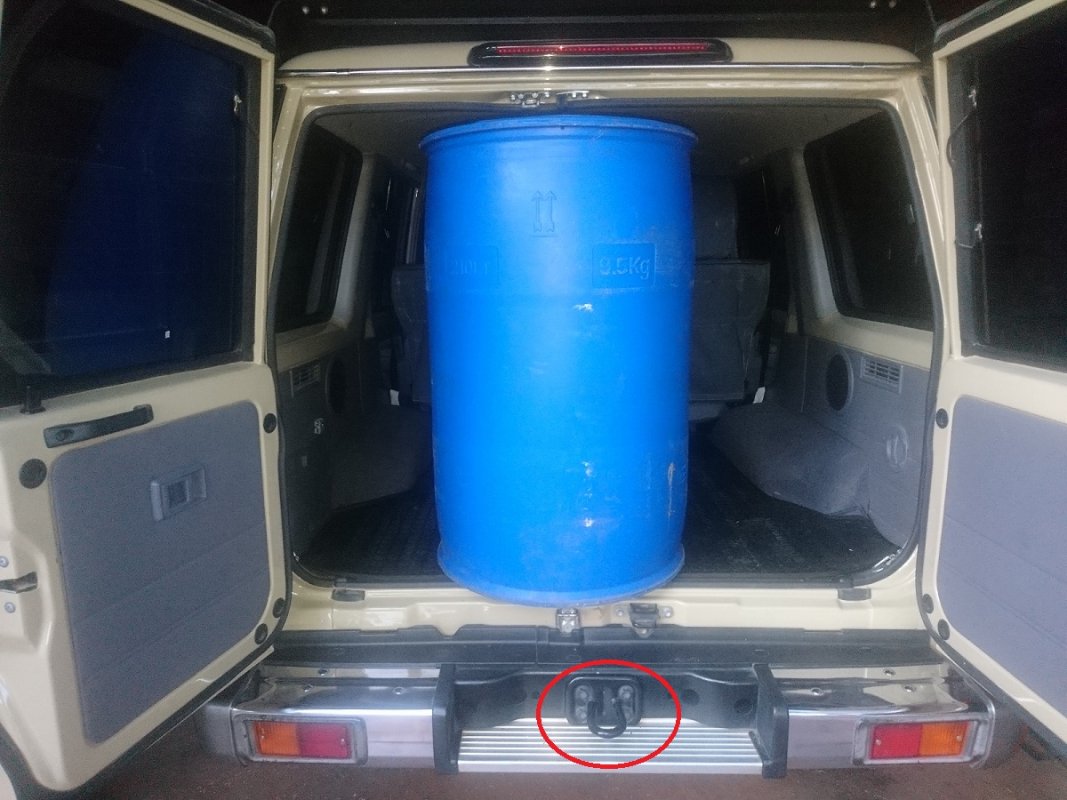

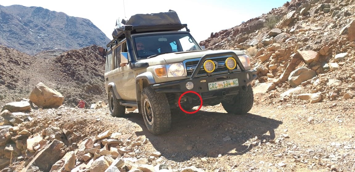

Cruisers have OEM recovery points

How do we know that the recovery points aren't rated?
I got snatched on the FJ a few times and that recovery point didn't budge, so I guess it's strong enough
