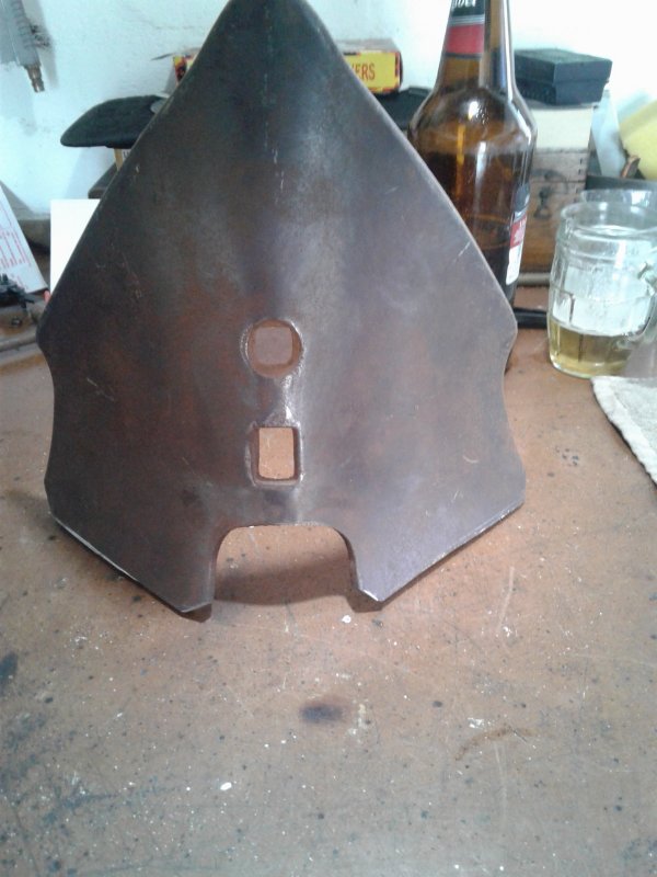

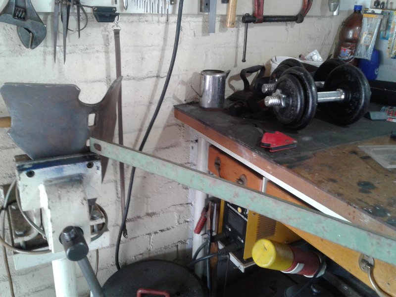

Good Evening.
I got hold of a plough blade thingy and I want to make a sand anchor. How long should I make the bar connecting it to the plow blade?
And at what angle so that the blade pull itself into the sand. I want to connect the bar to the round hole in the plough blade.

Hey, those barbells in the background would make a good sand anchor as well!
But in all seriousness, i don't think there are any theoretical considerations with a sand anchor. As long as possible, as short as is needed to fit in your vehicle. If you make it close to pictures of sand anchors you find on the internet, you should be good.
Good luck!
Good luck!

That anchor isn’t going to work at AD if that what you were planning.
Rather bury your spare & winch off that.

That one there isn’t going to work in soft sand. But you’ll never use it anyway. So it’s unwanted weight & another thing in the back.
We seldom winch in sand. Your mates will get you unstuck much quicker.

Agree with XJ Junkie 100% If there are going to be any other people around, a sand anchor is a waste of space.
I'd only bother if you're going on a solo trip into the sand, and/or have an academic curiosity if sand anchors work.
Good luck, have fun.
