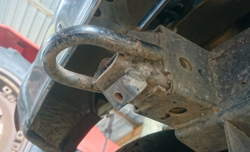

Jeanvn wrote:Image
Chris I have one of these on either side, using a bridle I wouldn’t mind doing a snatch off of it.
Those get used plenty. Not bad, but not for an extremely violent pull, mainly due to those bolts that can sheer. Those hooks would be a direct swap but with better bolts.
Plus the need for a shackle is removed.
#62
I fit my own aftermarket stuff, Ranging from ARB, ONCA and STofpad. Fitted a Stofpad rear bumber on the 79 Cruiser this weekend.
Have had my share of serious recoveries. Most aftermarket recovery equipment fits to OEM bracket or bumper attachments.
I am not convinced that theses attachments can handle frequent snatch attempts during serious mud bog downs where a 4x4 are sucked down.
To be honest I would not allow anyone to do a snatch recovery on any of my 4x4`s without me inspecting his recovery points.
Snatch ropes work with light to medium recoveries. After ruining my rope in a mud recovery two years ago I have no urge to replace it. Most recoveries can be done with a strap or sling. Far less impact on recovery points.
I have seen a 20mm steel recovery point being tore out of a Ratel with a kinetic rope. Also a G60 Patrol with a failed chassis.
I think very few of us realize the impact of recovery on recovery points and our 4x4`s

Jeanvn wrote:Image
The guy I bought my hook from said to rather use the Wrangler bolts. They are very good.

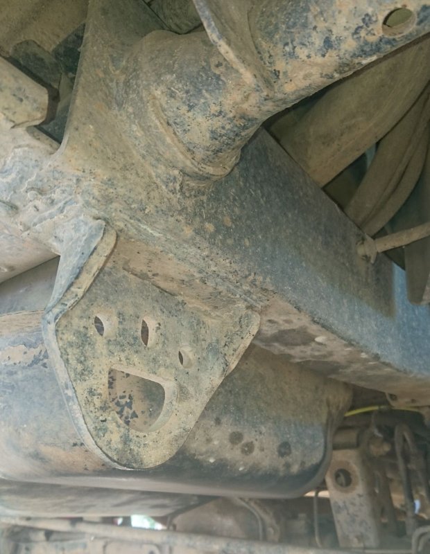

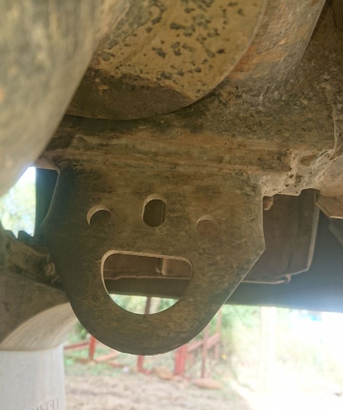

#75
Post by Prof »
Now would these points be ok? One on each side.
Front
Back
