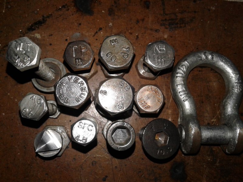

Rating - this indicates how strong the item is and what loads it can take before it breaks. Shackles have the letters WLL on them. I think it is Weight Lift Limit. There is a safety factor as well, X5. It can take 5 times the weight that is on the shackle.
Bolts are also rated. I don't know much about bolt's and won't discuss bolts. It would be nice if someone that knows about bolts can open a thread and educate us. Here is a pic of bolts and the lettering on the bolt heads. There is a shackle as well to show the specs. There is also CE on it. I think that indicates some standard. European standard?
