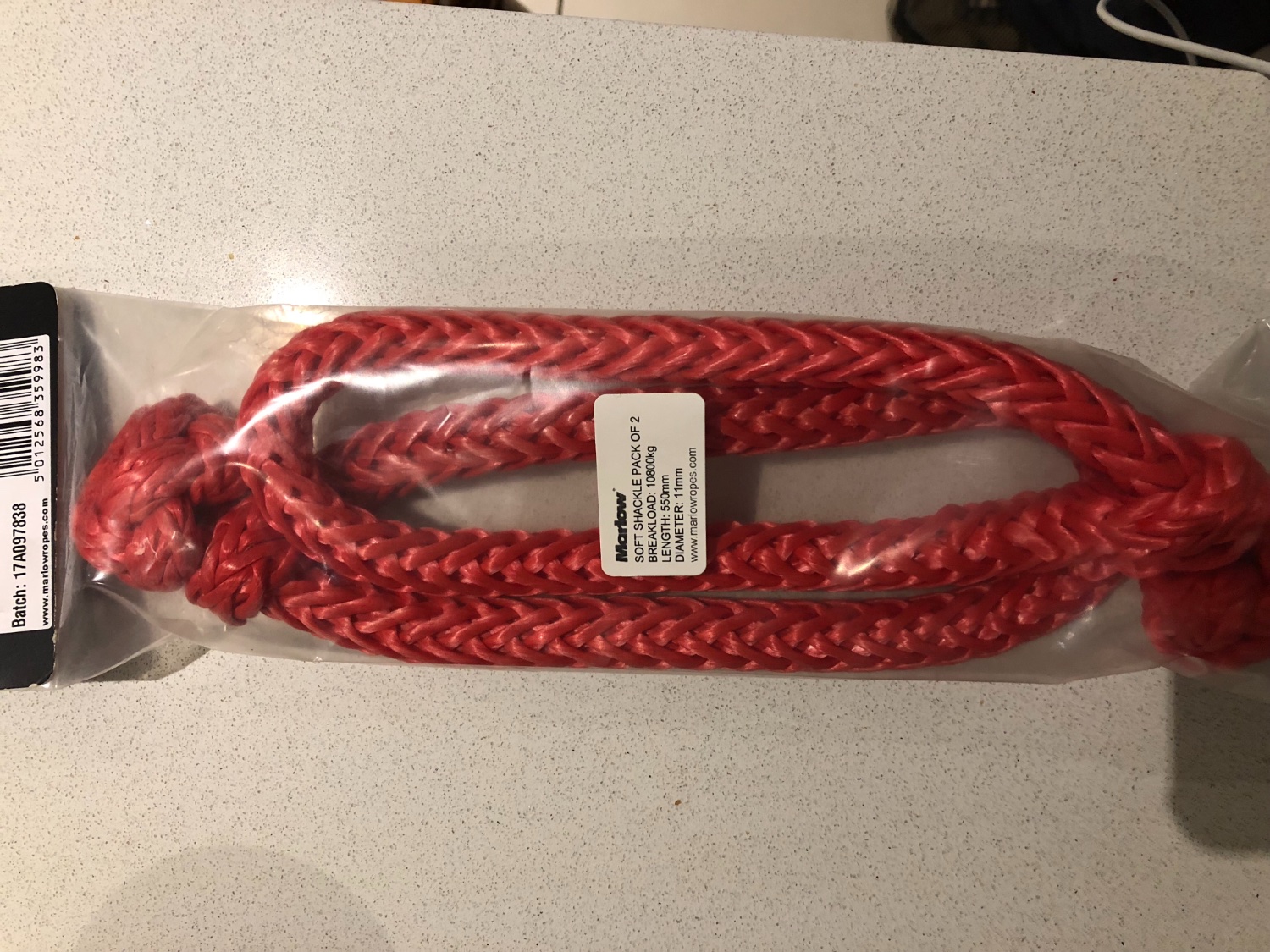

Soft Shacles. This one is rated at 10800kg’s
Anybody here use them before and that could give some insight?

Those soft shackles, how are they on sharp corners?
Very interesting though.

Chris Stoffel wrote:
Thu May 31, 2018 6:08 am
I think that they will have a lifespan much like a snatch strap where you toss them after a few uses.
I got it as a birthday present and have yet to use them. Hopefully someone on the Forum has some experience or knowledge that they could share
They work very well, but sharp corners are not their friend, same as on any other recovery equipment. But there is less of a missile risk if you use these.

Mike Nel wrote:
Thu May 31, 2018 5:16 am
Just remember that this is MBS not WLL, so take this into account.
A 3 1/4 ton shackle will have MBS of around 13 tons.

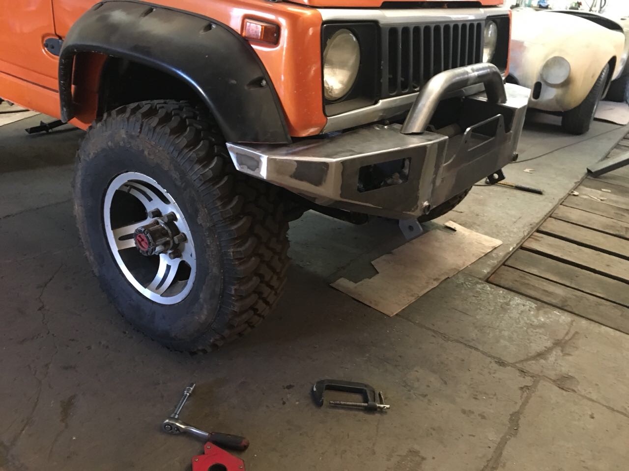

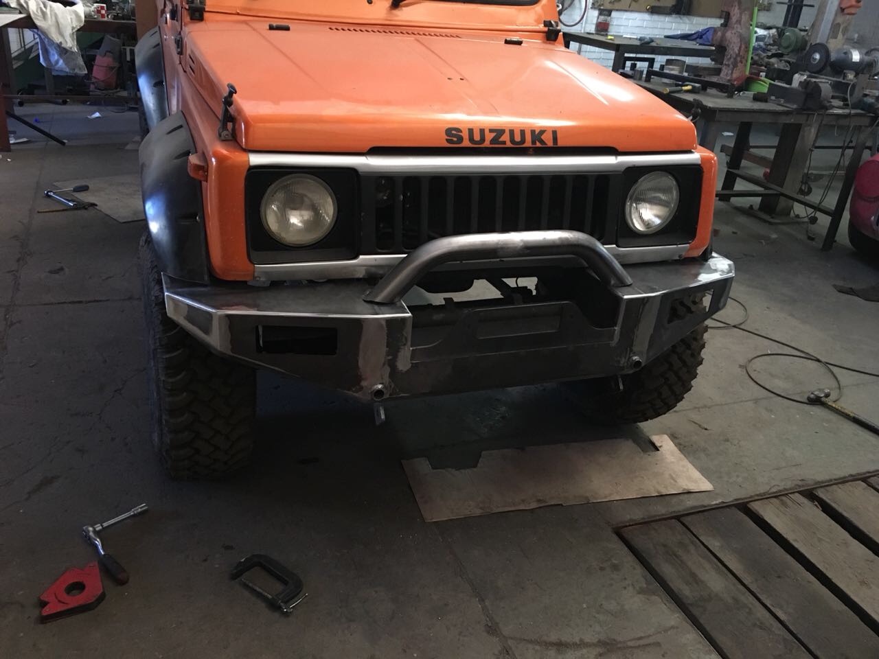

My Tiny
Bottom welded to Chassis
But moving them up higher next to the High
Lift Jacking points
100%.
I’d also trust a conventional shackle more.
