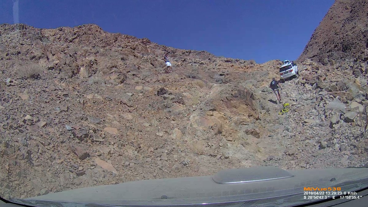

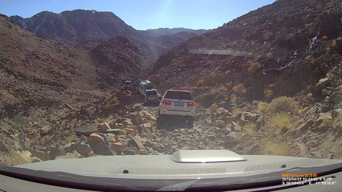

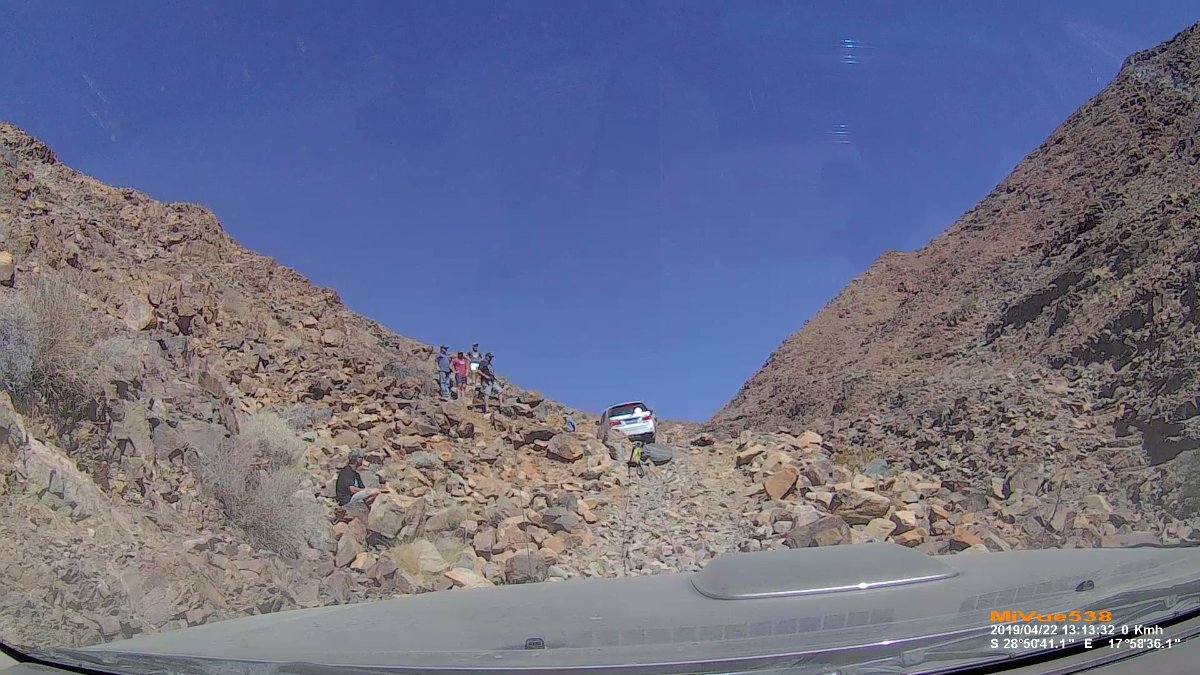

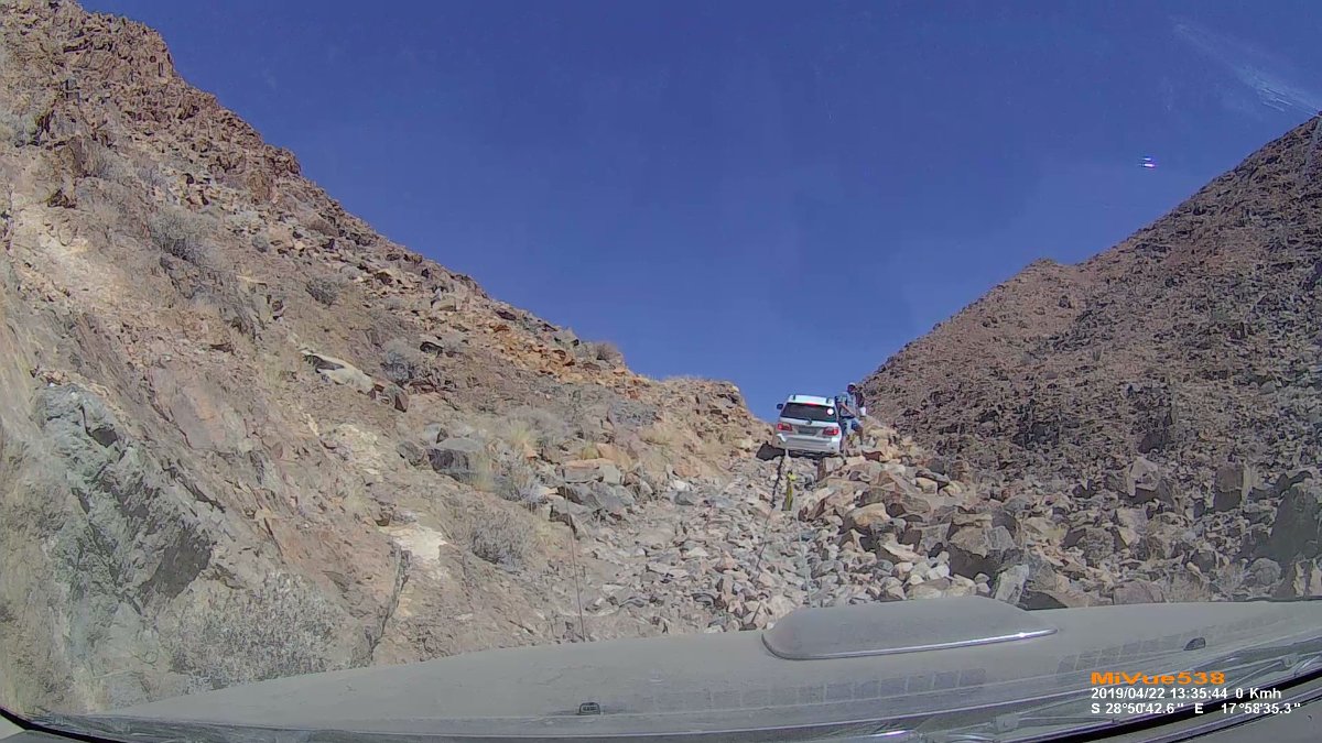

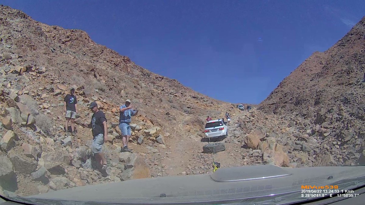

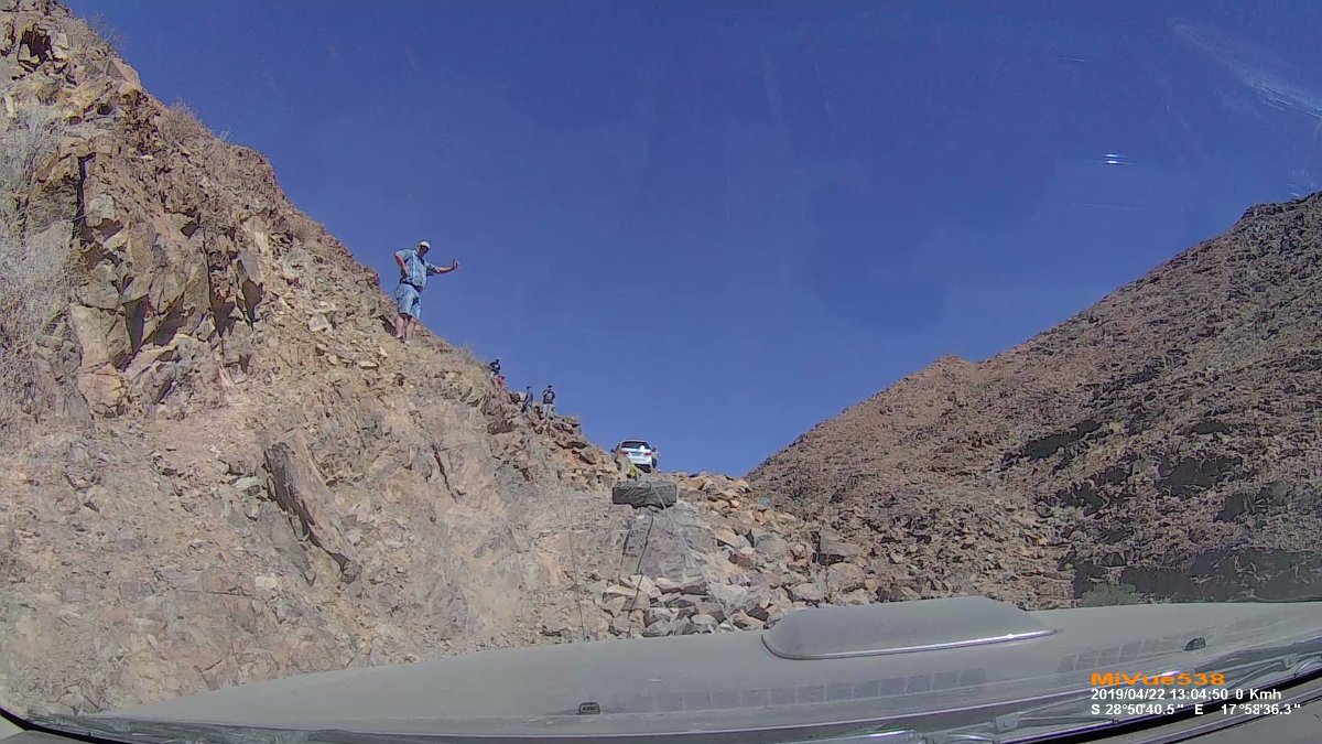

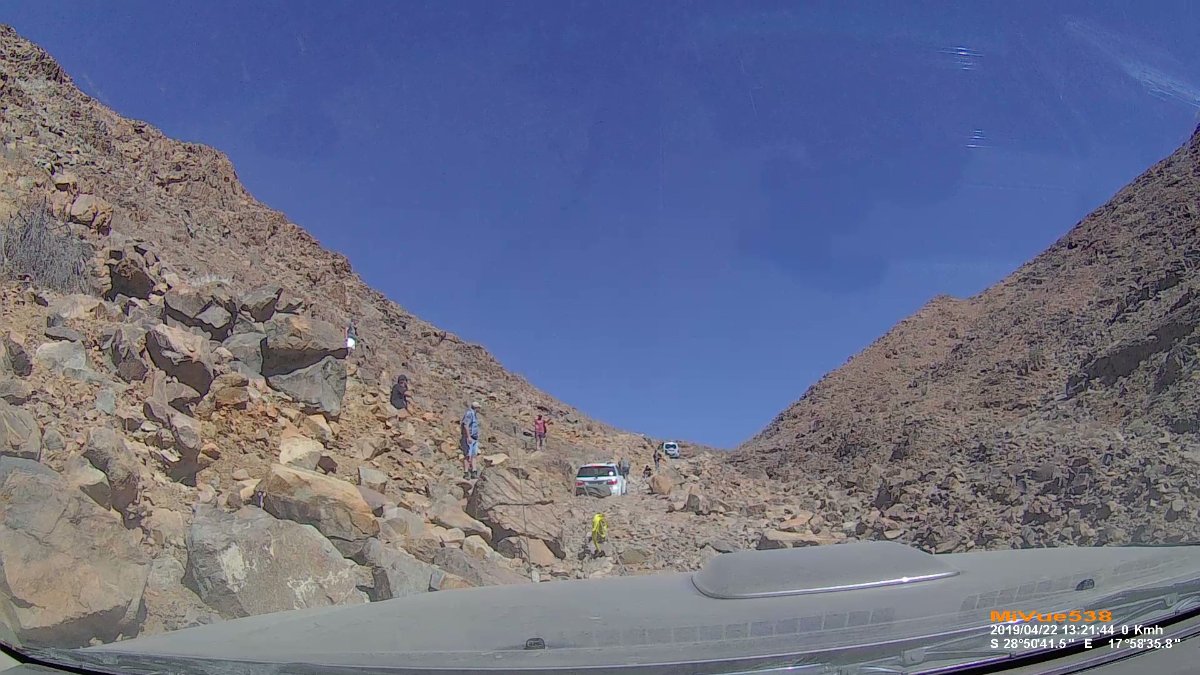

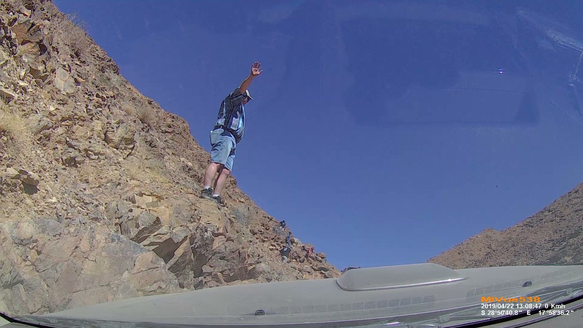

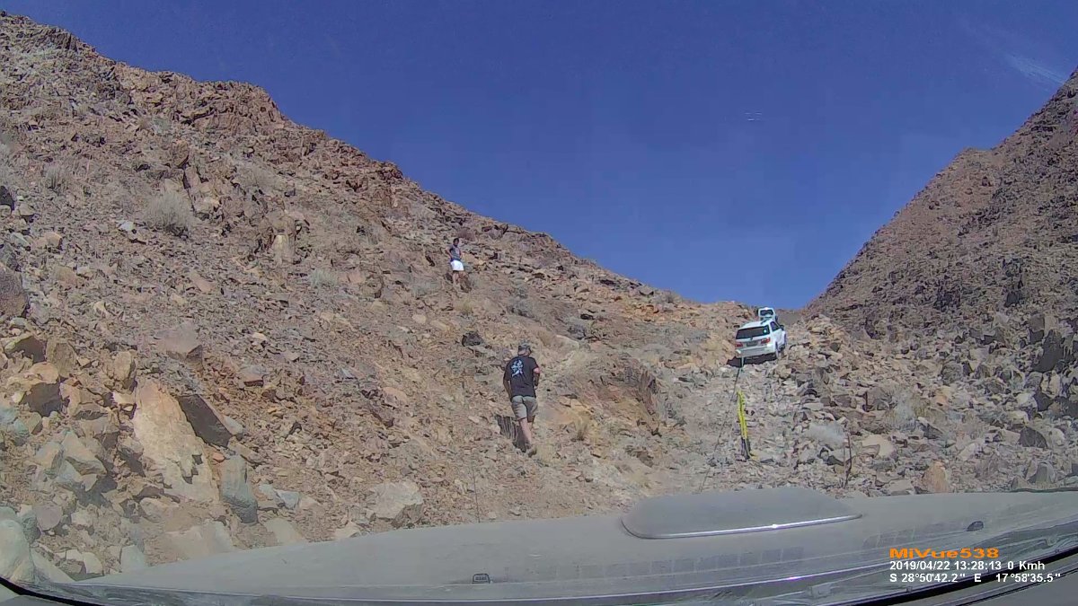

I support your thinking, few people realize how difficult and extreme that route really was, look at these extracts from some of my videos, frozen in moments.
first the angles in reality going down,
and then extracts from the recovery videos, showing true team effort, the amount of energy and effort it took, and the difficulty.
Those that did experience it, this is a lesson to all, 1st you need a strong reliable winch, battery, ( my battery on the day took big strain), its now fully charged and still, showing green, however on the day the battery really worked. fortunately I had a back-up and thanks to Dirk and Pierre, we used the second in series.
