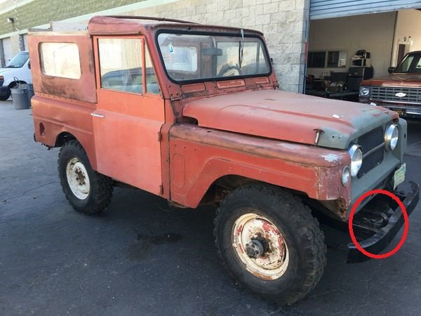

Wed Jul 10, 2019 10:18 am
Apocalypse wrote:there is no such thing as a 'rated' recovery point.
Bingo. Rated at 10000 LBS (circa 4.5t)
The old G60 Patrols came with these fitted OEM up front.
So did the TJ Wrangler but it also had no rating stamped on it.
Posts: 1285
I still have the one from the Patrol will check if it have anything stamped on
