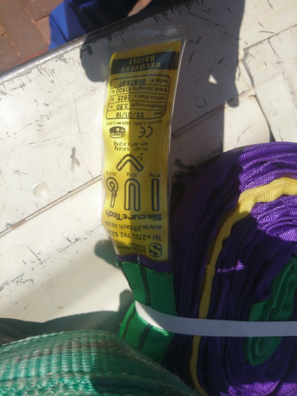

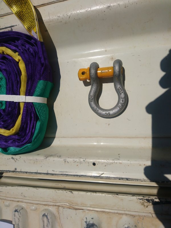

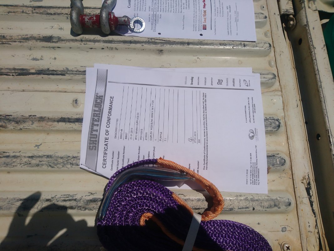

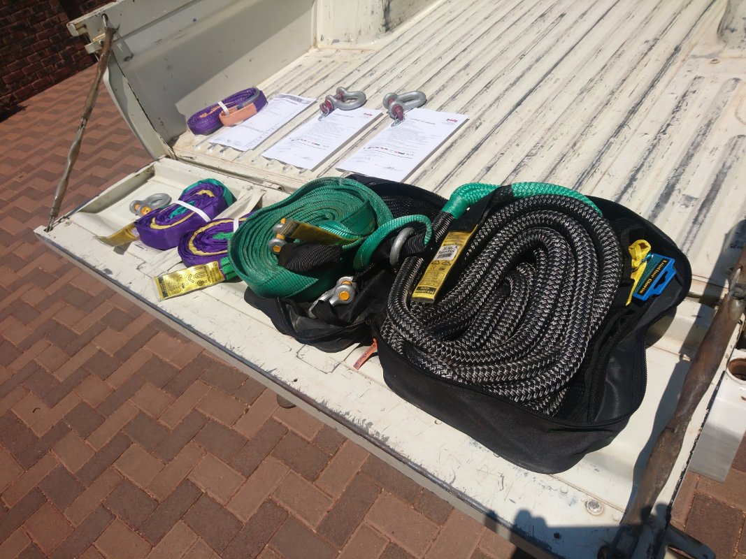

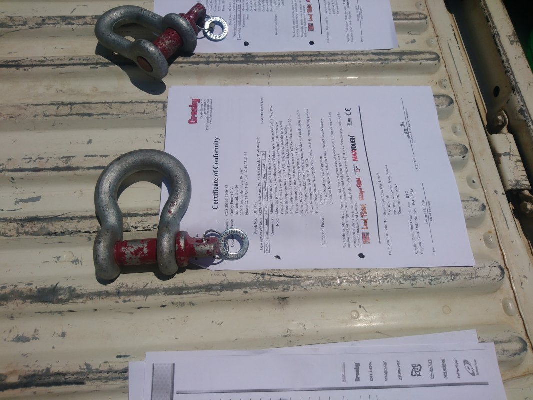

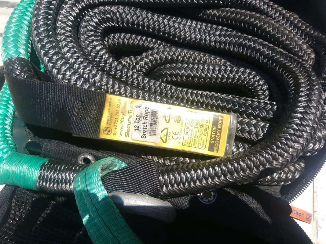

Ok so I did this little exercise this morning. Bought two rated shackles one bow and one D with their certificates. Also a certified strap.
Also inspected my old recovery set of which is little left. Opened my new set that I carry along to impress my friends.
Must say I am surprised with my new set. All the straps, bridle and snatch rope had been clearly labeled. Labels contains a serial no. which usually point to be tested and certified. However the shackles had no serial no. This is worrisome because its origin cannot be traced. So I phoned the manufacturer. He will mail the certificates for the straps, bridle and rope. When I supply him with the serial no`s. Not sure about the shackles.
My old set might be some Chinese knock of as I cannot find any info on it other than its length. Time to get rid of it.
If the supplier of my recovery kit cannot supply me with certificates for the shackles I will replace them rated certified ones.
XJ no my recovery points are not rated. Maybe I should ask Onca, Stofpad and ARB how they rate their stuff. If they do rate it then some of my recovery points are rated. I think they should have test reports to certify their products. See Ironman advertise rated recovery points wonder if they comes with a certificate.
Attached pics of the equipment also the stuff with their certificates that I bought this morning.
Please only use certified or rated recovery gear.
