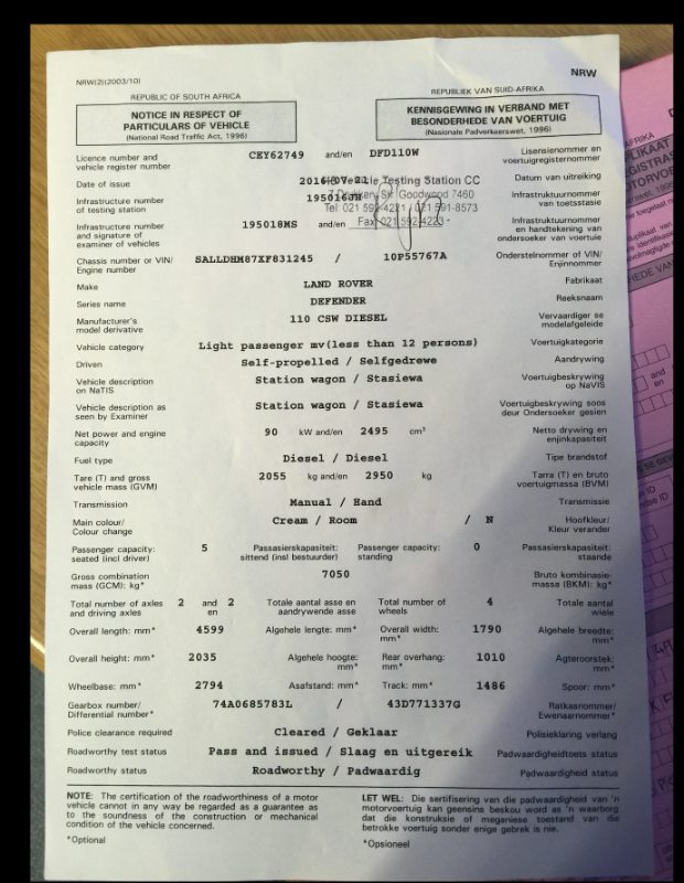

#84

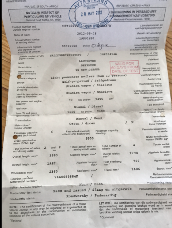

Henri, this is for you.
the main documents what counts
as you can see.
the 110 SW is rated at:
Tare - 2055kg
GVM - 2950 kg (load capacity 900kg)
GCM - 7050 kg (assuming a full load on the drawing vehicle, a towed mass of 4100kg)
(subject to the requirement that any towed mass of over 2055kg (the Tare) has a service brake)
the 90 SW has:
Tare: 1660 kg
GVM : 2400 kg (load capacity of 740kg)
GCM - 5900kg (ie assuming a fully loaded drawing vehicle , a trailer of 3500kg
(subject to the requirement that any towed mass of over 1660kg (the Tare) must have a service brake)
easy enough to meet my challenge for you to post your legal towing mass? or not?
