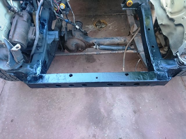

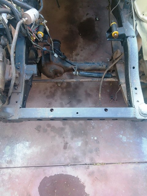

On the Lexus SFA Hilux we did I moved the front crossmember forward to clear up extra space for the radiator.
