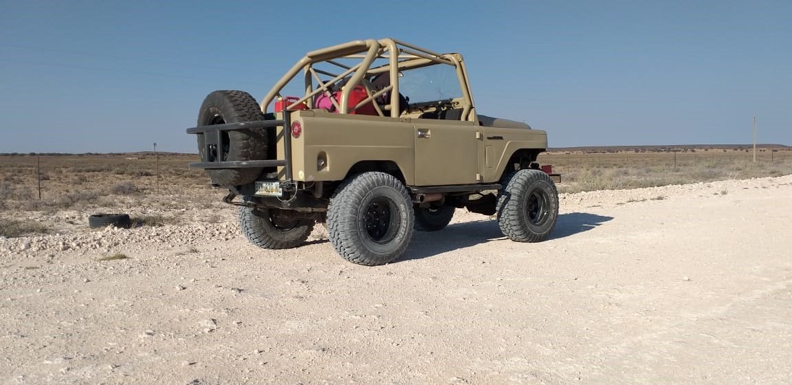

Few weekends ago Little Patrol made it up Langduin Waterford. Few can claim to master Langduin. As far as we know the oldest 4x4 ever up there.
Not bad for a 1965 Model with a 1976 V8 engine with a few mods :lol:

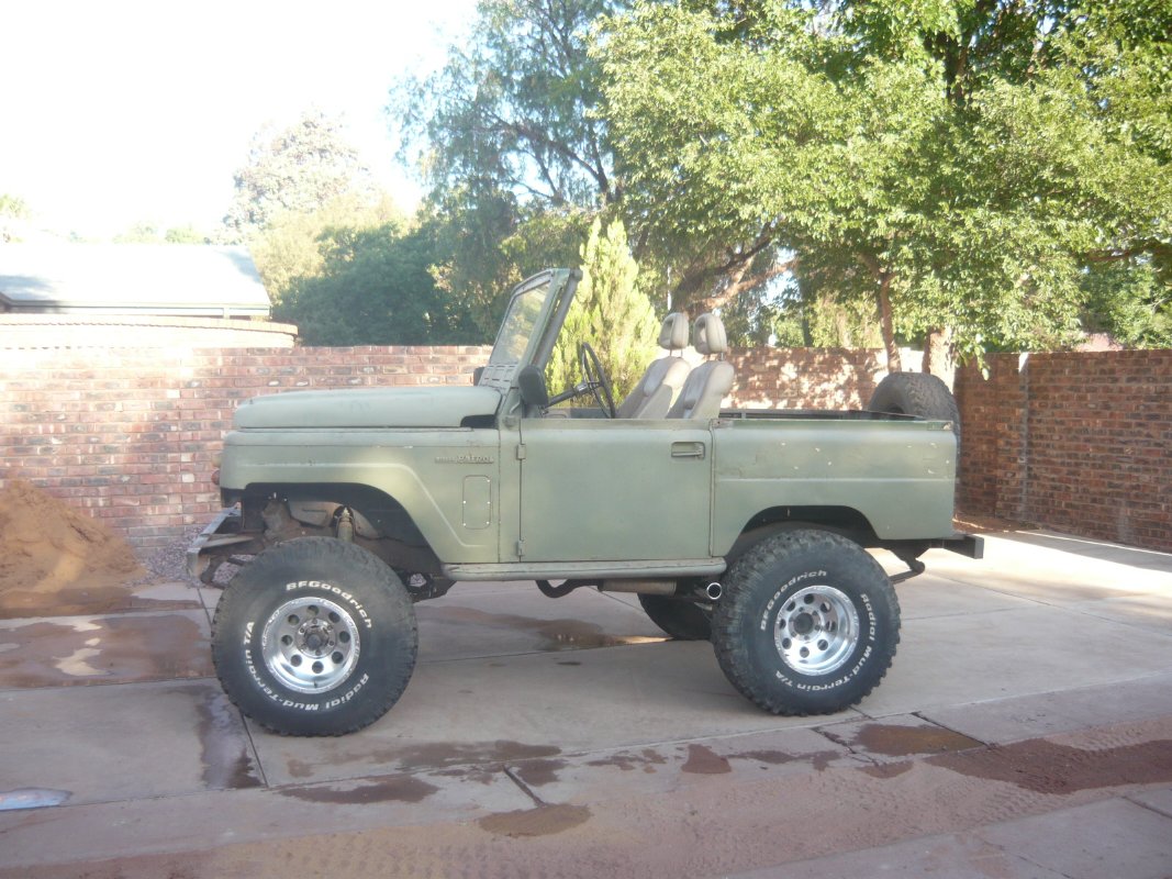

The Patrol in 2013 at the start of the project.

Patrol on its way to Waterford end of JUNE 2019

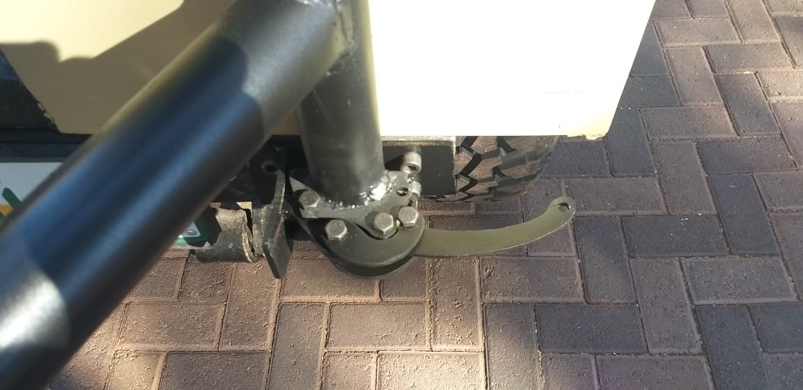

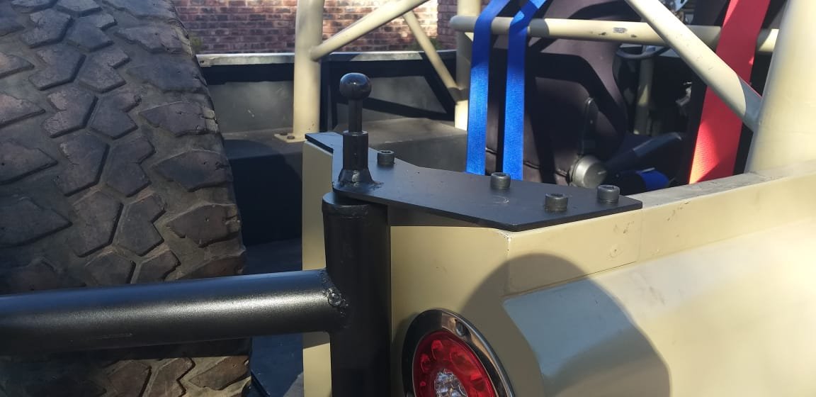

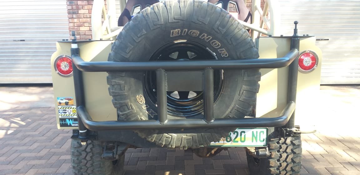

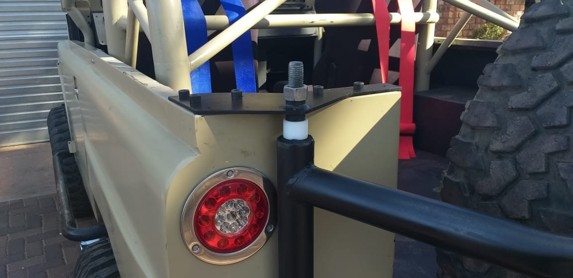

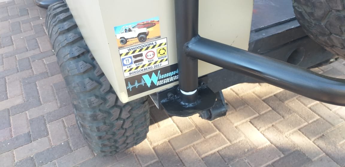

Project Wheel Carrier

grips wrote:Project Wheel Carrier
That is a serious wheel bin
Nice project
Thanks guys. The carrier looks oversized but it is built to take 37 inch tyres.

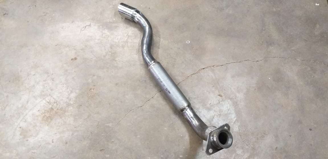

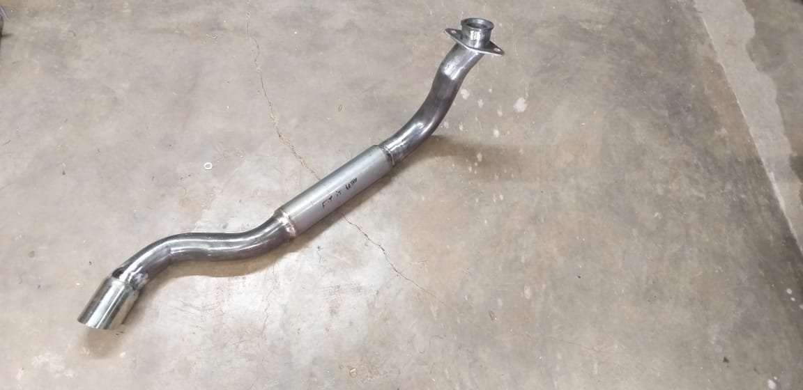

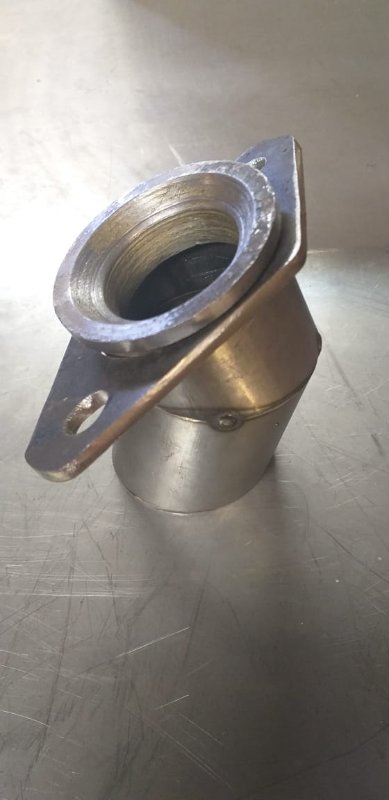

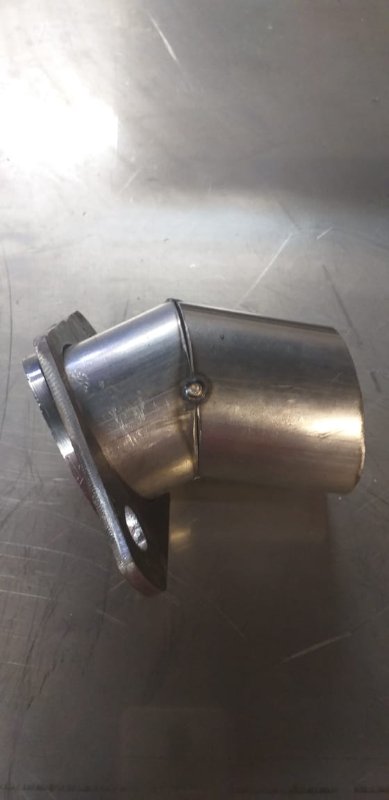

The tale of the exhaust system.
Engine bay of the Patrol is very narrow at the rear where the original I6 engine nestled. Almost no room with the V8 left for proper exhaust manifolds.
When we did the Edelbrock top end kit with the alu heads the stock Ford 302 manifolds stayed on as there were o way to fit proper branches.
Stock 302 Manifolds were choking the 302.
Ignus dug out a set of 351W manifolds and port matched them to the Edelbrock heads. The old exhaust system did not fit the new manifolds.
Now problem two none of the exhaust outlets in Kathu could make the short bends needed to line up with the manifolds.
So Ignus build his own system. :D
When you do not have spares close by, you make them. Ignus polishing his manufacture skillsImageImage

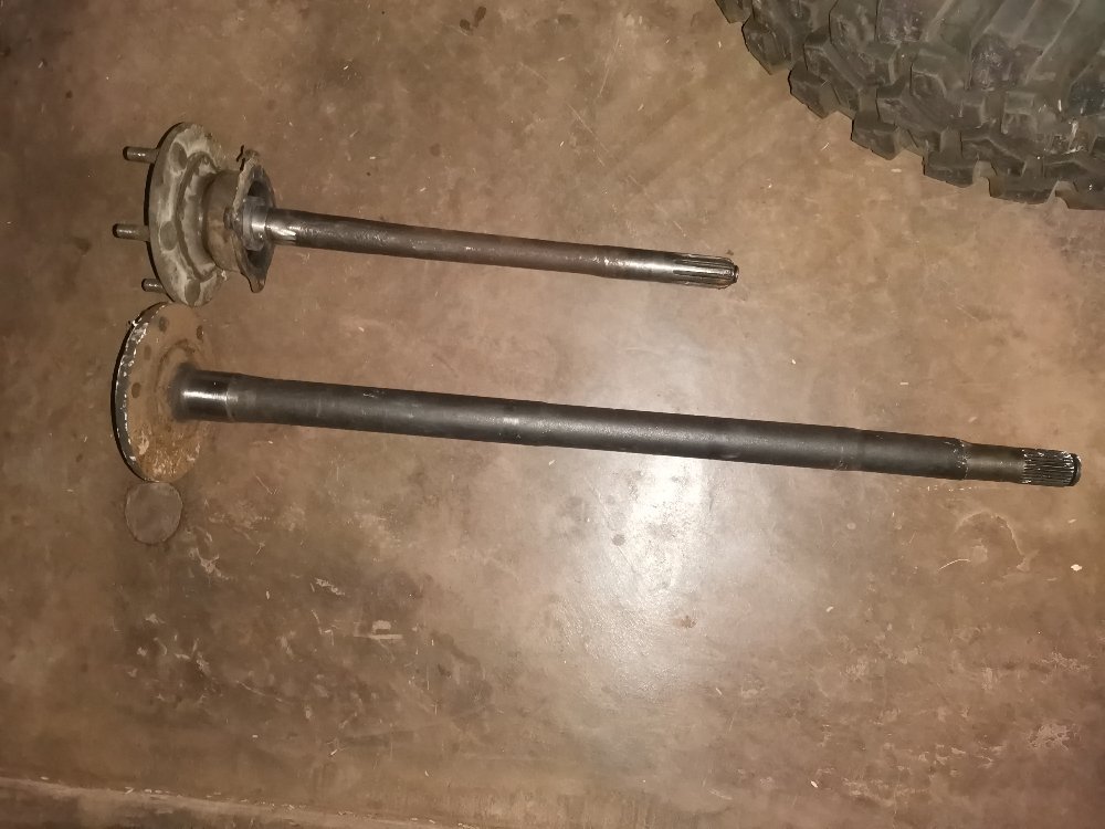

This weekend at Waterford. Bye, Bye rear side shaft. Time to dump the Patrol diffs and go 9.5 Cruiser diffs from a FJ45 or 60 Series.
https://www.youtube.com/watch?v=72TRrSbplcw
Daai kinders breek alles!!!
