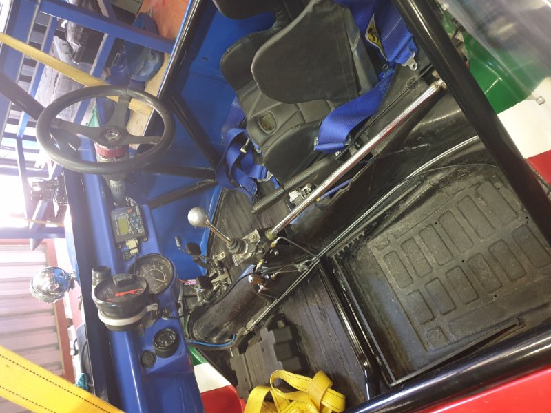

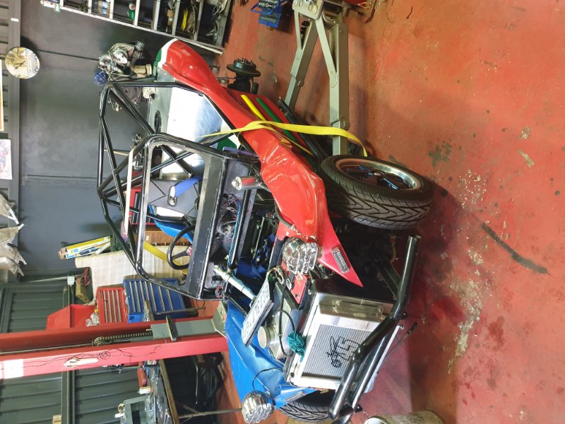

So I managed to Strip 1st gear before I even made it out my Driveway for a road test, on Saturday 27 July.
Had to hustle and replace the 1st gear in the box and get ready to race 28July.
I still had quite a few things to do and test the gear lever. The base was moved and I test drove and did adjustments while the buggy was on the Hoist.
The Saturday night at around 9pm finished and pulled Flagbuggy onto the trailer to race the next day.
Sunday came and I managed to do 4 runs getting valid info.

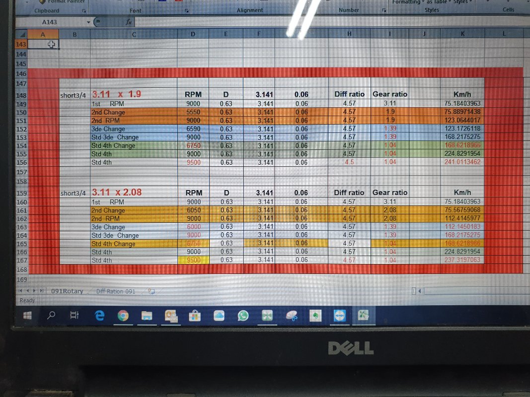

Best and last run was a 12.3 seconds with 190km/h on the return trip I checked boost and had the pedal down. At this point the Splines in the dual clutch setup stripped.
So again got some homework to do

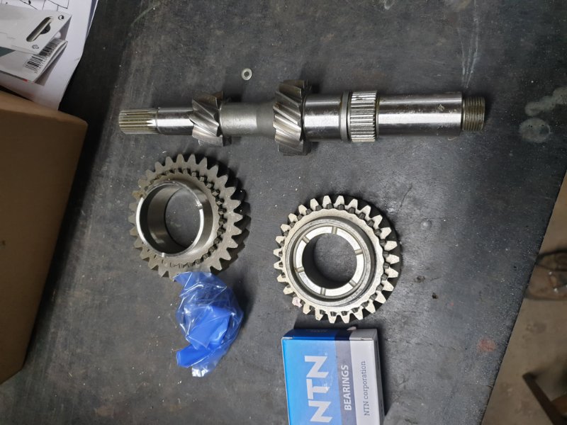

I have ordered a chrome moly main shaft with a longer ratio 1st gear and 2nd gear ratio from the USA that I can launch much harder without fear of stripping 1st gear.
Sent the Clutch plates in for new centers that will be Wire cut to make it fit like a Glove:

By now I installed the Chrome Molly
Mainshaft that exists of 1st and 2nd gear for much harder Launches

Spreadsheet my race number 9

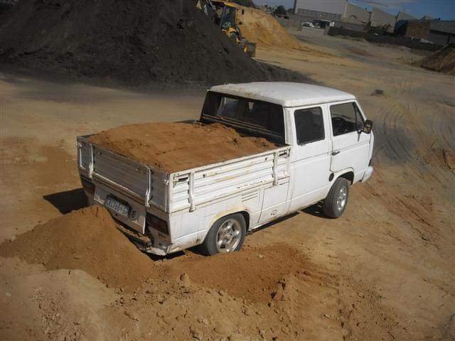

This is Farmtruck way before the Mazda 13Bt Rotary turbo installation
It was my work horse
Loaded 750 bricks with out any.problem and 3 crew
It felt like floating home with that load but never gave up.

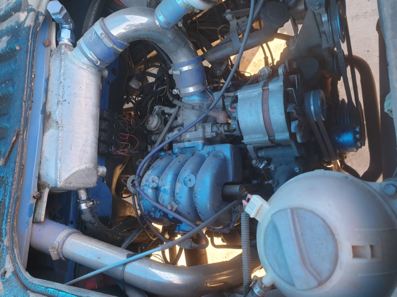

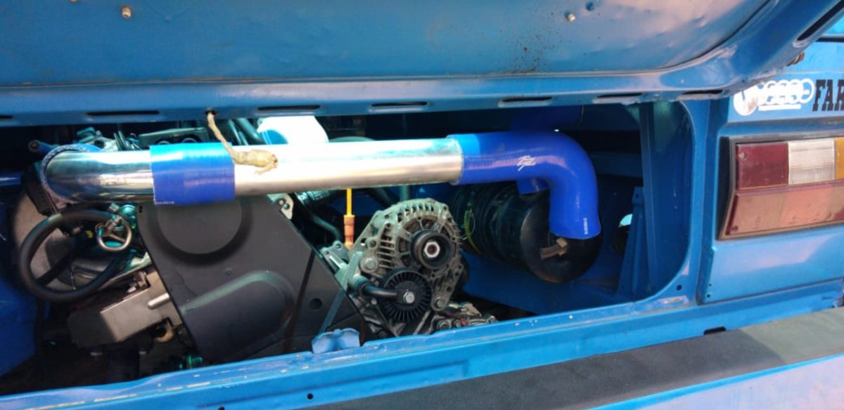

Rotary turbo installed
Charge cooled
900cc injectors
Knight sport turbo upgrade
Small bridge port
Rising rate fuel pressure regulator
Cooper clutch
Semi double diaphragm pressure plate
Microtech ecu
Made 236kw and 400Nm power on the wheels
Gearbox I used a Syncro diff housing center portion for the ability of Vacuum Diff lock
Changer 3de and 4th gears to coarse teeth and welded the helix to gear
4th gear ratio also changed from 0.88 to 0.82 for long legs

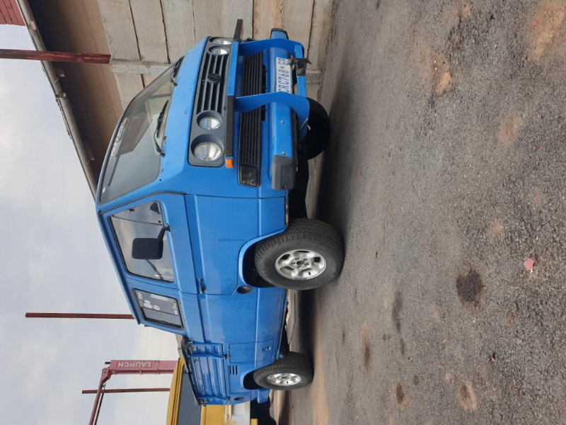

Body was stripped completely and sandblasted
Painted in a nice Vw bus blue color
Has thanked: 71 times
Been thanked: 146 times
Posts: 1082
I'll post some more pics of progress
But the Front Diff and Cvs are installed and Golf Engine and rear Transmission
Had to cut very little on Chassis and make 1 bracket as the chassis differ very slight from Double cab to Microbus

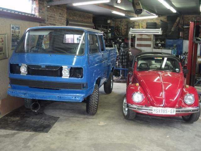

So Syncro conversion making it Full 4x4 is completed with Front and Rear diff lock working off Vacuum
Few small other snags to sort butdriving very nice
Then strip windows and some interior bits to have the rust worms sorted
Luckily more surface rust than major

Another project
My wives cabrio
1 of 14 I built in 2001 for Pick n Pay for their 25th Birthday bash
I'll tell the full story later
