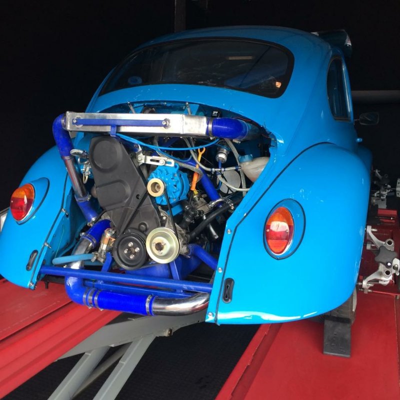

I bought a bug with golf turbo 8v engine
After started getting some work do e on it I stripped the Bug completely as the previ8owner had welded the rear axle nuts on the axle
Rear discs had road rash from wheels that came off
And Alot of stuff I was not going to risk my life trying to go fast on sand
Bug got a full color change with historic racing spec rollcage
Discbrakes all round
Special long ratio transmission with Chrome molly main shaft and chrome molly side shafts
Full engine rebuild new turbo exhaust manifold and Tdo4 turbo

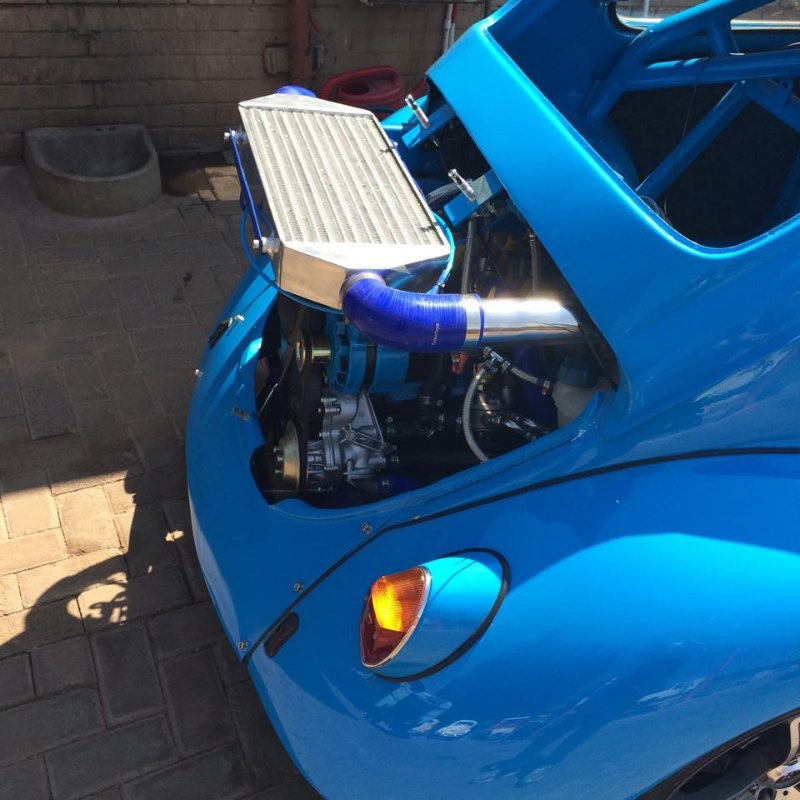

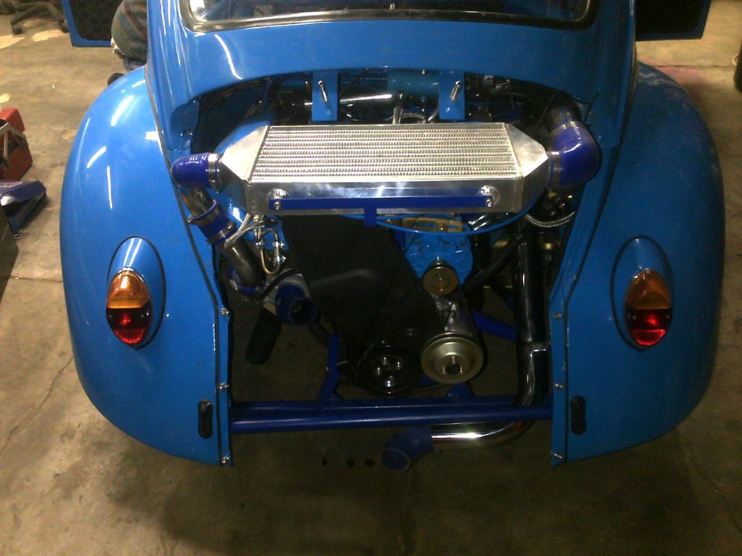

New rear intercooler fitted above the Engine inside the Fiberglass Porsche wing
3 reasons I used the big Porsche wing:
1 - to hide the Golf engine
2 - fit the intercooler
3 - most important have downforce past 160Km/h

So After injectors gave problem and a conrod came out of the Block
I removed the Golf turbo and installed a Mazda Rotary turbo 13B with a Charge cooling system
Been a long term Project but did a few Upgrades since 1st motor installed
My Aim with this bug now is to do a 244Km/h from standing start in 800m
So a tall order but do able as the Hp is more than double from Golf turbo motor
The bug have been on the Dyno with 289Kw on the wheels but upgraded injectors to 4x1200cc and Hybrid turbo so should make a bit more Hp with little bit more boost
